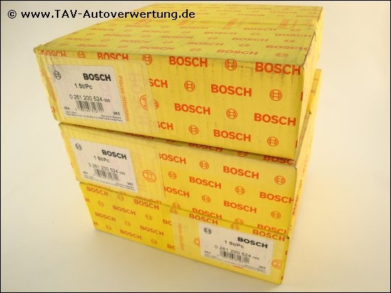

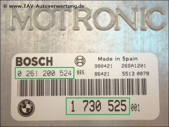

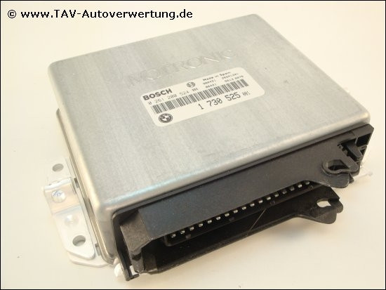

                  BMW sold these replacement 524 DMEs, which don't have Black labels as they were produced recently - older ones were made in W Germany, not in Spain.
