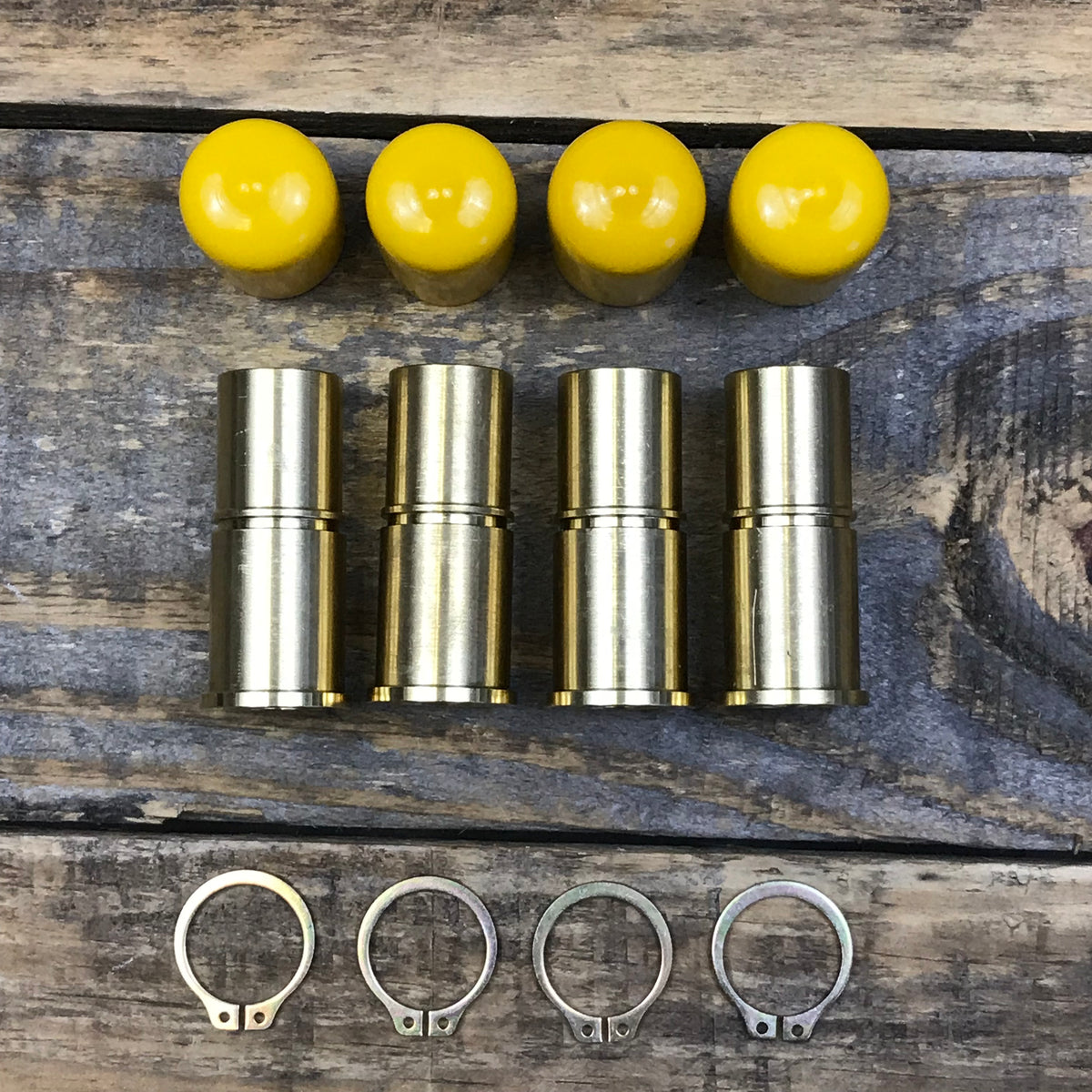

                    I know we used to source the Ate fronts because they slid on a machined pin and you could upgrade the caliper bushings to bronze for more consistent feel. This was for a league where you had to use stock brakes. Can’t remember what years got the better sliders. Not sure if thus is a “cheap” upgrade these days.
                    I see Ate makes caliper replacements for the Girling brackets so make sure you get the sliding pin version.
