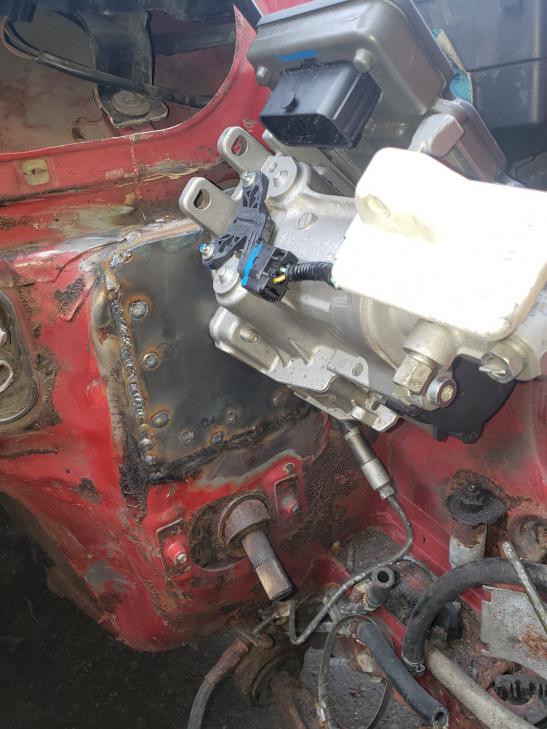

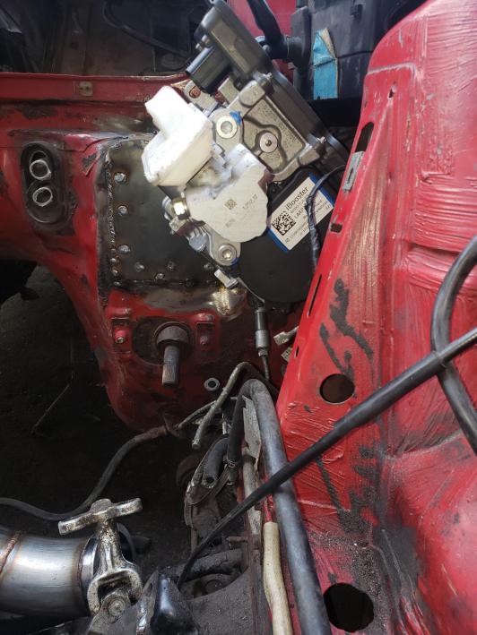

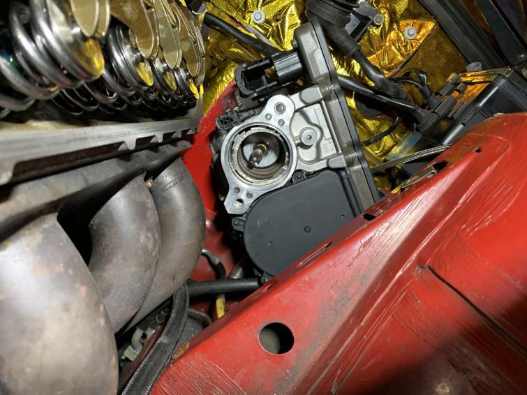

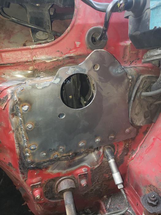

      I used the tesla booster but I removed the mounting flange from the rear. I assume you could do the same with the crv booster but because the crv flange is so thin I dont think youll need to. Heres some photos, I have custom mounts btw so your motor probably sits in a different place.

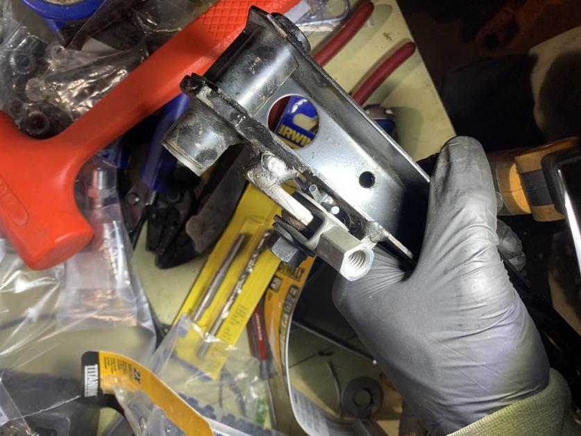

      I also had to modify the brake pedal so that the pushrod wasnt at such a harsh angle, heres a bad photo of that.

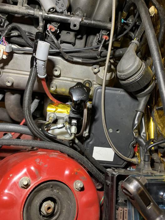

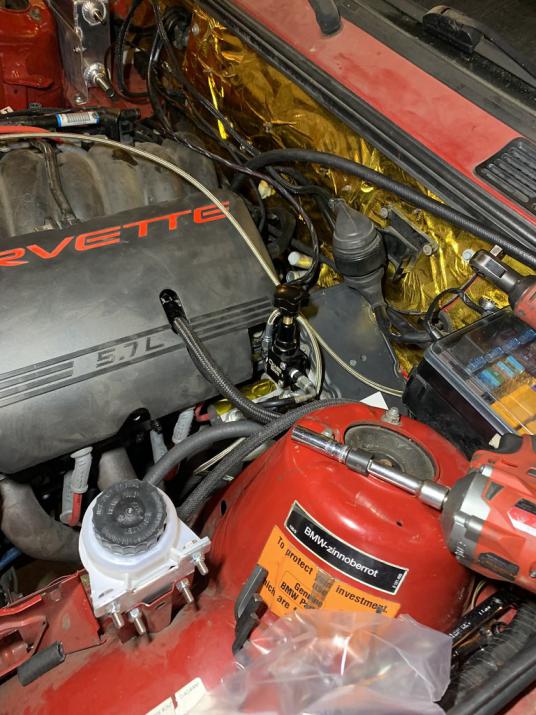

              I got mine mounted. I had to relocate it further inbehind the strut tower; unfortunately my headers don't give me much clearance. I know its not pretty but it will work

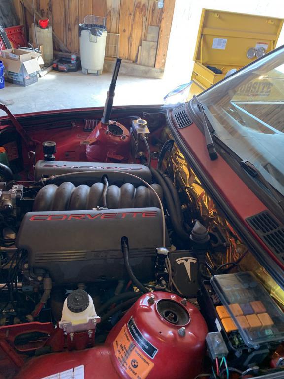

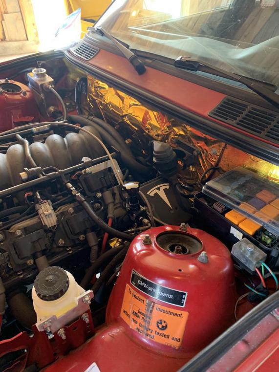

                Just wanted to follow up here, I've put about 600 miles of street driving on my v8 E30 with the Ibooster and I've had no issues. Far less pedal effort than I had with manual brakes. I for sure recommend for anyone looking to go with this booster option. Heres a couple of photos.

                  Looks good. The cool thing about this booster is it can be mounted in basically any orientation with a remote reservoir. is that the one from the CR-V? I like the sticker too, lol.

                      #115
                      The fact that I could tilt it at such an angle was a huge help. It is a Tesla unit with the 4 bolt mounting flange removed so it could get tighter to the firewall. It is still the Tesla MC but with the CRV remote reservoir adapter attached to it. Then I’m using the 2002 auto trans reservoir, one outlet for the brake master one for the clutch. I put the sticker on it to get peoples attention lol.
