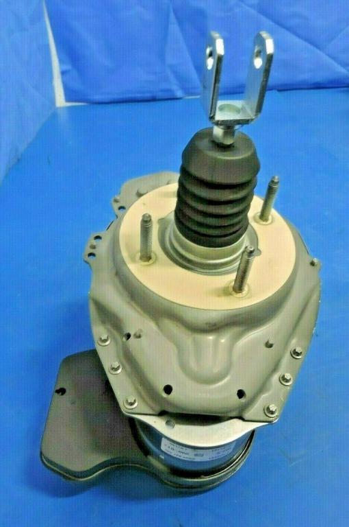

            #35
            You know honestly, the flange isn't that much different on the Model-3 booster. It seems like it would be relatively trivial to move the bolt centerlines less than 3mm over:
            I think the pictures are deceiving too. It looks like the connector sticks out to the side, but I think it goes pretty much straight down. Should easily fit within the huge envelope of the original E30 booster, no?

              #36
              Originally posted by kristov
              Is there any technical documentation on the MC sizes?
              If you dig through enough pictures, you'll see stampings of "25" on them.
              Build thread

                #37
                I want to say I found a RHD photo showing the part number and it was the same as the LHD... it might just be a casting number and it gets a part number when it gets cut one side or the other and assembled with a booster.
                ...a Tesla part number doesn’t do us much good because we can’t order from Tesla.
                I think the model 3 (ibooster gen 2) would absolutely fit anywhere a normal booster would fit. The challenge I have with the n52 intake is extreme, and I don’t think it would fit with that constraint.

                  #38
                  I'm pretty sure in reality it's no wider than the gen-1 booster. It's possibly shorter?
                  I have a line on a Honda booster for a song. I'm having a hard time not buying it on a whim.. there's a Model 3 MC for pretty cheap too. for a RHD booster, you're looking at least $500, plus the connectors. I feel like moving some bolts around at less than half that cost could be worth it?
                  Looking at it again, the ix is kind of oddball, everything is in a different position relative to the RWD E30. I think for sure, the Gen 1 will fit easily. I'm not certain about Gen 2. I think it's a "maybe".
