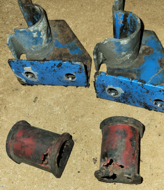

    Was interested to get a little more input on running no rear swaybar. I recently got under the car and saw the rear sway bushings were done and that a PO had put in an original version of the 19mm ST rear sway. The brackets are old and in bad shape.
    So I did some research and found a lot of posts about running no rear sway when you have stiffer springs. No one says what is stiff enough, I'm running H&R sports with Koni's. Not tracking the car but do plan on Turbo. So the question is do I put new bushings on the 19mm? go no sway bar? or just put in an oem smaller bar?
    Click image for larger version  Name:	20230214_202527.jpg Views:	0 Size:	211.5 KB ID:	10084743

          Yep found this post from thejlevie "H&R Sport springs have rates of 180lb/in front and 380lb/in rear. H&R Race springs are 315lb/in front and 570lb/in rear." so yea 380 are considerably softer than the race springs at 570.
          I'm with Panici, want the comfort and performance for an occasional track day, don't care about lap times. So I'm going to repaint those brackets, get new urethane bushings, and bolt the 19mm control arm back up.
