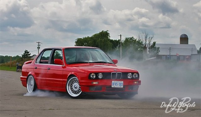

The shop that was selling them was some ebay-in-real-life tuner junk store. I bought the last set for the Sentra:OH really thx god I didn't make it to that deal lol. I was waiting for a replay from you guys for 4 days to make sure they fit on my E30 but I guess I got lucky to not overpaying :S..
Thank you too Mr.Mystikal :D , Could you hook me up with the Toronto guy please? I am from Ottawa , I would love a new set and new tires , if they offer that too.
one more thing sorry lol.. 205/45/17 is good ? can you tell me how your buddy likes those REPS?
Thank you kindly
Just go for ESM reps, I've seen them in person and they are almost identical to these. I know a few shops retail ESM in Toronto, maybe you can find one in Ottawa. 205/45, 205/40, 215/40 are all good sizes.Comment
