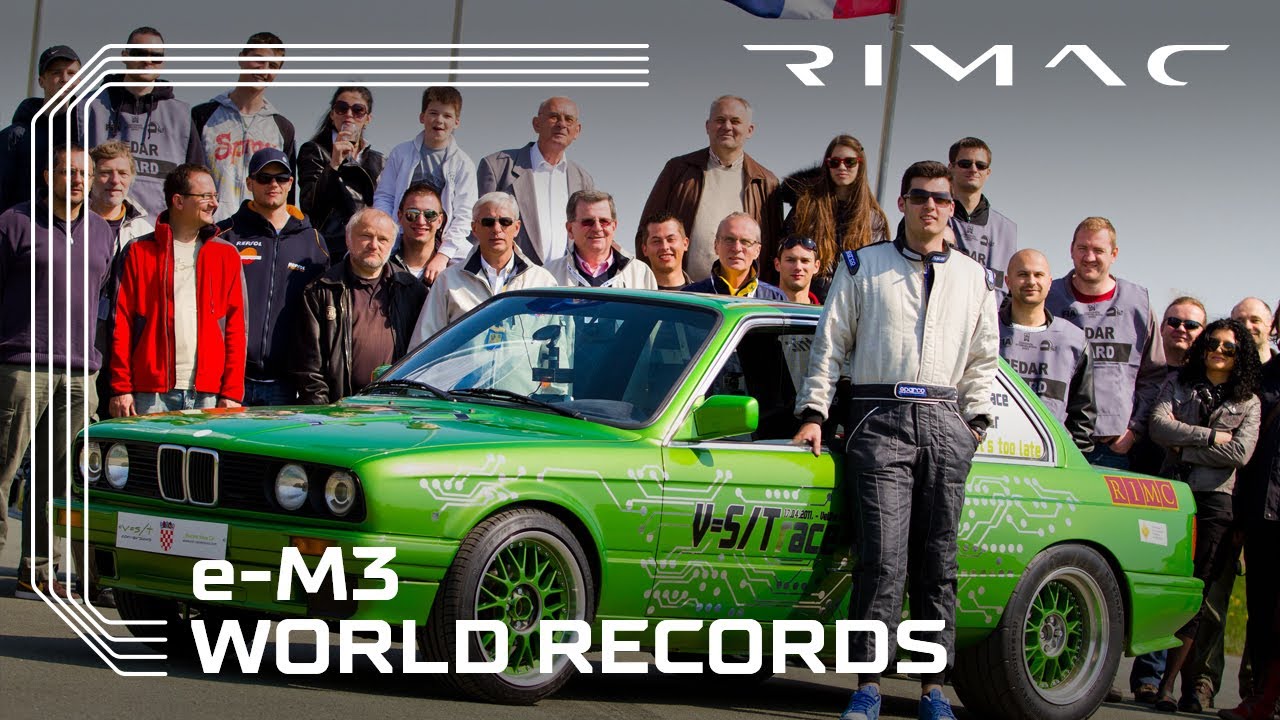

          Mate Rimac (guy who started the supercar EV company, Rimac), started his first build on an e30. Assuming most people already know this, but I love this car, so here's the link....
