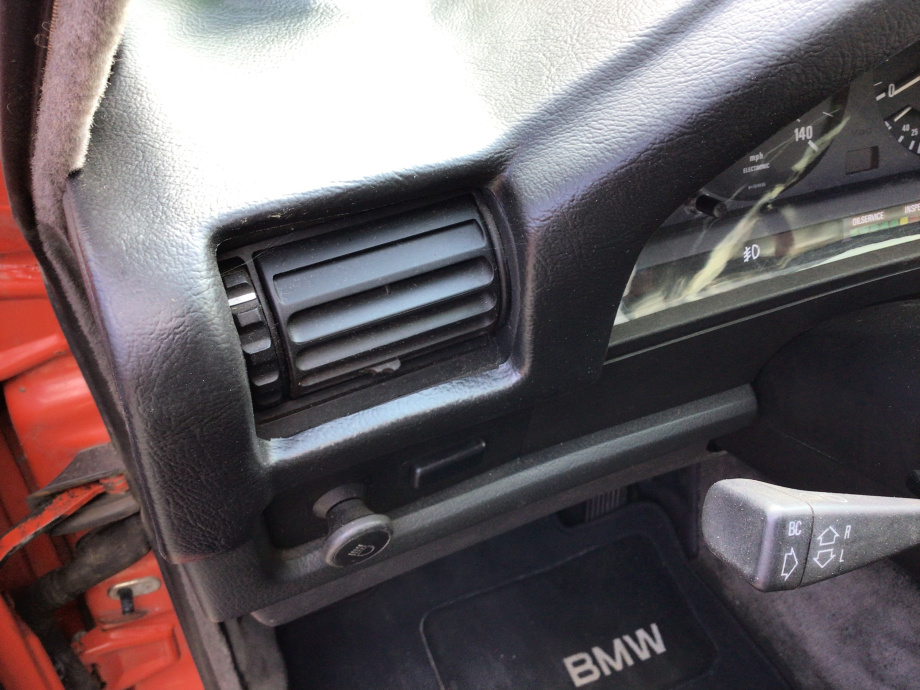

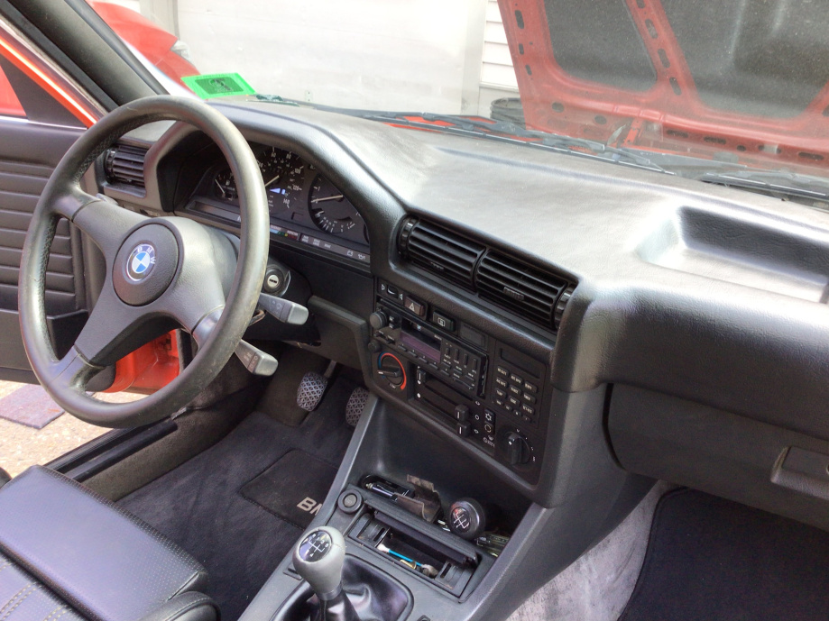

      I have one in my car and prefer it to the multiple cracks in original dash. Click image for larger version
ID:	10093304 Click image for larger version
ID:	10093305 Where it comes up short is how it fits around the side vents. That said I found a crack free dash that I will eventually get around to installing.
