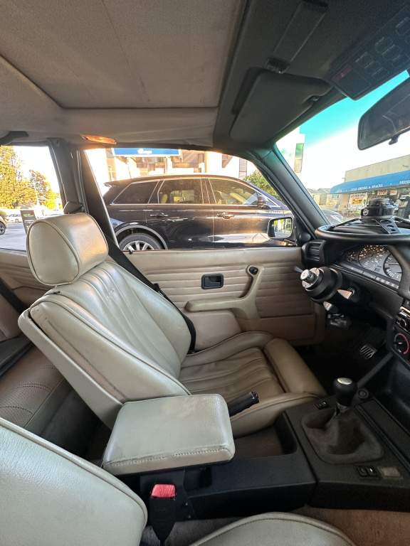

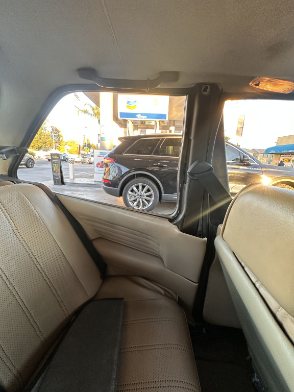

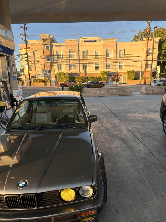

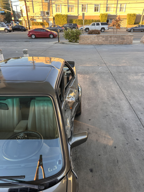

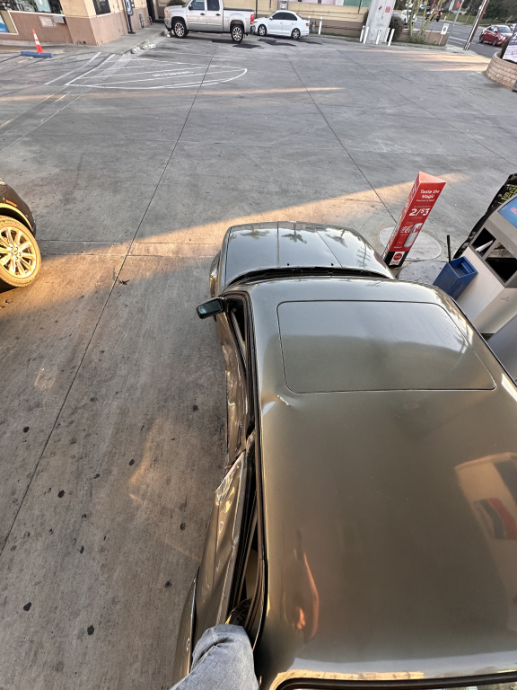

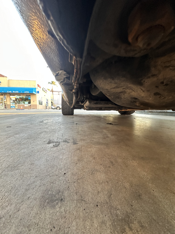

    This morning , I started up my Delphine metallic 1988 E30 325IS , unfortunately some lady in a cayenne ran a red light and completely T boned me on the driver side. The car still drive fine and gets into all the gears fine. The damaged areas are the drivers door , Pilar , rear quarter panel , side skirt and roof has a small dent. I exchanged insurance information with the other drive so that’s all good. My may concern is will this be fixable ? Obviously I’ll need to buy a new door but what about the rear panel and Pilar which are the most damaged? The front fender is perfectly fine. Is there some sort of specialist that you guys would recommend? This E30 is my life and I really don’t want to let go of it , I’ll even drive it around crashed if I have too😅. But please let me know what you guys think , hopefully it’s repairable because I don’t want to get rid of the car and I won’t. I looked underneath and the frame where you jack the car up was perfectly fine , the whole undercarriage looked perfectly fine as id nothing happened. Like I said I can still drive the car , as a matter of fact I drove it home from the accident location, E30 really are little German tanks ! But I will upload more photos of the damage but any opinions or advice would be helpful! Thank you

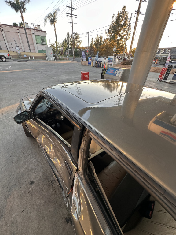

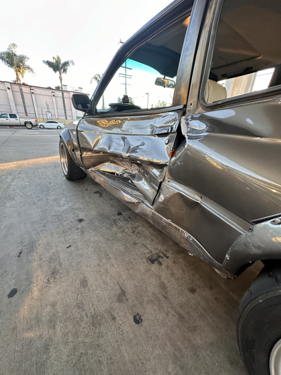

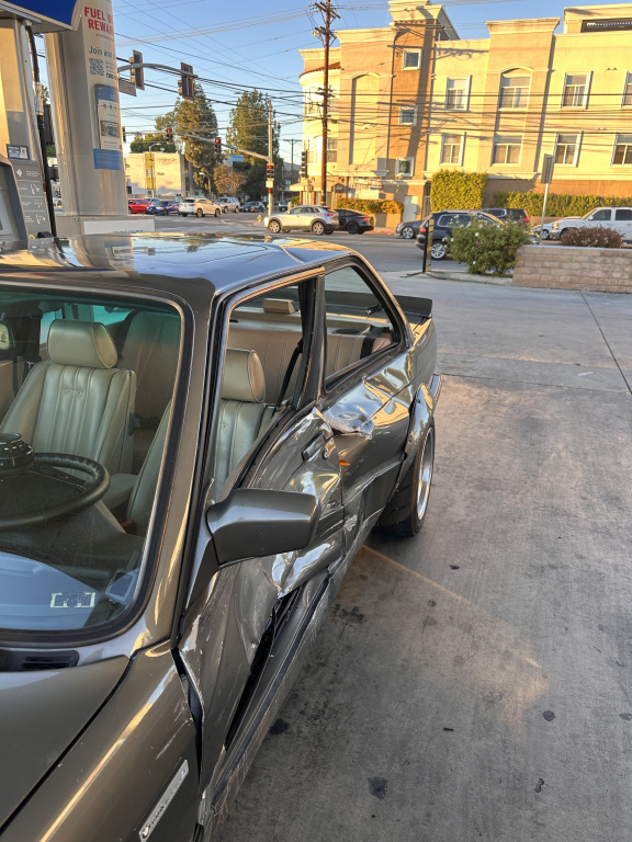

        Well it’s safe to say money isn’t a issue, I’m willing to spend to have it looking like nothing happened, the other lady did have insurance so they should be covering it but this just happened this morning so I’m barely gonna call my lawyer tomorrow to work out the insurance situation. My main concern was that the car would not be repairable but as long as it I’m willing to pay whatever it cost. Here are some photos of the damage. Poor E30 and nice build !
        • Obito22
          • Mar 2023
          • 50
          More photos

                  It depends how much you are attached to e30. On one of my e30 I was hit on the same side like yours. The door and quarter panel plus other parts was hit hard . I had all repaired with new parts.

                    Oof, sorry about your baby! Are you okay after a hit like that?

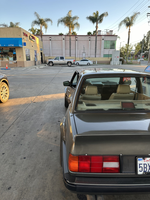

                    How does the trunk fit? Panel gaps?
                    Any creases in the roof or passenger side sheetmetal?
                    If you have these, you can be sure of chassis damage.
                    Just by looking at it from here, I can say the chassis is definitely tweaked.
                    But you'd be surprised what a good frame shop can do. Try to find one with oldschool guys and factory measurements.
                    Start by getting the chassis straight, followed by an alignment that reads out true.
                    Then worry about new body panels.

                          The roof has a small dent , I upload a picture of it ^ but the trunk opens fine but the gap on the crashed side is slightly bigger but on the passenger side there is no dents or anything. I know the I’ll probably have to buy another E30 and just swap everything over , I have a full built engine stroked to a 2.7 with a full suspension upgrade, it’s a street legal track car but the Delphine metallic is the original paint and both the welds on the front fenders are in tact meaning they have never been removed before. The car is in good condition and it really means something to me but how hard will it be to find another Delphine coupe ??

                              Like the others said, you can repair anything but that car is totaled. Insurance will not give you want it costs to fix. I had the same accident on the passenger side. Hagerty is only reason I got what I thought was a fair payoff.
                              Looks like b pillar is screwed. Just by eyeballing and previous experience, that's 16-17k of damage.
