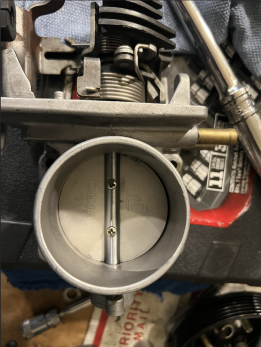

    I bought a "like new" BBTB from an unscrupulous eBay seller. I asked Dinan for help fixing it, they said call a local seller. I called several, all said they don't offer parts, sorry.
    The issue seems to be the flap does not fully close (light is visible through it)
    I offered to send the non functional one AND a core AND to pay to either get it fixed or get a new one, nope, just buy a new one for 700 plus shipping & tax.
    I'll be avoiding them and their products going forward.

    Can you adjust the flap location?
    • moatilliatta
      • 6152
      Loosen tension of the butterfly screws and see if the butterfly needs recentered. If it is centered check the throttle stop.

        I have moved, adjusted, removed & repositioned over & over. It will not seal. I love throwing 500 bucks away lol
        The stop is 1/8th" away from touching the screw.

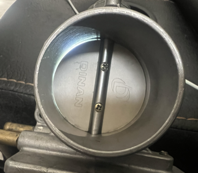

              Here is the best (least light) I can get turned around.

              • twright
                • 707
                Is the diameter of the butterfly too small? Or is it not perpendicular in the bore of the throttle body?

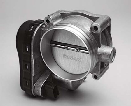

                            stock e36 throttle body
                            e36 dinan throttle body
                            the 2 don't look anything alike. i'm guessing you have a stock throttle body with a dinan butterfly valve.

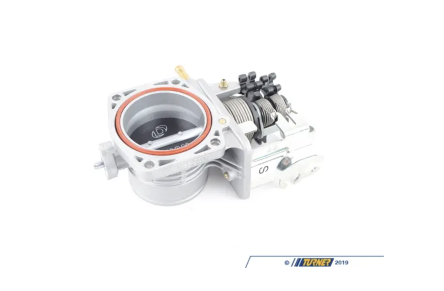

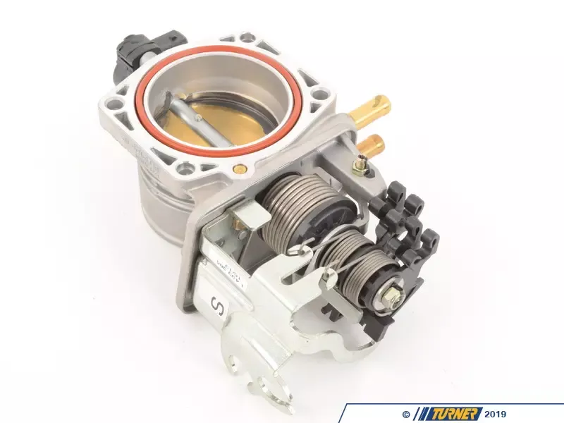

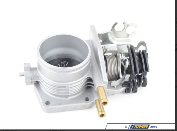

                              https://www.turnermotorsport.com/p-401183-high-flow-throttle-body-1996-1998/?gad_source=4&gclid=EAIaIQobChMI4_K6tdOahQMVLhCtBh 1aUQKiEAQYDSABEgIauPD_BwE
                              Click image for larger version  Name:	Screenshot 2024-03-29 at 4.45.22 PM.png Views:	0 Size:	223.9 KB ID:	10117408
                              Click image for larger version  Name:	Screenshot 2024-03-29 at 4.45.06 PM.png Views:	0 Size:	155.3 KB ID:	10117410
