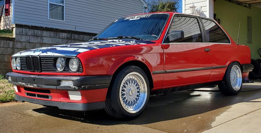

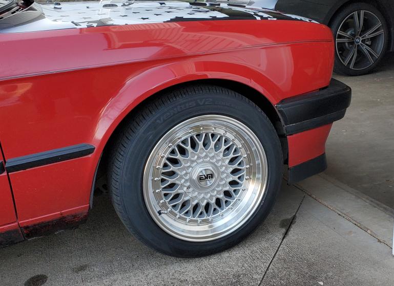

      So the wheels I ordered came in. I like them for what they are. They are not to bad for reps. Click image for larger version  Name:	20220312_180759.jpg Views:	0 Size:	81.9 KB ID:	10049552 Click image for larger version  Name:	20220312_180818.jpg Views:	0 Size:	72.8 KB ID:	10049553 Click image for larger version  Name:	20220312_180831.jpg Views:	0 Size:	84.0 KB ID:	10049554

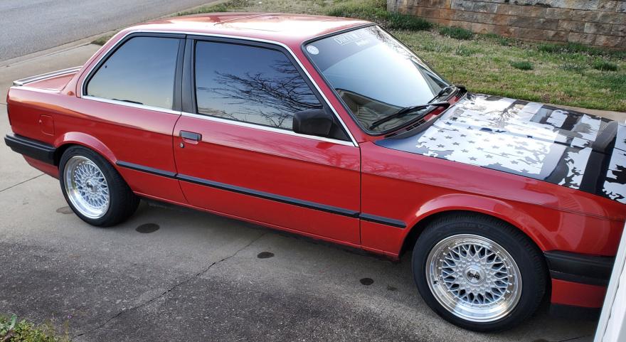

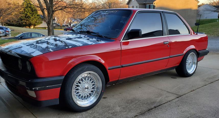

        Took some better pictures today. Crazy how set of wheels can transform the look of a car.
        Click image for larger version  Name:	20220314_162938.jpg Views:	46 Size:	82.2 KB ID:	10049711 Click image for larger version  Name:	20220314_162920.jpg Views:	42 Size:	77.1 KB ID:	10049712

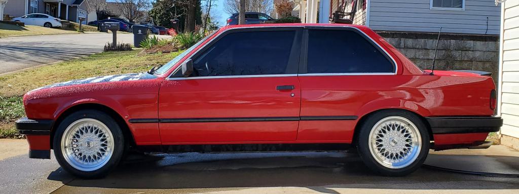

          So I finally got around to fixing my exhaust tips or more or less the axle back. It's not 100% perfect the whole exhaust really could use a overhauling. But for now it's not bad.
          Click image for larger version  Name:	20220319_122222.jpg Views:	288 Size:	43.0 KB ID:	10050406
          Click image for larger version  Name:	20220320_122550.jpg Views:	305 Size:	75.8 KB ID:	10050405
