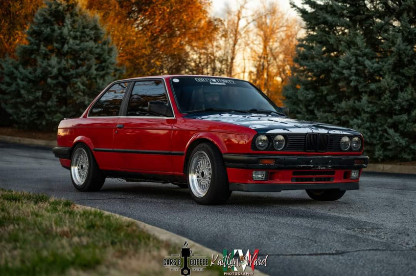

        Went to my local Cars and Coffee and someone took a picture of me coming in.
        Click image for larger version  Name:	FB_IMG_1656270664288.jpg Views:	0 Size:	76.2 KB ID:	10059896

                          Here are a few picks from a local Cars and Coffee that I go to.
ID:	10085079 Click image for larger version
ID:	10085080 Click image for larger version
ID:	10085081 Click image for larger version
