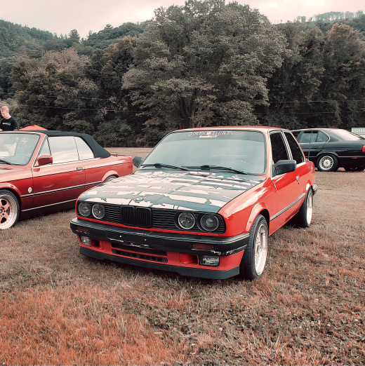

                          #57
                          The car is finally back together. Drove it to The Vintage this past Saturday. So far so good.

                            Was going to chat, I got tied up looking around, cool seeing your car at The Vintage!

                              Always next year. I had a great time. I was tied up as well
