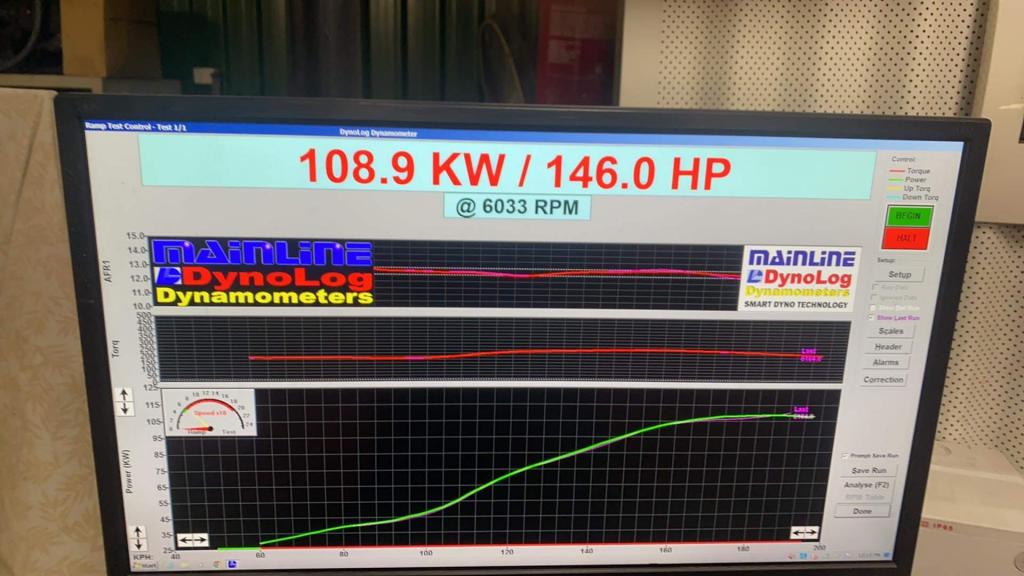

  • Patto
    • Jul 2020
    • 20
    results are in
    Head - Bimmerheads SS885:
    Valves ground
    Valve seat ground
    New valve guides
    New valve seals & cam seals
    New intake studs & exhaust studs
    Dual valve springs
    Heavy Duty Rockers
    Ported & polished
    Schrick 280/274 Camshaft
    Nuke Adjustable Cam Gear
    Nuke fuel rail
    ARP Head studs
    MLS head gasket
    Gates timing belt n pulley
    New OEM water and oil pumps
    MRT cam trigger plate
    Exhaust
    Hartge H23 Alpina style headers
    Twin 2" collectors into
    Redback 2.5" high flow cat
    Remus rear muffler
    Bottom End - 1990 325i Block
    Acid bathed. New sleeves.
    325i crank & rods balanced and polished
    84.5mm Mahle Ultimate 325i pistons (0.5mm overbore 8.8:1 for future boost)
    ACL trimetal rod and main bearings.
    ARP bolts throughout
    Cooling
    Alloy radiator
    325i oil cooler with 10AN lines. Heat sleeved.
    Driveline
    RHD Chromoly lightened flywheel
    Stage 2 sports clutch and plate
    Z3 short shift and throw kit
    Garagistic DSSR and billet knuckle
    Hillside reinforced engine crossmember
    Hillside reinforced rear subframe
    Hillside reinforced trailing arms
    Poly bushes throughout
    Koni shocks
    Whiteline sway bar and strut brace
    Engine management.
    Haltech Elite 1500
    Haltech WB1 wideband controller and sensor
    Turbosmart FPR1200
    Haltech oil pressure sender
    Haltech ic7 dash cluster
    Mako dash insert
    LS1 coils firewall battery tray mounted
    LS1 style Bosch Iridium plugs
    Custom leads
    Assorted Bosch & Syltech pressure and temp sensors
    M50 TPS with delrin adapter plate
    M54 cam trigger

    Seems a bit low to me.

      Is what it is. Low comp. Stock fuel system injectors and intake for now. I'm sure we'll see significant increases when it's flex fueled and turbocharged

              Did you dyno it stock for a baseline?
              • It's Soda Not Pop
                • Jan 2022
                • 877
                Was this a base map with zero tuning? Or did you have it tuned for all the mods?
                88' Seta 2.7i Zinno
                https://www.r3vlimited.com/board/for...430-my-88-seta
                • lukeADE335i
                  • Apr 2013
                  • 1389
                  Those Dynolog dynos are known heart breakers though - they read pretty low vs. others.
                  Here's my M30B35 run from the same brand of dyno - 124kW at the wheels. On the same day a stock 325i put down 101kW, M42 powered cars were in the 80s.

                    Yeah without results from a stock car on the same dyno it's hard to tell what the result means, what it will show is the difference in delivery between NA and turbo. If you're putting an aftermarket rail and FPR on it you must have lofty goals, I look forward to seeing the results. It bugs me when the dyno operator doesn't put the inductive sensor on a plug wire or input the gearing and tire size to get engine RPM on the X axis instead of wheel speed...

                      that's perhaps a bit low but for actual power mods it reads basically like a fresh stock CR b25 with a cam and exhaust so wouldn't expect much in the way of NA power
                      i do have some mainline results on other bmws filed somewhere that might be useful for reference.
