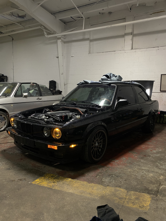

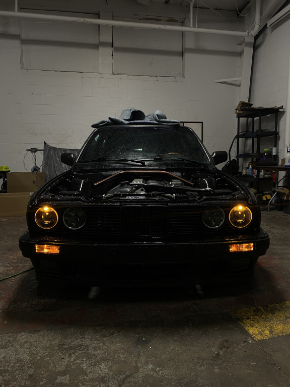

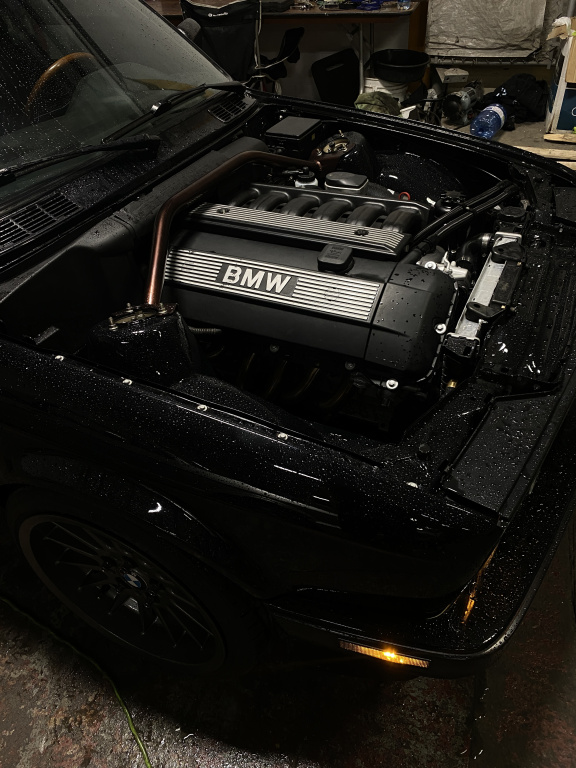

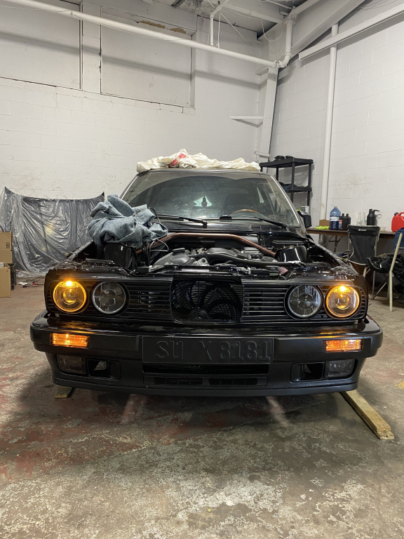

    Gotta love amber lights on a euro car

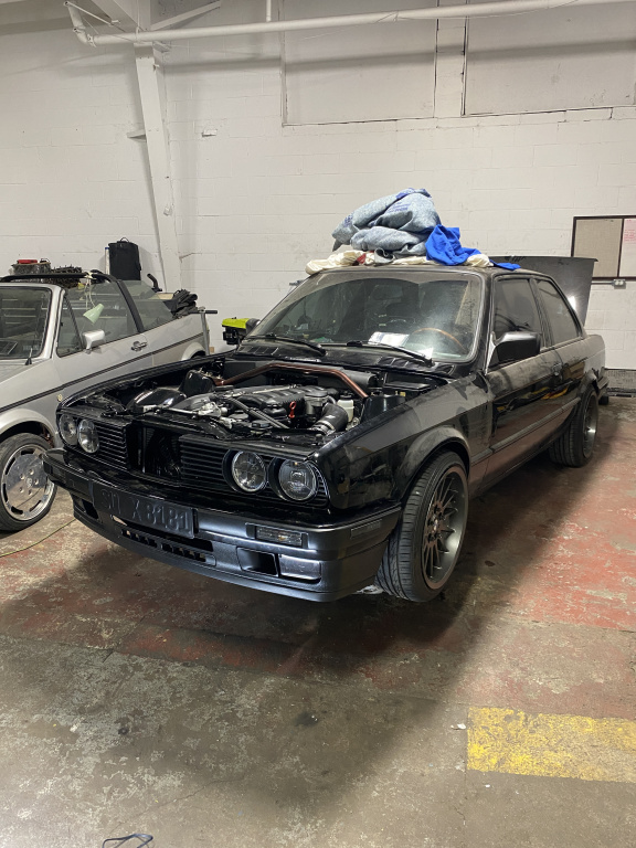

    Fenders are finally back on! Looks like a car again!

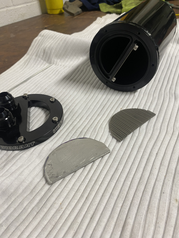

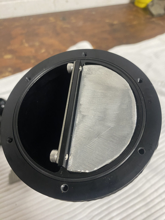

    Realized later on that my catch can is an open loop, so because it was venting to atmosphere and returning in the intake after the MAF sensor, this would cause an issue
    So i made a block off plate for the vent so it becomes closed loop
    Block-off plate installed

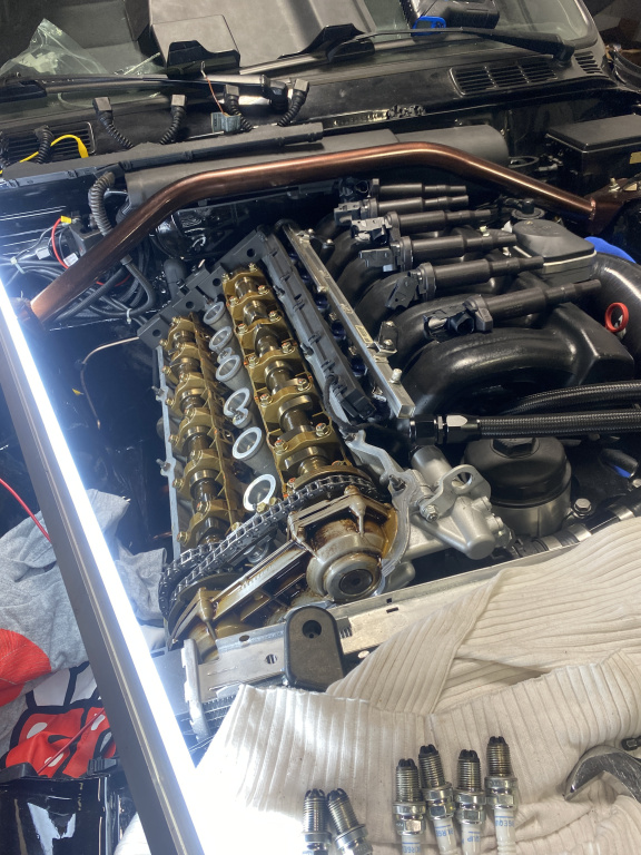

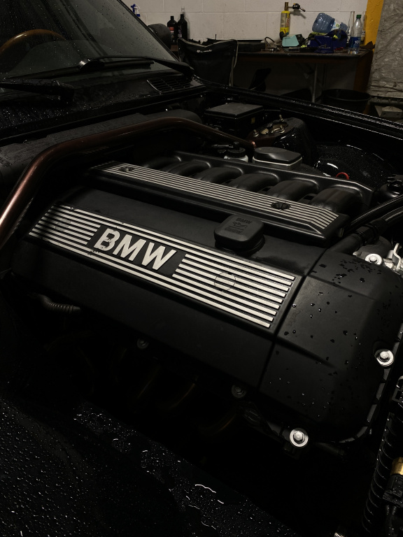

      After 2 weeks of trying to deal with a rattling noise in the motor, and not being able to figure it out,
      I got help from an older man that has tons of experience with motors and he told me in 15 seconds that the timing was off
      We took of the VC checked timing with the tools and somehow after veryfing timing 5 times, something moved and it was off
      Didn't waste any time and took it apart to resolve this. Redid the procedure and boom no more noise
      Got lucky nothing touched in the motor

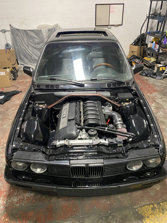

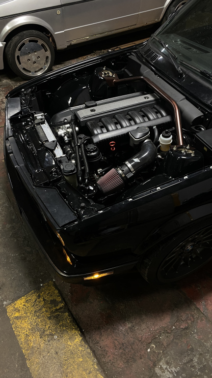

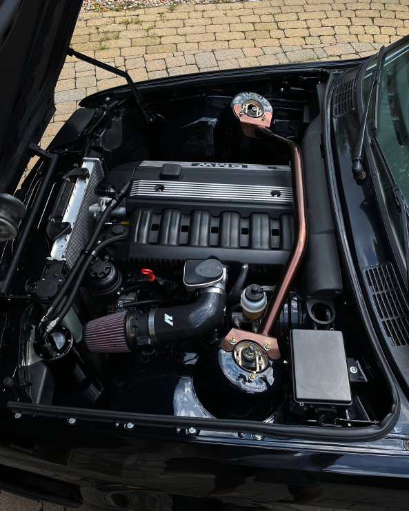

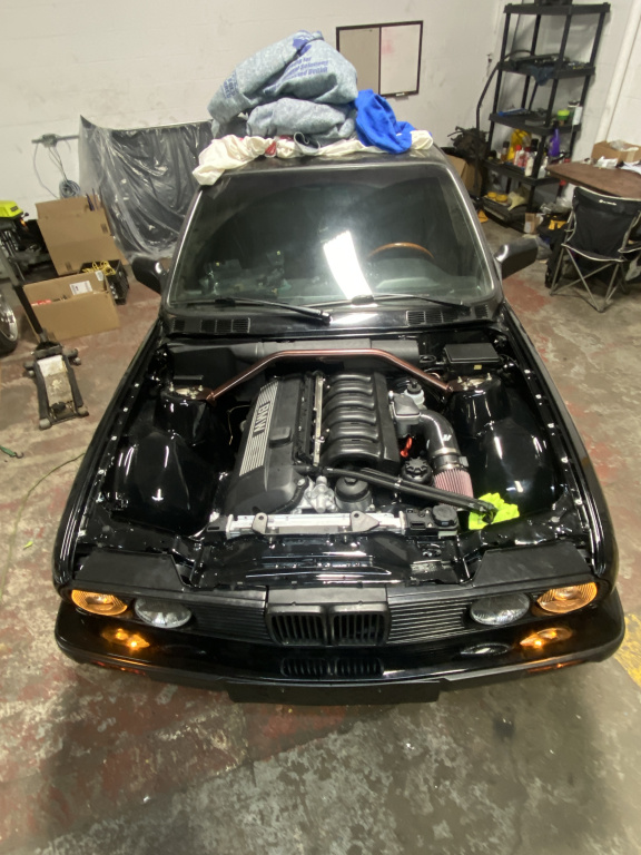

      Final engine bay look! LOVE it

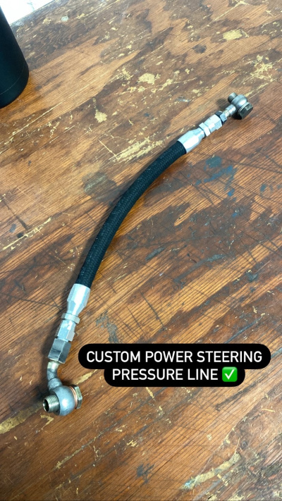

      Had a custom PS pump line made from the Z3 rack

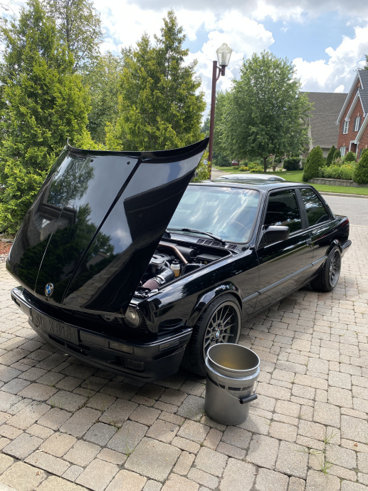

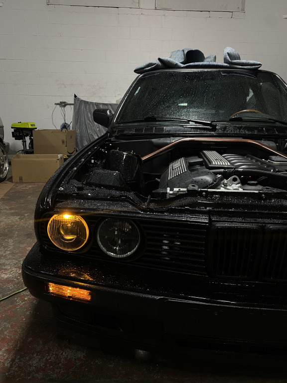

      Was time for a rinse, tired of looking at a dusty engine bay

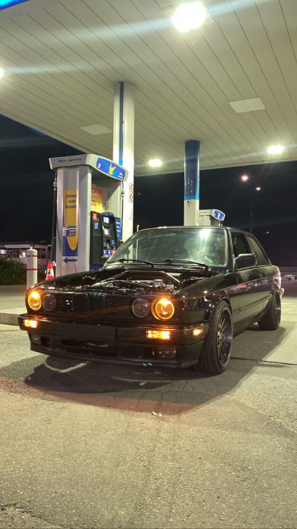

          First Drive to the gas station to fill her up!
          No better feeling

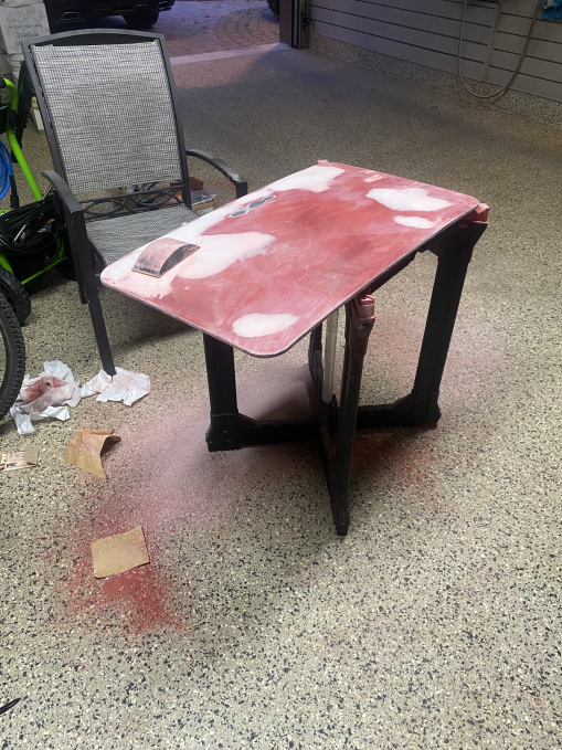

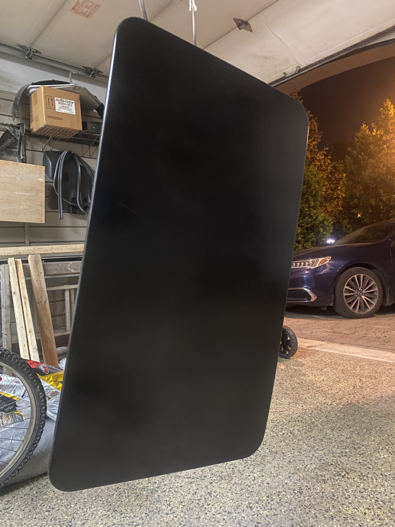

          So long story short, my sunroof has caused problems forever
          I avoided opening it for a while. We were bored at the shop and decided to open it, then it jammed
          Took it apart to find the brackets rusted out and broke off.
          I've had this rust free replacement for years but was waiting to paint a few parts together
          After this winter, budget is all used up so just painting this temporarily before sending it to bodyshop\

          Primed, not perfect
          Ran out of paint, but at this point the car needed to drive ASAP and it was raining every day

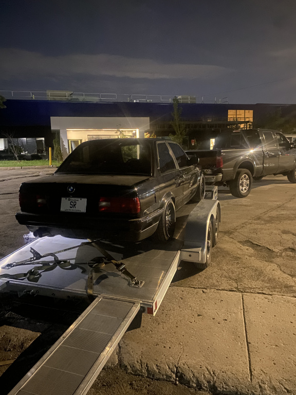

            FINALLY time to take her home after 7.5 months driving 45kms to the shop every time I wanted to work on it

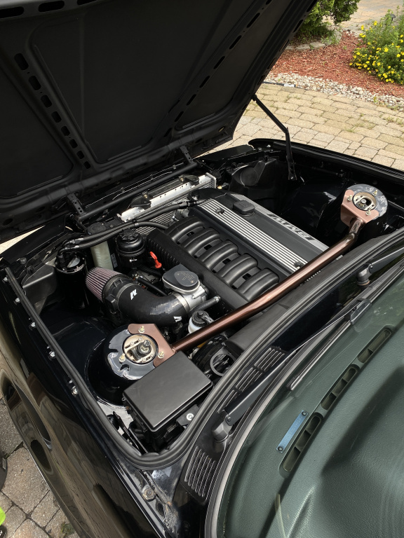

            This bay looks soooo good all cleaned up!
