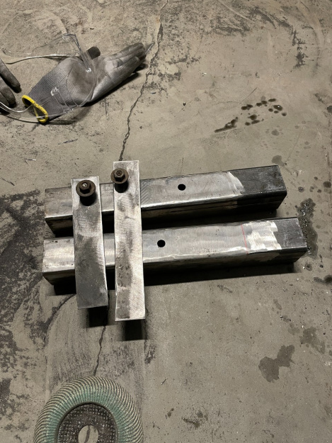

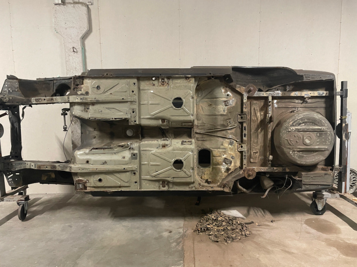

    I managed to find a bodi rotisserie. It was made for Lada cars, but made some small modifications and voila! Welded wheels so i can move it around if need to.
    Oh sh*t, it works! :D

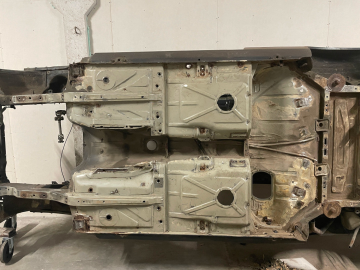

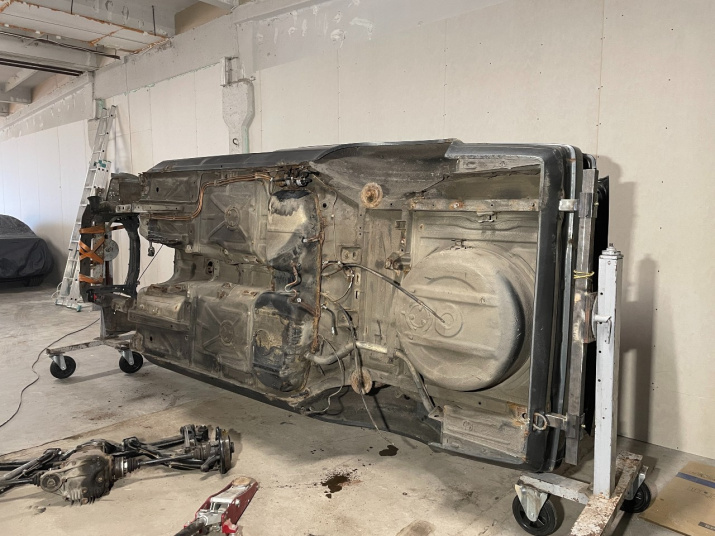

      #62

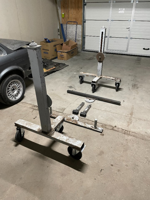

      Front axle removed, again. Also rear axle came off.
      Click image for larger version  Name:	esisild.jpg Views:	0 Size:	187.4 KB ID:	10085854
      Click image for larger version  Name:	tagasild.jpg Views:	0 Size:	166.1 KB ID:	10085855
      And turned the on its side. Rotator or body grille or whatever you want to call it makes working so much easier.
      Click image for larger version  Name:	kere_kylili.jpg Views:	0 Size:	172.5 KB ID:	10085856

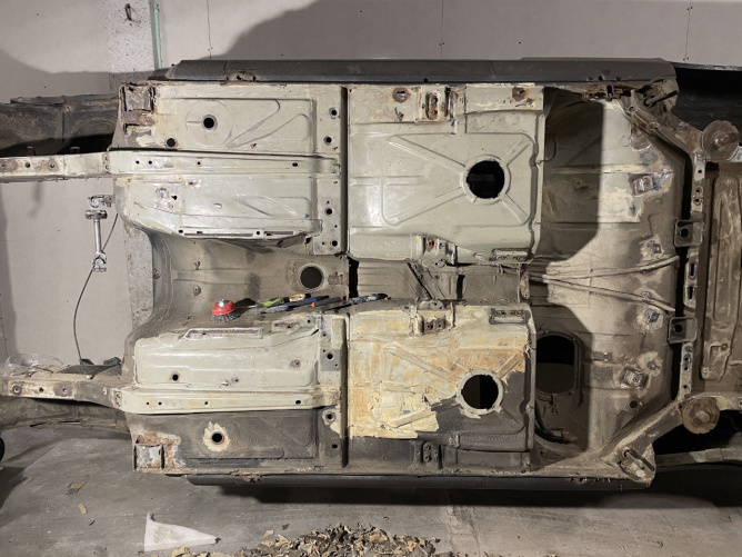

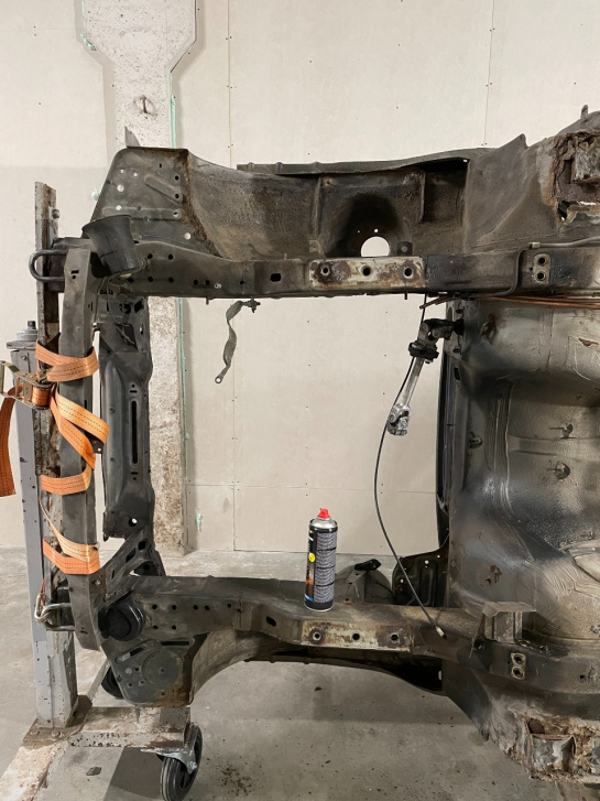

      Now we can see it from underneath. Not a beautiful picture to be honest. I hoped little bit less rust. This is just the beginning because if i remove the uderseal there will be lots of more ungly surpises im sure of it.

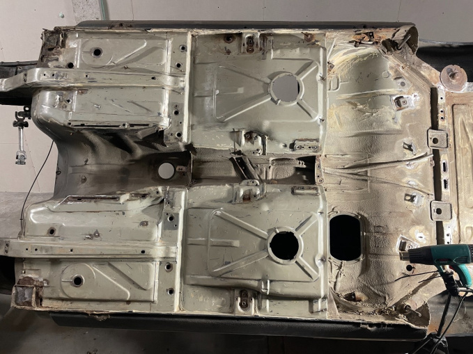

          Cleaned few spots using angle grinder and wirebrush. I realized that i probably have to get rid of the whole underseal of the body. Then im able to see how bad things actually are.

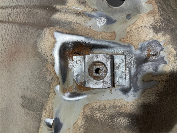

          When removing the sound deading from the inside i already felt pretty happy because petrol tank attachment points were rust free. After a wirebrush things turn out to be quite different. I have had few E30s in the past and all of them i had to cut the attachment points aout and weld new onse. This one is no exception.

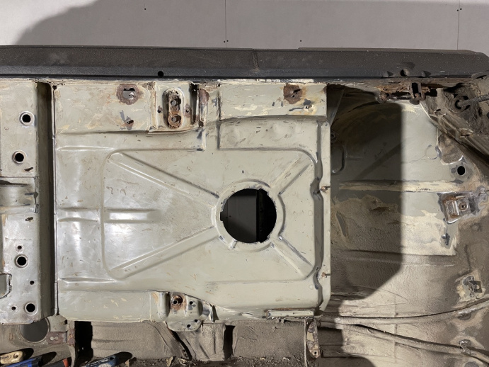

            And there is nothing else to do than start the scraping fiesta. What else i found out that holding a heatgun in one hand and trying to clean the underseal with other is quite a challange. So my little Magyver came to help. I had one extra tripod in the garage, so i ziptied it to the tripod. Its like handsfree version. :D
