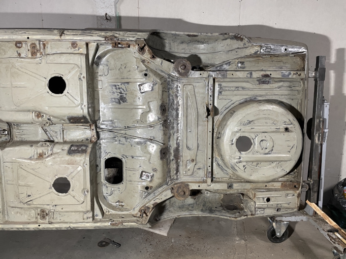

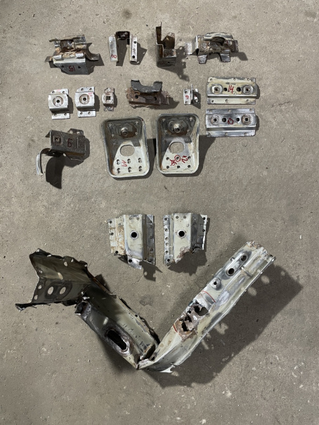

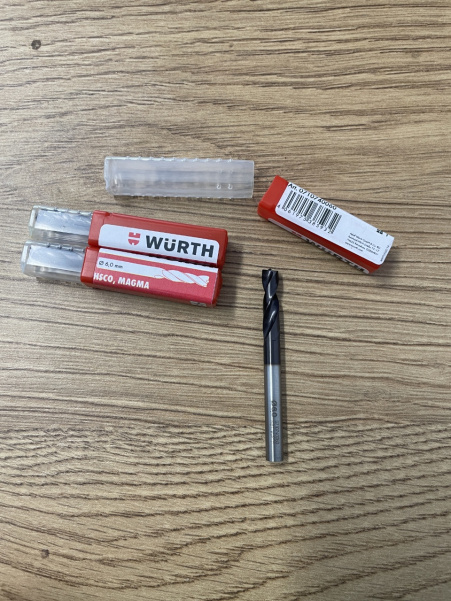

                    I had a chat with the guy whos gonna do the welding on my car and decided i will remove most of the brackets from the body. It will be much easier to clean and also less time spent by the welder. And i want to educate myself so i went to the shop and bought special drill bits for the spot welding. I hope i don't f*ck it up! :D

                      FWIW, I didn't use a spot welder drill bit when I removed my engine bay brackets.
                      Just carefully used a grinder with a cutoff wheel to trim down the brackets to the sheetmetal.
                      Didn't even use any filler before painting on version 1 and it looked pretty good (but not perfect).

                            Just got home from garage. 10+ hours spent and i am exhausted! Würth drill bits was well spent money. Rear section of the car is bracket free. Kept the differential bracket because i didn't have any small tool to cut through the weld. Also rear seatbelt subframe was pretty bad after seatbelt brackets removed. So i decided not to reuse it and threw it to scrap. Now i have to find new one. I was able to find one place where i could buy that subframe but i try to find something cheaper maybe.

                              Cleaning the bottom is hellish work - I know from my experience. But also drilling all the brackets is already a super approach. I didn't dare to do that. Just sandblasted the body...

                                Hellish is a pretty polite way to put it. There were times when i wanted to burn that s*it. But finally managed to finish it. 19th of January 2023 i attached the chassis to a body rotisserie. Then i started to remove the axels and all the fuel and brake lines. First time i showed wire bursh to it was 22nd of January. It took me 8 days, which means 4 weekends to get where i am now. Not bad actually. It felt like forever. I also spoke with the bodyshop yesterday and we agreed to take the car there in the end of this month or in the beginning of June. I hope i can get my license done before that. I dont know about other countries, but in Estonia if you want to tow a car on a trailer you need an extra class for that and its E-class in our country.
                                Drilling was quite easy part but took some time to get used to it and your eye trying to find the spotwelds. I could probably drill the whole body apart, but next destination will be scrapyard and not a bodyshop. My friend would tell me to piss off with the trailer full of bodyparts. So im gonna keep it like this and let him do the work from now on.
                                When all the brackets removed i inspected them and realized that few of them needs some fixing before i can weld them back. But then i remembered to check the bmwfans.info page just in case if they are available any more ? I took the product codes and sent them to the dealership. You know what ? After i got the list of prices i buried any idea to restore them. All the exhaust rubber mounting brackets cost for me less than 30 euros. Im not gonna think twice.
