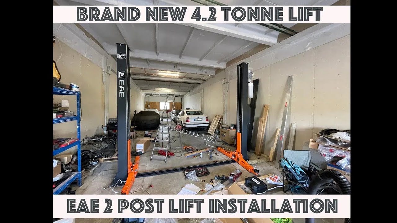

    The elevator is very good. Too bad I have a garage in the basement so the ceiling is low enough for that.
    You were rightly told about 28 days, it is during this period that concrete reaches its calculated strength. But I didn't understand why you didn't immediately make out of concrete the studs for mounting the lift? It would be easier and stronger than drilling concrete and setting anchors now.​
      Low ceiling solution is scissor lift.For example: scissor lift
      Actually i did think about it, but everything happened so fast and didn't have the time to get the studs. But i'm not worried because those anchors will hold the lifts in place for sure. If i remember there is 6 anchors per one post and diameter is 10-12mm and lenght i haven't thought about it yet.

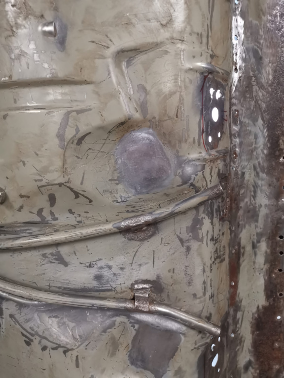

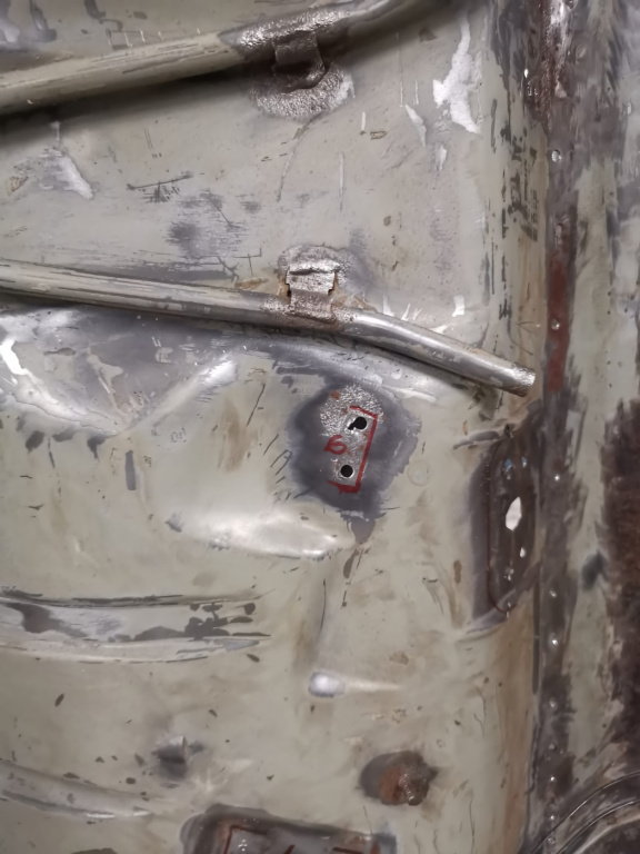

        Finally i have some updates. My friend decided that midsummer party is over, time to get sober and start to weld my E30. :D There is not much done, but small steps takes you to the destination you want. For me the time doesn't matter, but the quality of the final product what matters. Everything has to be done good and properly.
        Rear brake hose attachment bracket points.

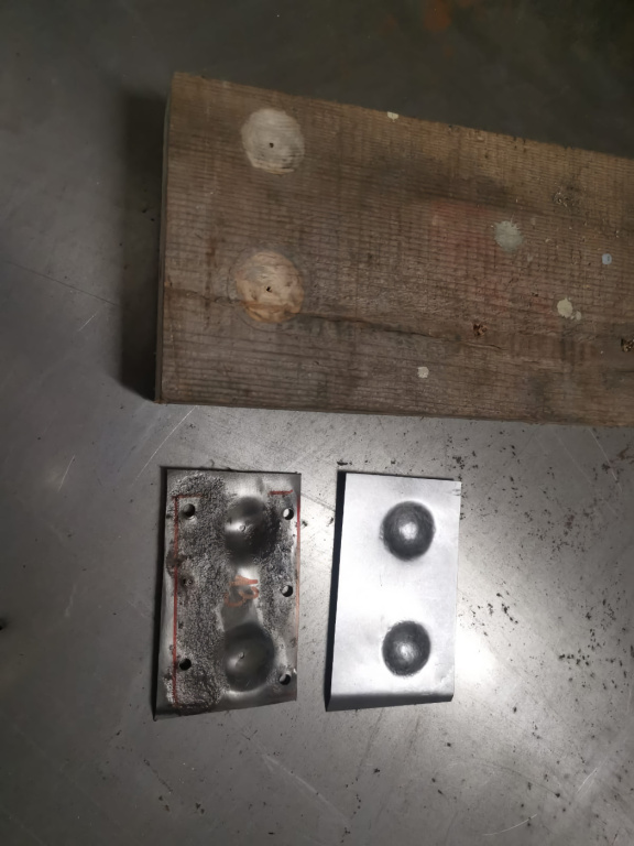

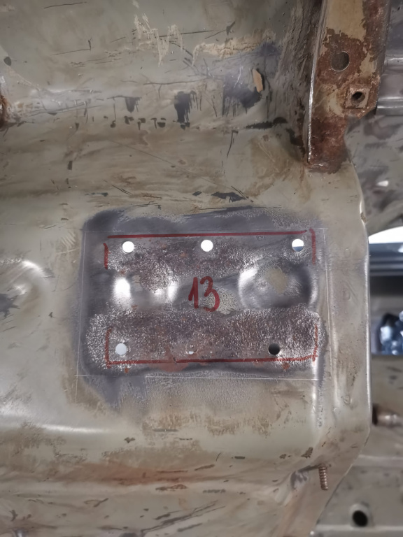

        Rear heatshield attachment points.
        Before.
        When you are good with metal and hammer and make the metal pieces you need by yourself.

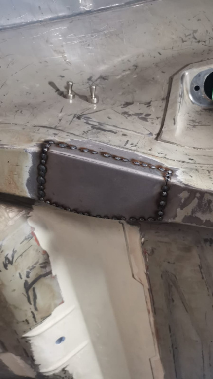

        And one done!

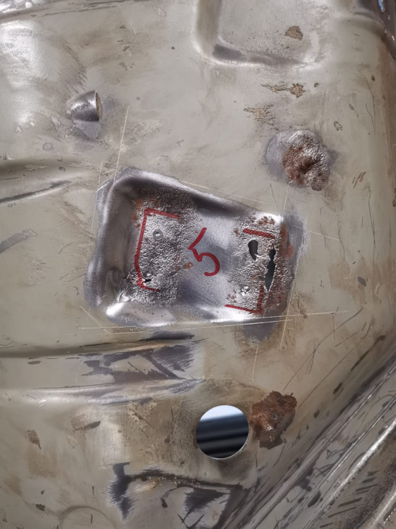

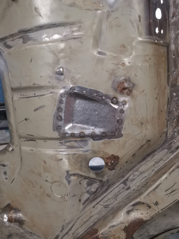

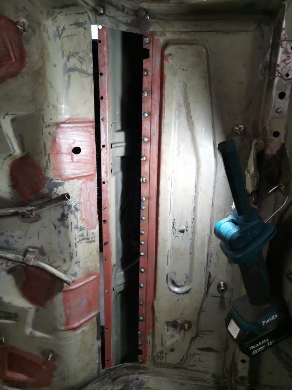

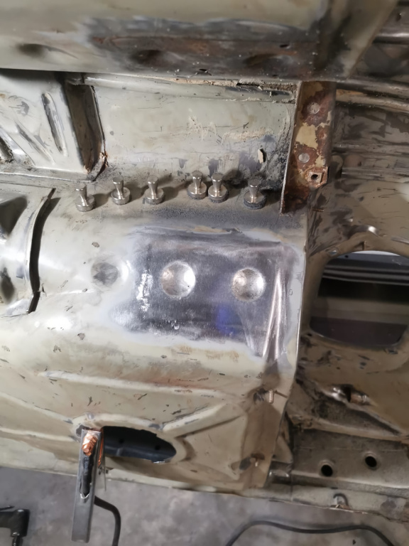

          Small update. I have owned many E30 in the past and every one had the same rust problem and had to deal with it. This project is not an exception. Fuel tank/petrol tank attachment points were pretty bad looking and needed to fix them.
          How it looked before.​

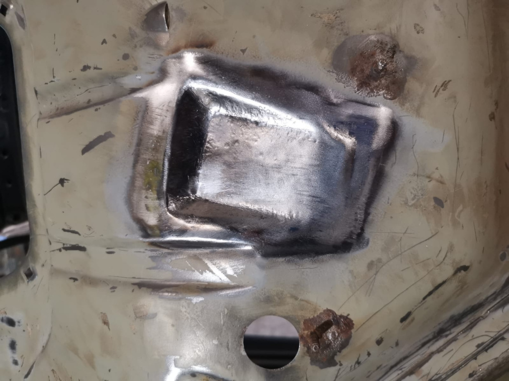

          In progress.
          Ready for welding.
          And boom.

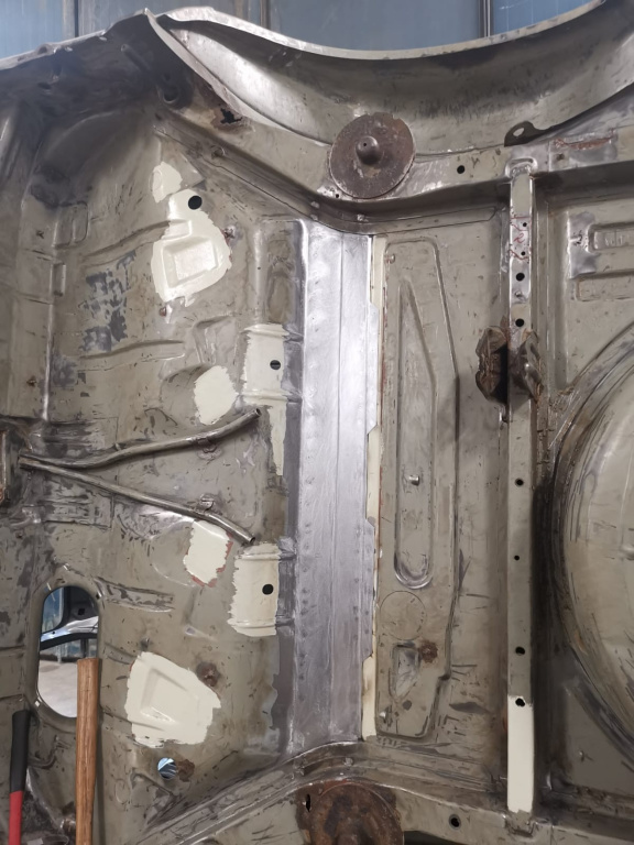

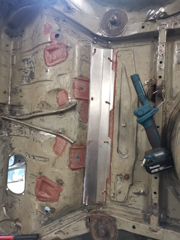

            I have not much to say. Pictures say more than thousand words. :)
            Click image for larger version  Name:	turvav88_kinnituskohad.jpg Views:	0 Size:	147.0 KB ID:	10102414
            Click image for larger version  Name:	tagum_tala_l6igatud.jpg Views:	0 Size:	145.6 KB ID:	10102415
            Click image for larger version  Name:	tagum_tala_pooleli.jpg Views:	0 Size:	176.6 KB ID:	10102416
            Click image for larger version  Name:	tagum_tala_valmis.jpg Views:	0 Size:	170.2 KB ID:	10102417

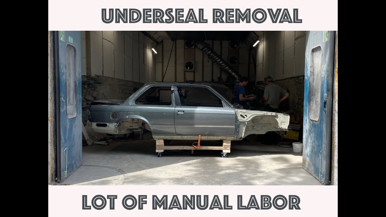

            Here is the "short" video how i got to this very point. :)
            Youtube https://www.youtube.com/@MisWorkshopBMW
            Instagram: https://www.instagram.com/misworkshop/

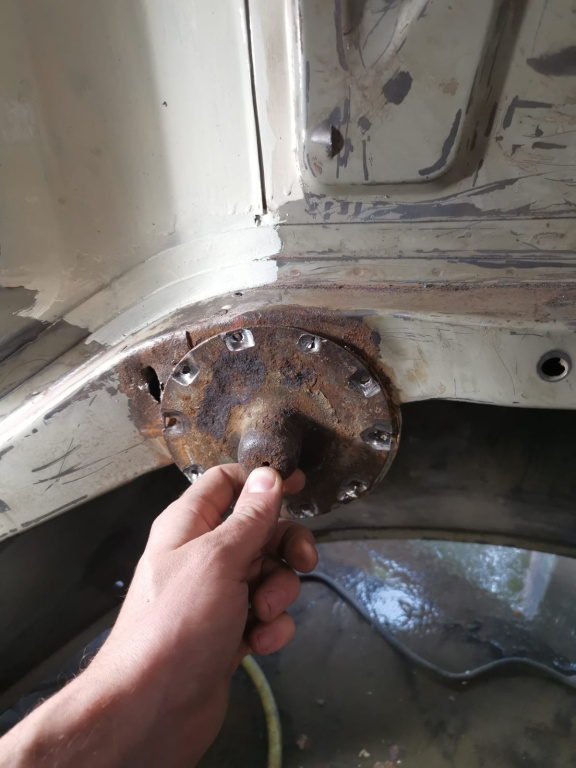

                  Again i can post some updates of restoration progress. At first i thought i should buy new ones. One German company makes them, but discussed with my friend and we decided that he will fabricate these himself. The end result will be the same, maybe even better.
                  Rear spring perch (i think it's the right word for that?)

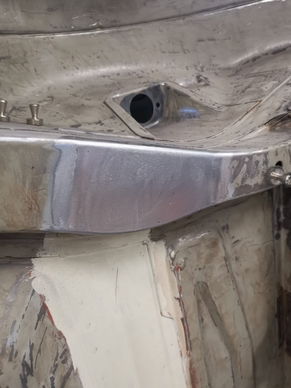

                    Other side there is a tank ventilation pipe. I bought https://www.specialclassicparts.de/e...vent-repairkit and the plate thickness is bit different than the original. Original sheet used to build the car is 0.8mm but the one i got is 1.2mm thick. 0.4mm thicker and if you gonna install it like it should be then there will be stupid and ugly looking lip. And i don't want and like that. So he will fabricate this small piece of metal.​

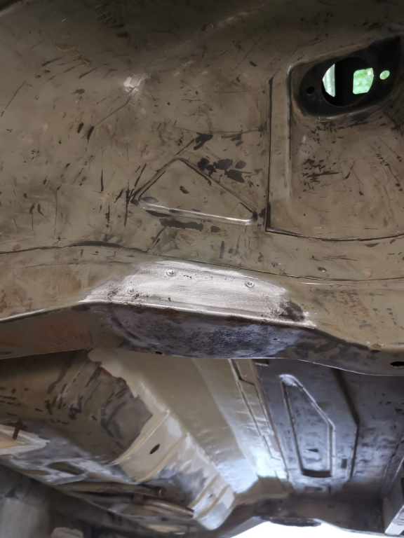

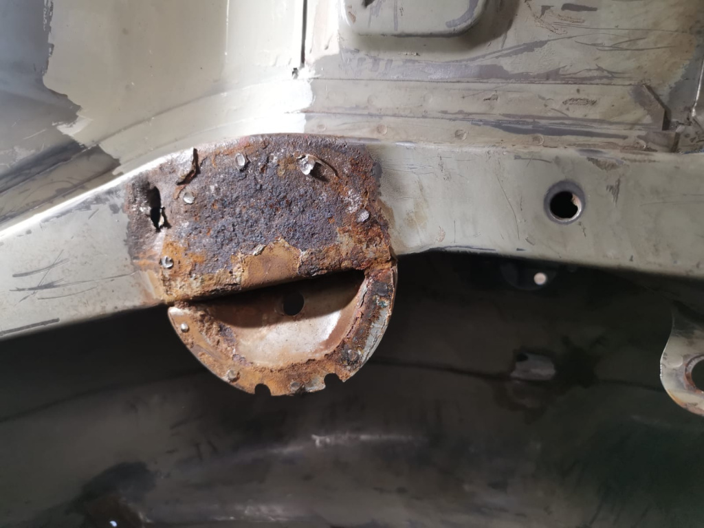

                        In the right wheelarch there were some ungly looking rustholes and brackets.
                        Not anymore. :)

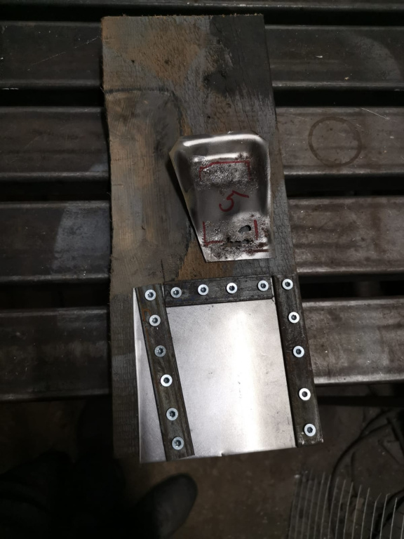

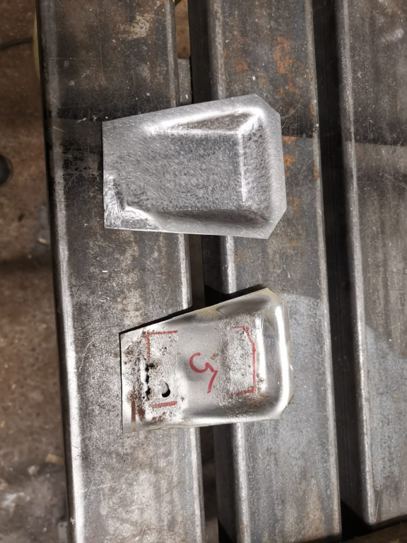

                          New spring perches fabricated. Needs grinding in to shape before welding them back.
