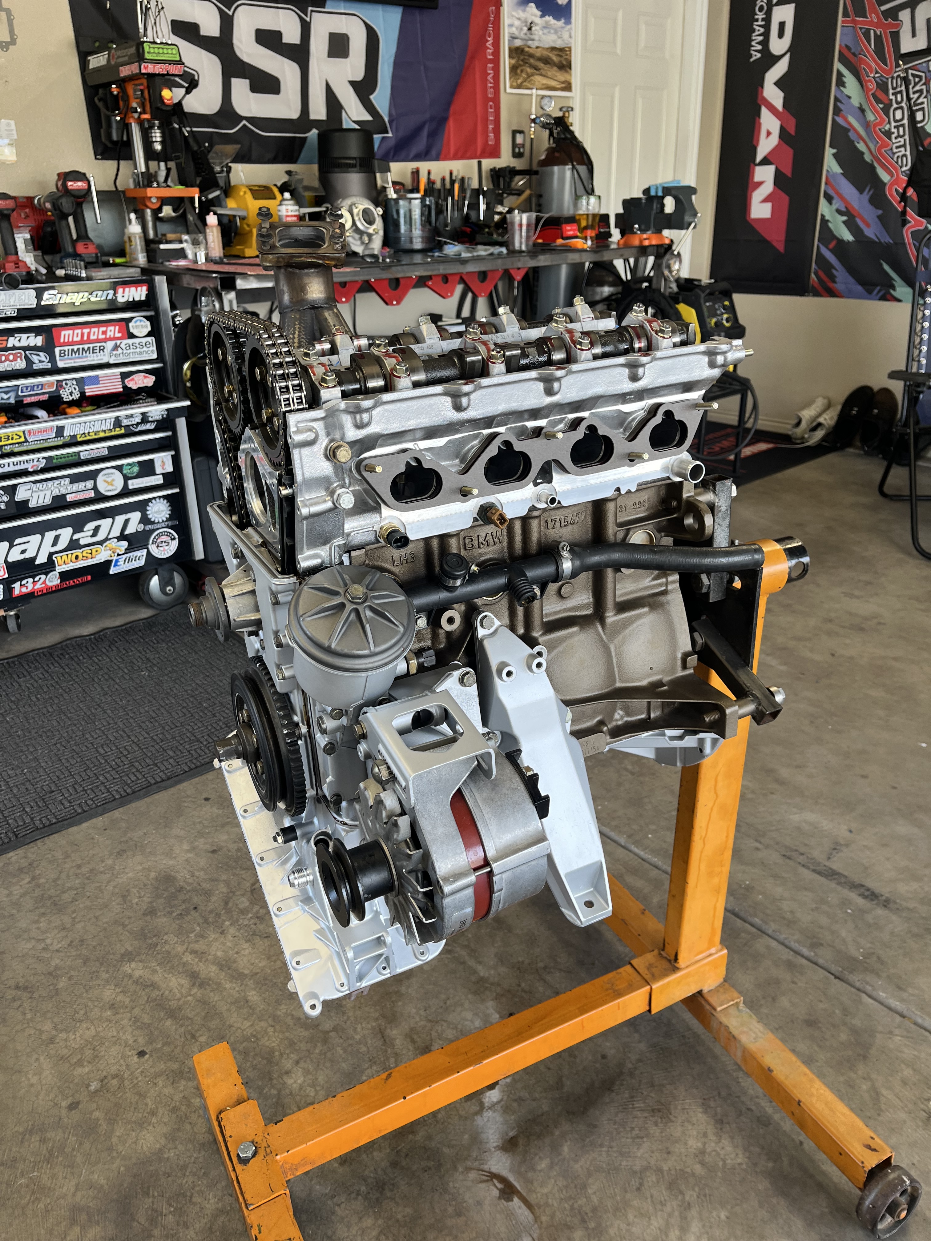

              #831
              Re-honed and decked. New pistons and rings.
              Short block is back together now. Rods and pistons balanced within .47g
              Top ring gap .0195
              Bottom ring gap .0235
              Cerakote block (burnt bronze)
              New freeze plugs
              Spins like buttah.

                      Did the old school by hand valve lapping. Took about 1.5 hours per cylinder.
                      All parts cleaned up and installed. One more step to a reconditioned long block.

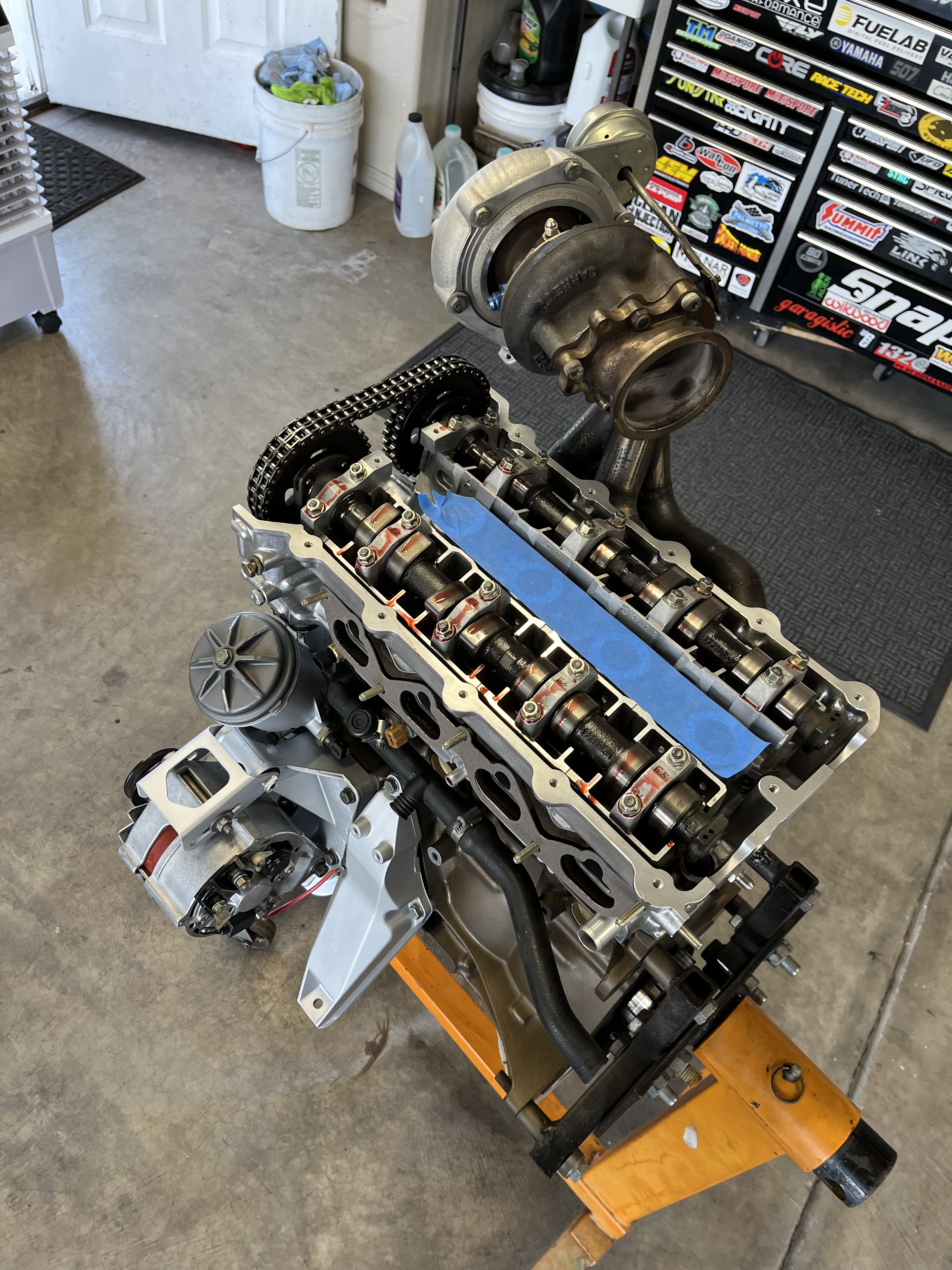

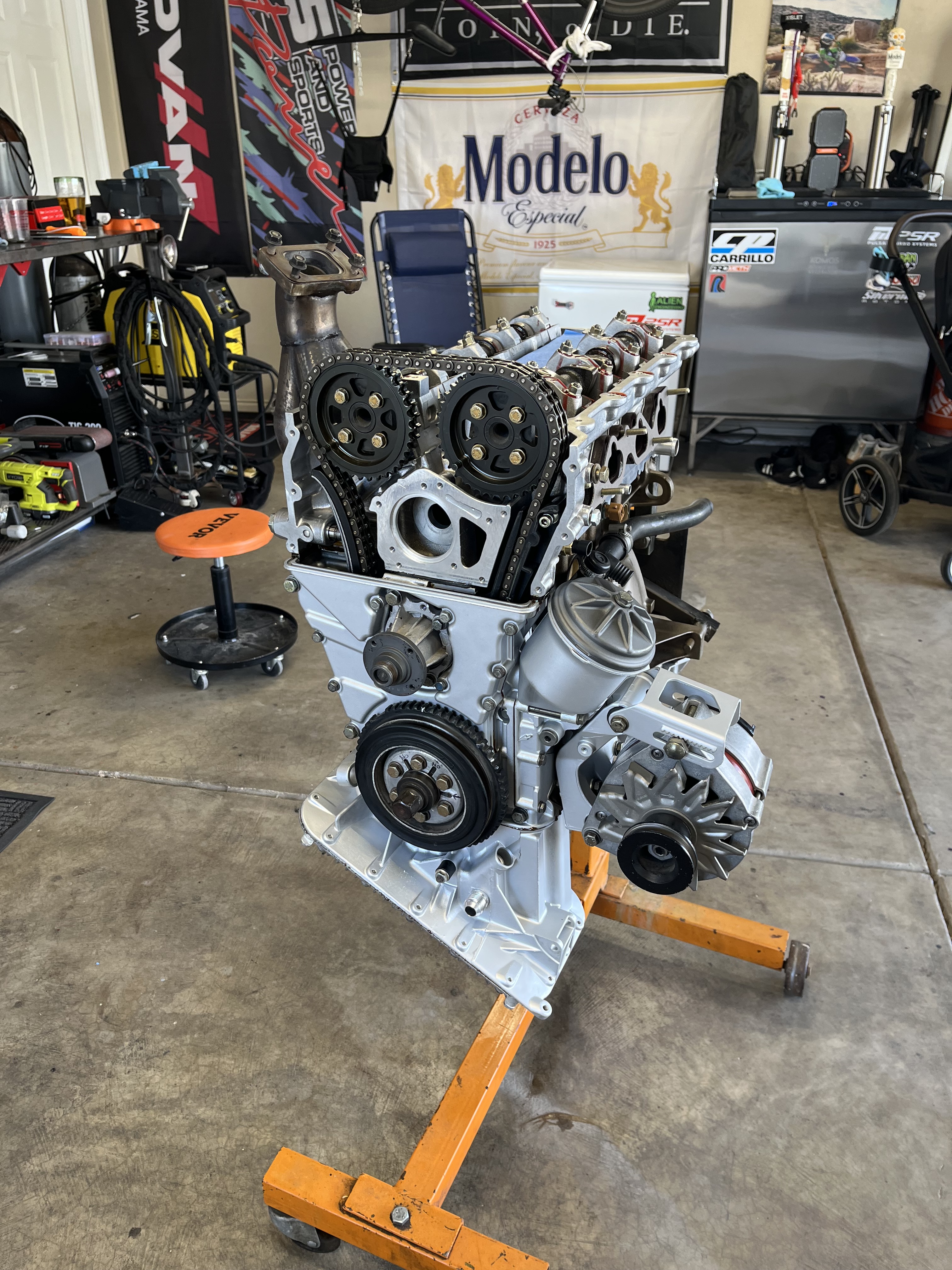

                      • Dj Buttchug
                        • Jun 2010
                        • 7686
                        #836
                        Getting closer now.

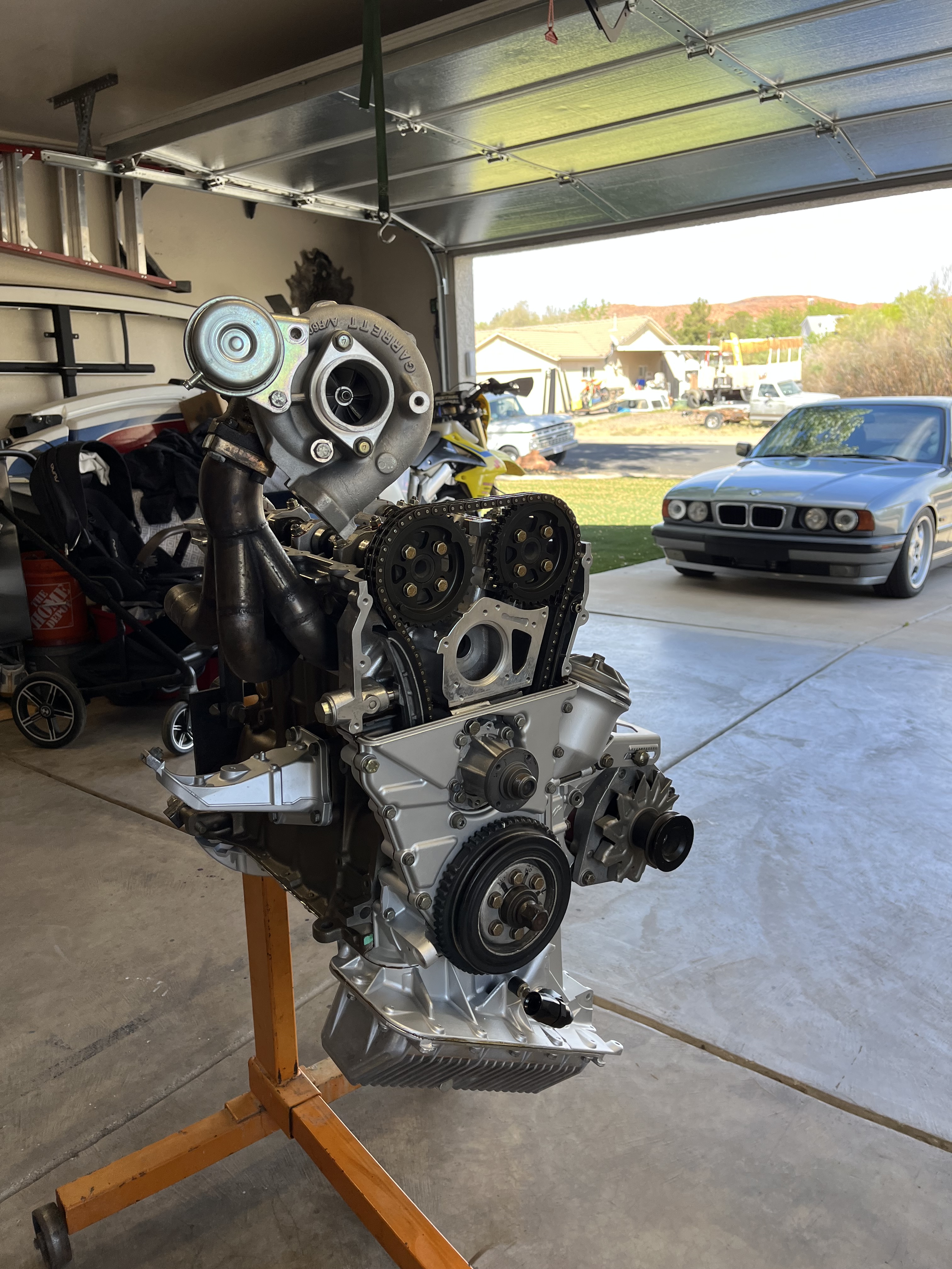

                              • Dj Buttchug
                                • Jun 2010
                                • 7686
                                #840
                                Almost ready.
