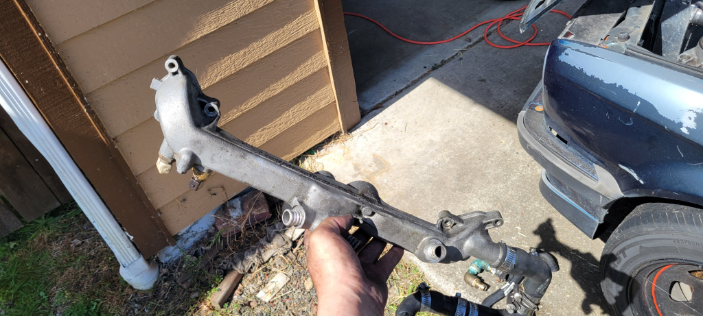

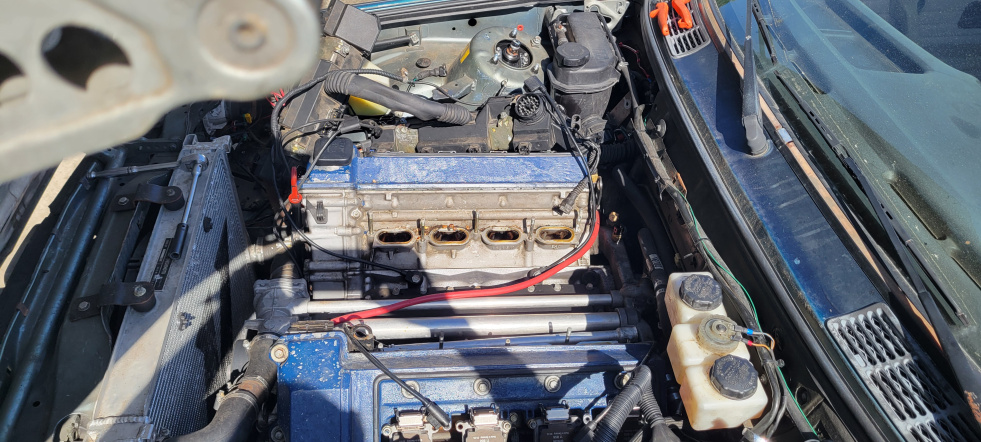

                            After a mess of staring, and head scratching, i came to the conclusion that I could get to the coolant crossover if I pulled the Intake. Needless to say, thats what happened.
                            Click image for larger version  Name:	20260524_100406.jpg Views:	0 Size:	267.8 KB ID:	10161517
                            I was able to get to all the bolts and got the bastard off.
                            Click image for larger version  Name:	20260524_104655.jpg Views:	0 Size:	260.4 KB ID:	10161518

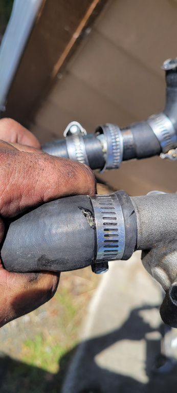

                            and found the smoking gun.
                            Click image for larger version  Name:	20260524_105121.jpg Views:	0 Size:	104.4 KB ID:	10161519
                            So I was off a little, not the cap, but a break in the line that looped around to the reservoir.

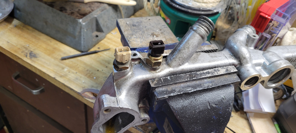

                              the new crossover I yanked from a junkyard 2001 540i didn't have bungs for the temp sensors.But it did have the bosses.
                              well, now it has Bungs.
                              Click image for larger version  Name:	20260525_101924.jpg Views:	15 Size:	215.5 KB ID:	10161591
                              I ended up buying a entire tap and dye set from harbor freight just to get the M14x1.5 tap to thread the holes. Oh well, im sure I will need the set again someday.

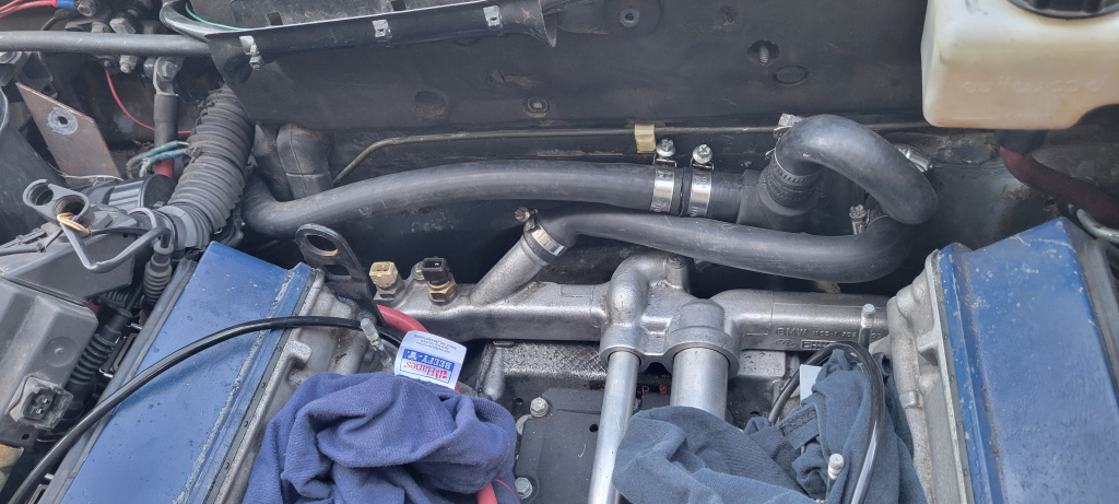

                                Progress has been made. Crossover with new O rings and gaskets has been mounted. Hoses aquired and fitted. It not perfect, but it will work, and is better what was there before. No more household plumbing parts mixed in. Filled the system with new pentefrost, with no leaks. Just waiting on the Intake O rings/Gaskets now, then the Dumpster Fire will be ready to Terrorize the roads again. I cant wait! I miss throwing around the shitbox!
                                Click image for larger version  Name:	20260601_164047.jpg Views:	3 Size:	218.8 KB ID:	10161911
