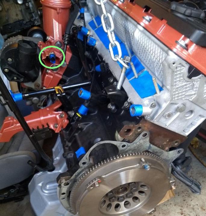

          Was able to get some no start diagnosing in today. Checked all the relays and fuses in the engine bay fuse box and they checked out. Then realized I had +12v constants for the engine wiring harness connected to the wrong post, so moved those and got power to them. Hoped that would be the fix, alas it was not. So I figured I'd better get serious and check for the obvious... fuel and spark.
          Removed the fuel rail and turned the engine over to find that no fuel was spraying. Disconnected a fuel line at the IM and sure enough it was bone dry. Disconnected the other and fuel sprayed everywhere! Must be a bad FPR I thought! Went to pull the FPR out to get a replacement, but as I explained the story to my GF I realized that I was an idiot and that in reality the feed and return lines were switched! D'oh!
          Ended up having to get a new FPR anyways because I'd somewhat crunched the old one when removing it (double d'oh). Picked up the new one, put everything back together and gave it a test start. Sure enough it stumbled and attempted to start! But a couple seconds into cranking I started hearing a screech and my mind went straight to dry cams! It was dark out by then and I surely wasn't going to turn it over if the cams were dry so I ended for the night.
          Plan tomorrow is to remove the VC and pull the cam caps one by one to check for any wear and apply some more assembly lube just in case. Also want to find a way to hook up an oil pressure gauge, as now I'm freaking out that there's no oil pressure! How is everyone else hooking up a sensor for an oil pressure gauge? Would I be getting a warning light or something, if the pressure was too low?

            Fuel lines backwards is an easy mistake! Is your oil pressure sender wired to the cluster light? If I'm remembering correctly, the factory oil switch closes above 7psi so the light should go out fairly quickly when cranking the car. I also assume you filled the engine with oil (had to ask....I assume you would have done this).
            The only place I know of to hook up an oil pressure gauge is the port on the oil filter housing where the pressure switch for the dash light lives - circled in green on the pic below. The threads are M12x1.5 FYI if you need an adapter to your gauge.
            I think it is a good idea to pull the valve cover to see if you are getting oil up there from your attempted start. You could also pour some lube over the cams while you're in there.
            Another way to check for oil pressure or build oil pressure prior to start-up is to pull the fuel pump relay/fuse, pull the spark plugs and crank over the engine with the starter. This method ensures it won't start and helps the starter spin the engine faster (and help build oil pressure faster). If you've wired the oil pressure sender to the cluster it should go out quickly using this method or your gauge should show pressure build quickly.
            Making awesome progress - hope you get it all sorted!
            Edit - picture is not showing up in the post so I attached the file...maybe this will work.....

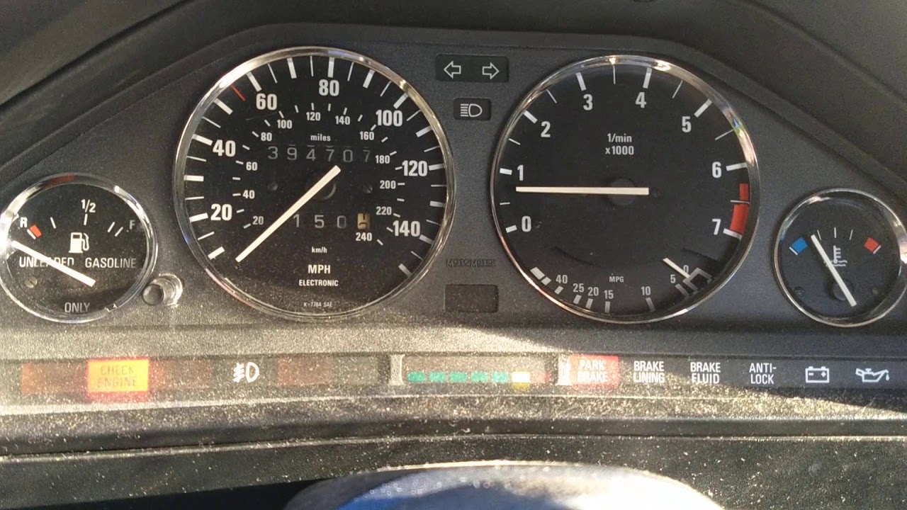

                      And the motor is OFFICIALLY running. Finished reinstalling the clutch trans and everything else just in time to watch the superbowl yesterday. Before I sped off to my friend's house I gave her a quick start to find the noise gone! phew!
                      I left work a little early today so I would have some light to do her first warm up and check for leaks, etc. Turned over and started almost immediately and dropped right down to 750rpm. Probably not the best considering it should still be in warm up enrichment, but hey, I'll take a strong idle! Checked that the oil light on the dash went out and grabbed some water and coolant to fill the cooling system. Let her fully warm up and topped up the PS reservoir with fluid. As the temp needle approached the middle of the gauge the SPAL fan kicked on! Sweet! Always nice when at least something goes exactly to plan!
                      No leaks and everything was looking good (except for super loud lifters), so I wanted to go for a quick drive around the block... just to see how it felt. Put it in reverse, let out the clutch, and GRIND. Tried again, GRIND. Pushed the shifter hard and held it forward and finally it engaged reverse. Pulled into the street and started off in first. Accelerated up to about 4k rpm and it popped out of gear. wtf? Dropped it into 2nd and finished going around the block to pull back in the driveway. The car does not want to go or stay in the forward positioned gears (R,1,3,5). I'm now beginning to wonder if maybe I received the wrong DSSR (too long) and there's not enough room to fully engage the gears. Going to pull off the center console tomorrow and see if I cant get it to stay in gear and work correctly.
