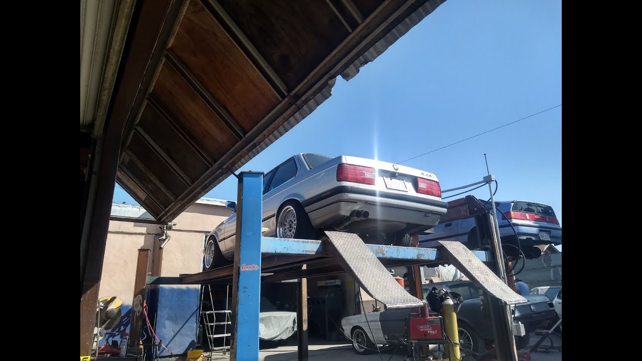

            Thanks! Here she is getting the exhaust finished up
