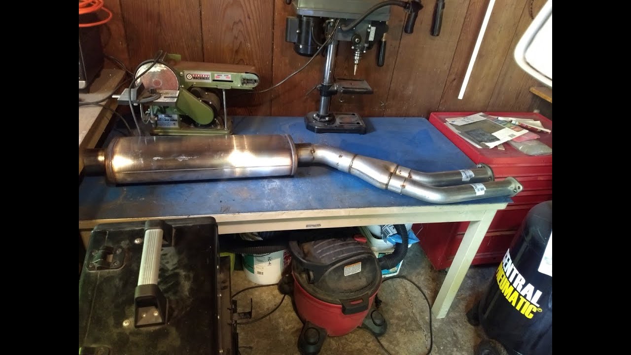

                  Me too! I finished welding the front half of the exhaust and reinstalled to get a listen of it with just the Magnaflow and honestly, I'm concerned it'll be too quiet! Don't get me wrong, it's loud, but only kinda loud. It'll be way quieter when I get the Varex on, even with the bypass open. I guess we'll see!

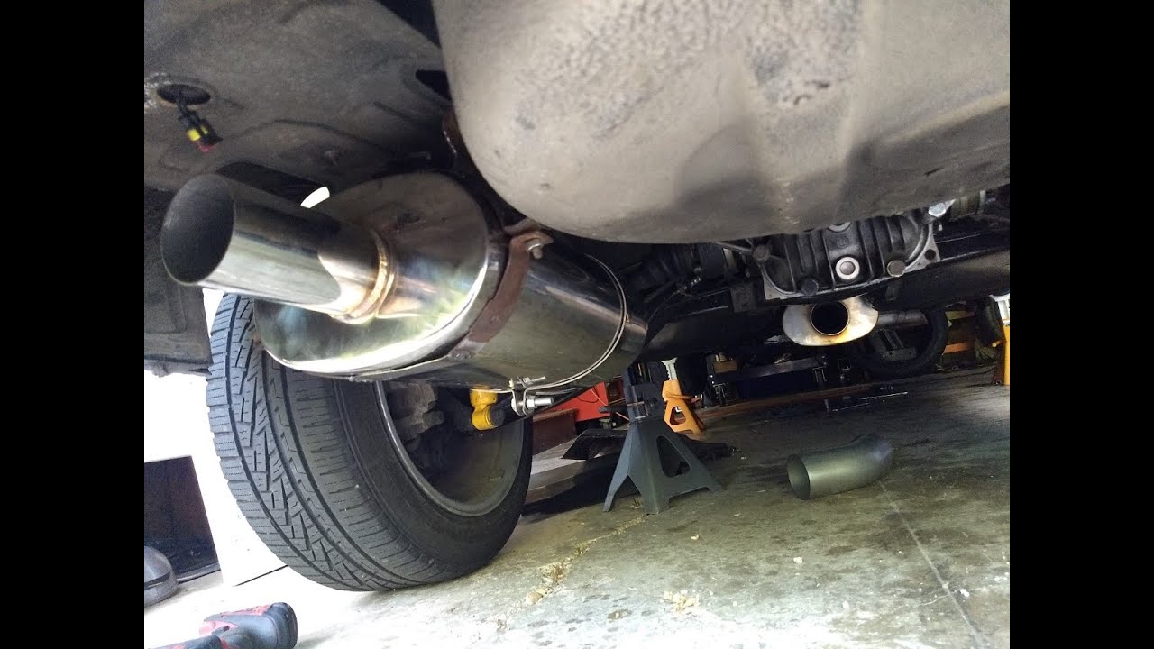

                      Took a quick video of the exhaust as it sits. Sure it's loud, but it'll be way quieter with the new muffler.
                      Also mounted the rear muffler today. Hope to have it all buttoned up tomorrow!

                            Pretty much finished her up this afternoon. Ran out of welding gas last night but luckily found a shop that was open today. Took a little trip to pick that up and also dropped off my wheels to get a free balancing at Americas Tire.
                            Came home and finished up the last of the welding and reinstalled everything to give it a listen. As suspected, it's too quiet. The Varex has 2 modes as previously pointed out, open (straight through) and closed (think turbo muffler). In the open position, it sounds how I'd like it to in the closed position. Right now the closed position is basically useless, as there's no reason to ever close it!
                            Rear half mocked up
                            Everything fully welded
                            And installed
                            Still waiting to do the rear tip... want to finalize everything before committing.
                            Took her for a quick drive to see how it sounds. Have also confirmed, by getting the tires balanced, that there's definitely a vibration in the driveshaft. Oh, and it now pops out of 3rd pretty much every time I go WOT, so that's fun. But man, she's a quick one! Not only is 1st useless, but 2nd is as well! It will seriously break the tires loose and spin at WOT past 4.5k in 2nd. Not dropping the clutch, just rolling into power. DEFINITELY need some wider/better tires!
                            Quick video of everything in the open position. For some reason the muffler won't close, gonna have to look into that... opened last night without issue. Will soon have a driving video similar to my last, but need to get the trunk lid, bumper, and side mirrors on first. This idiot company that I ordered paint from has taken over a week to even ship it. So frustrating.
                            Camera is a bit too close which has a bad outcome with the sound, but gives you an idea. Should have good speakers/headphones (aka not your laptop/phone speakers) to listen, as it's very deep and requires good bass to hear correctly!
