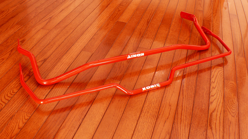

            :pimp: Koni Rallysport adjustable bars for early E28s and '83 - '84 E24s. New old stock! No help to you, but they are the ill shit nonetheless.
