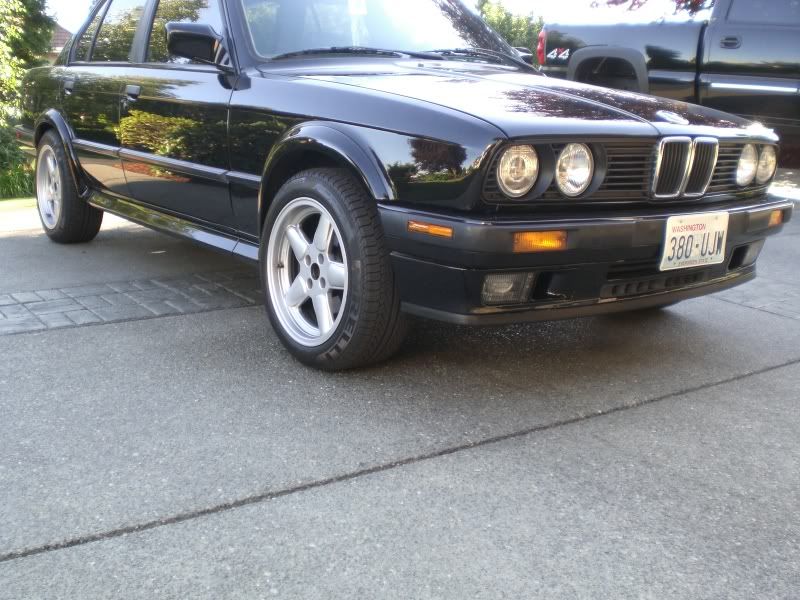

          People like to have positive offset on e30's because that's the way it's designed. Go ahead and get an ix and put 0 offset wheels on it -- and you're talking about running 245's on a 0 offset wheel. 8.5 in. wide et0 will not fit. It's a daily, and all of the aftermarket flares are ugly as shit.
          Here is my friend's ix on stock 4x4 suspension with et25. He has rubbing issues with four people in the car (though he may have bad shocks). If that car was lowered at all, the fenders would rest on the tires.
                those are 7.5" wheels right? yeah there's no way those would fit if his car is lowered - I had the same size when I bought my car. you can trim the rear some, but mine actually rubs up inside the fenders, not on the lips.. can't really trim that. :p
                about the widest you can run is an 8" wheel on an ix (assuming proper sized tires), and your offsets have to be perfect. there's potential to run a 9", but you'd need a higher offset on the rear wheels, which would look goofy as the ix already has a much wider front track. although I guess I could do 9-10" with some super eur0 stretch tires, but that's not what my car is for...
