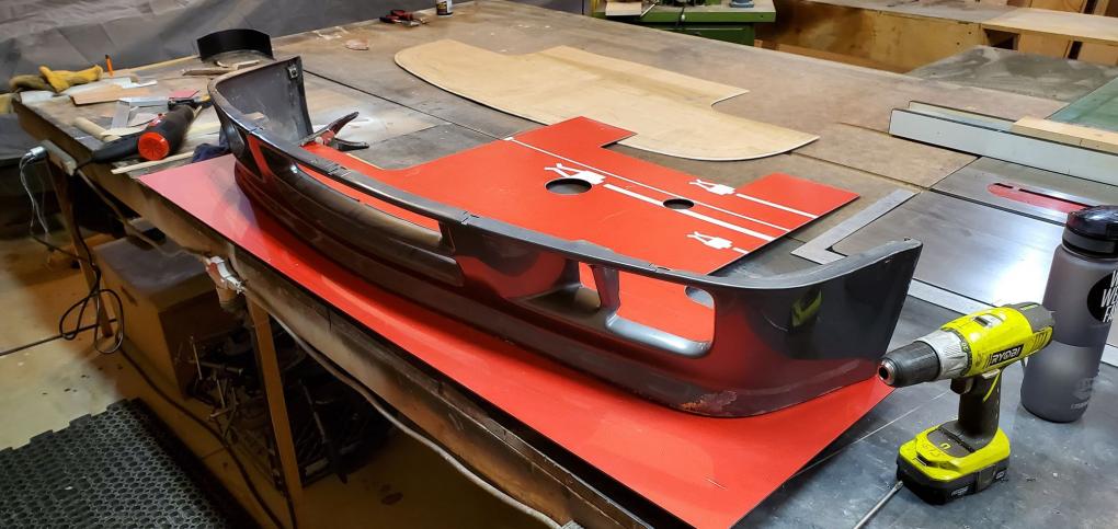

                            Well I was a bit too ambitious over the winter and wasn't able to check everything off the to-do list for both cars. The e30 splitter project was completed but the e90 took up the rest of my time getting a full paint correction, black dyed headliner, Logic 7 audio retrofit, M3 control arms, rear shocks, and a set of 19" Style 351 wheels.

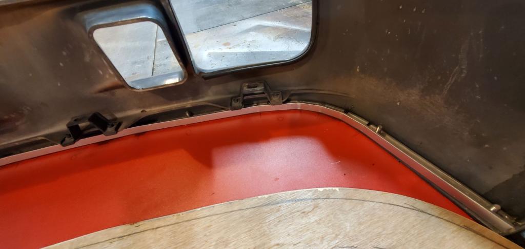

                            The e30 splitter worked out quite well for being as minimally invasive as possible. I started out using a piece of 1/4" plywood to make a template that would be traced to final splitter material. I used a sheet of dibond for the splitter material, drilled holes into the bottom side of the valance and ran a piece of aluminum angle stock along the inside contour of the valance. 1/4-20 allen head bolts and large washers attach the splitter to the threaded aluminum piece essentially sandwiching the valance to prevent flex. For the middle supports I noticed a threaded hole in the frame and matched up the bolt size and ordered up a couple lengths of threaded rod to be used as stanchions. The rear splitter mounts used a riv-nut mounted in the holes in the front subframe. I'm hoping to eventually extend the splitter into a full undertray but for now the front section will have to do. I also had a company in Germany 3D print brake duct adapters going from the MT2 valance to standard 3" DIA hose. As of right now they're not routed to any hose, so that will be a later addition as well. I'm not sure whether to box in the splitter by putting an additional piece of dibond along the frame rail to block off the engine bay more or if it needs the wheel wells open to pull heat out of the bay.
                            Click image for larger version  Name:	MT2 splitter pre-contour.jpg Views:	0 Size:	80.7 KB ID:	10064096 Click image for larger version  Name:	MT2 splitter inside lip.jpg Views:	0 Size:	48.6 KB ID:	10064095 Click image for larger version  Name:	MT2 brake duct.jpg Views:	0 Size:	28.1 KB ID:	10064094
                            Without proper software, its really a shot in the dark with a lot of aero stuff it seems like. Pipe dream would be to snag another MT2 spoiler and add a multi-position gurney flap but that would be a big undertaking to get it to a level I'd be happy with. In addition to the splitter I want to fabricate side skirt extensions, full smooth underbody, and a rear diffuser in the same style. That likely won't be happening until I decide on exhaust components to use to dial in the sound I want in the space available in order to make the underbody panels as efficient as possible given the build constraints.
