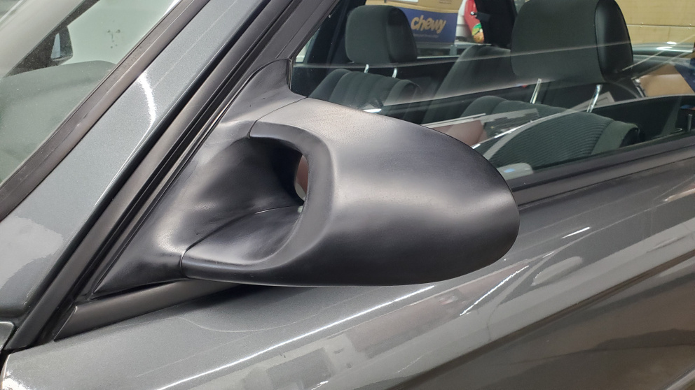

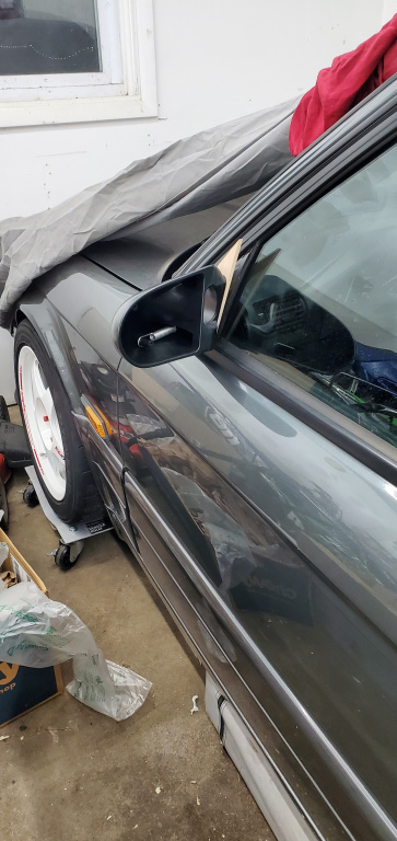

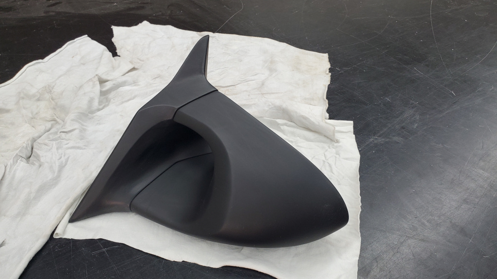

          Over the winter I had spent a bunch of time on the sim rig turning laps in the DTM e30M3 and got motivated to add some DTM touches to my real world car. I ordered up a set of vented DTM style mirrors from a company in England. Upon receiving these fiberglass abominations and realizing I could have paid a lot less to be disappointed by a poorly fitting part I decided to head down a road I wanted to travel since buying my Japanese market car; Ganador mirrors. Some of you may be familiar with Ganador mirrors from seeing them on Japanese tuner cars from MR2s to Skylines to RX7s and more. If you know some of the cars they came on, you'll know they weren't available on German cars of the era. Since this project is a mix of OEM+ and period correct Japanese styled tuning, Ganadors and Regamasters were on the list for me from very close to the start. Since this was an experiment that I wasn't sure what would come of it, I ordered the cheapest Ganador reps I could find on eBay and set to work. The outside portion of the mirror (the shell that actually holds the mirror glass) is the same across all the Ganadors and cast aluminum bases are what differs vehicle to vehicle. My thought was to mount the mirror shell and supplied base to the door then mold my own bases to be 3D scanned then duplicated in 3D printed aluminum to replicate the originals as close as possible. After many revisions, many hours of applying body filler like clay, then sanding, reapplying filler, sanding that, etc. I finally got to a contour and profile that I liked. I then decided I wanted it to work with the OEM mirror seals so I added more filler and sanded, sanded, and sanded some more. Finally ended up with one driver side mirror base I was happy with and ready to be scanned and duplicated; first in plastic, then flipped (mirrored har har) to verify it will work as a passenger side mirror. Still in the process of getting it scanned and reprinted, as I think all of us can relate, life can get in the way.

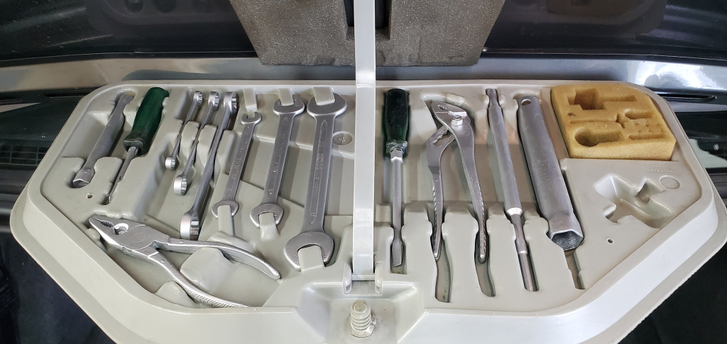

          Moving beyond some custom mirrors, I had also sourced the majority of the tools I needed to fill the large OEM tool kit I had added in the trunk. I found someone parting out e28s and they had a questionable rusty tool kit for $35 shipped that I decided was worth a try given the fact I'd likely never use them anyway. When I received them they were as pictured, rusty but not too terribly far gone. After some time on the bench grinder with a wire wheel most of the tools were looking good. The pliers I was certain were froze shut came apart with some PB Blaster and a bit of force. Gave them a quick paint job and set them in their new home. I'm still on the hunt for a large pair of channel locks and I also need to pull the trigger on the larger foam backing pad to apply to the trunk to get this off the checklist. I'm thinking a light application of acetone on the old foam will lift the glue and some spray adhesive will get the new foam in place.
