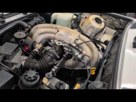

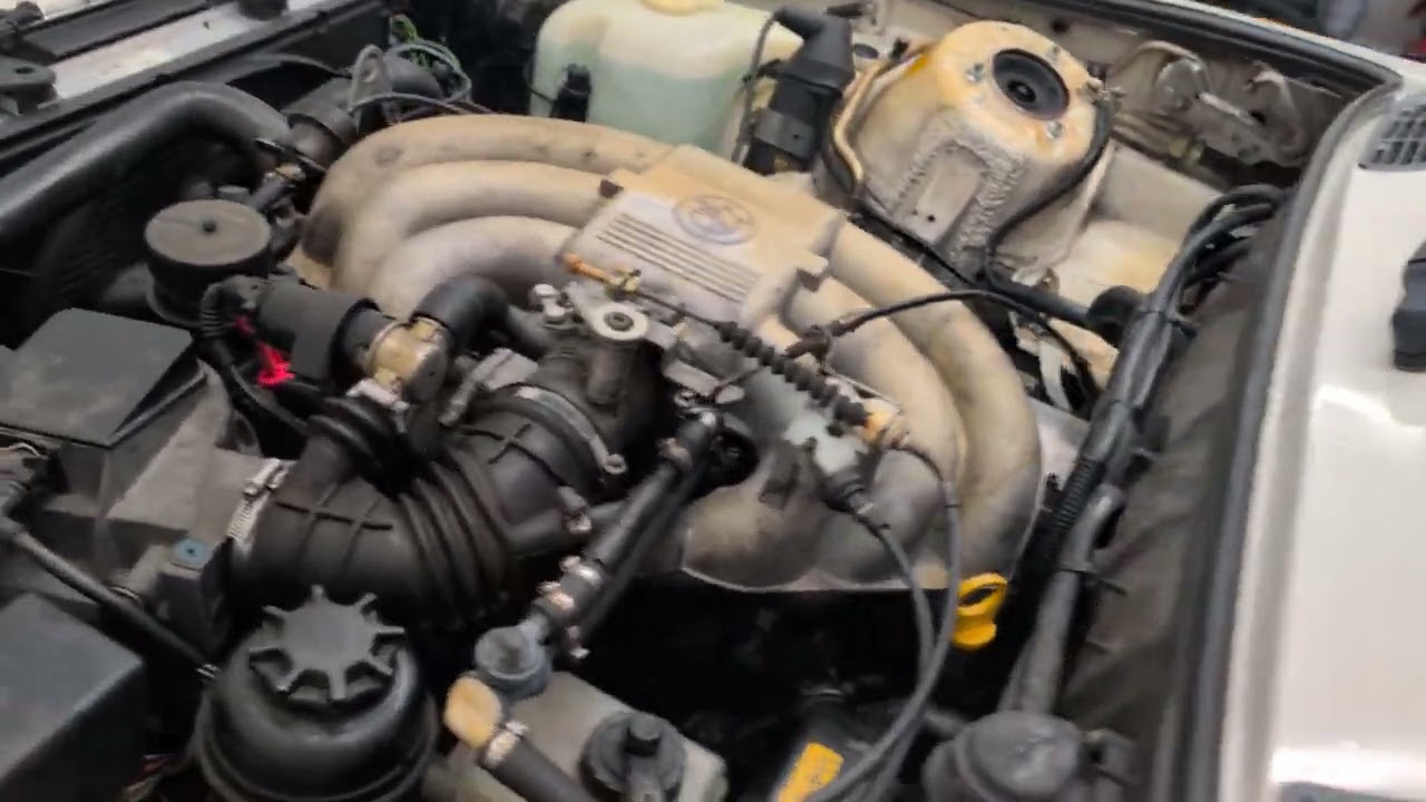

                Hi everyone, how’s it going? In this post we’re going to start the car! (best YouTube impression)
                Buttoning it up was pretty simple, except for forgetting that the bitch tube goes in BEFORE the intake manifold. I had to take the thing off twice before I got everything on in the correct order.
                I wiped the head and block with acetone to clean it. Then installed the gasket dry. Head bolts and washers were lightly lubed with motor oil. The head went on smooth bolts got torqued to 33Nm (wait 15 min), 90* (wait 15 min), 90* – All while the engine was cold. (we’re coming back to this) I’m fairly certain that I didn’t miss any of the bolts during the torque sequence, but I did get interrupted mid-process. Next time I’ll mark them for each step.
                New oil filter and exhaust manifolds went on next. Followed by the timing belt and tensioner (water pump wasn’t removed). I torqued the cam gear and checked that the timing marks lined up after many rotations. Then I set the valve clearance to 0.010” cold. Then the timing covers went on.
                Notice how pretty the exhaust manifolds are; Someone grabbed a can of enamel paint instead of high temp paint and didn’t realize until too late.
                Eventually the intake, hoses, fuel lines, radiator, pullies, and other stuff was on. I also put in new plugs, filled it with oil and coolant. It was nice to have it parked on a slope for the bleeding process!
                It was at this point that I was annoyed that the engine and bay looks like crap after spending so much time cleaning all the other stuff I took off. Whatever, it’s together.
                I left the coil disconnected and cranked it a few times to get oil pressure. Then realized the fuel was still connected and I was probably flooding it. No time to worry about that! I plugged in the coil and it fired the first start!
                I was annoyed that I spent so much time and effort working on the car, only to have it functional again. I mean, it drove, so that was an improvement, but it was still a tired m20 with a half-assed head.

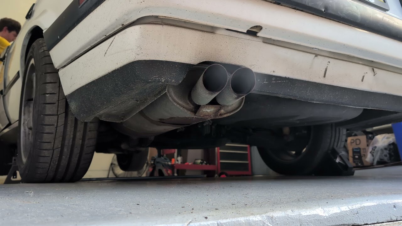

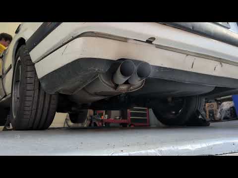

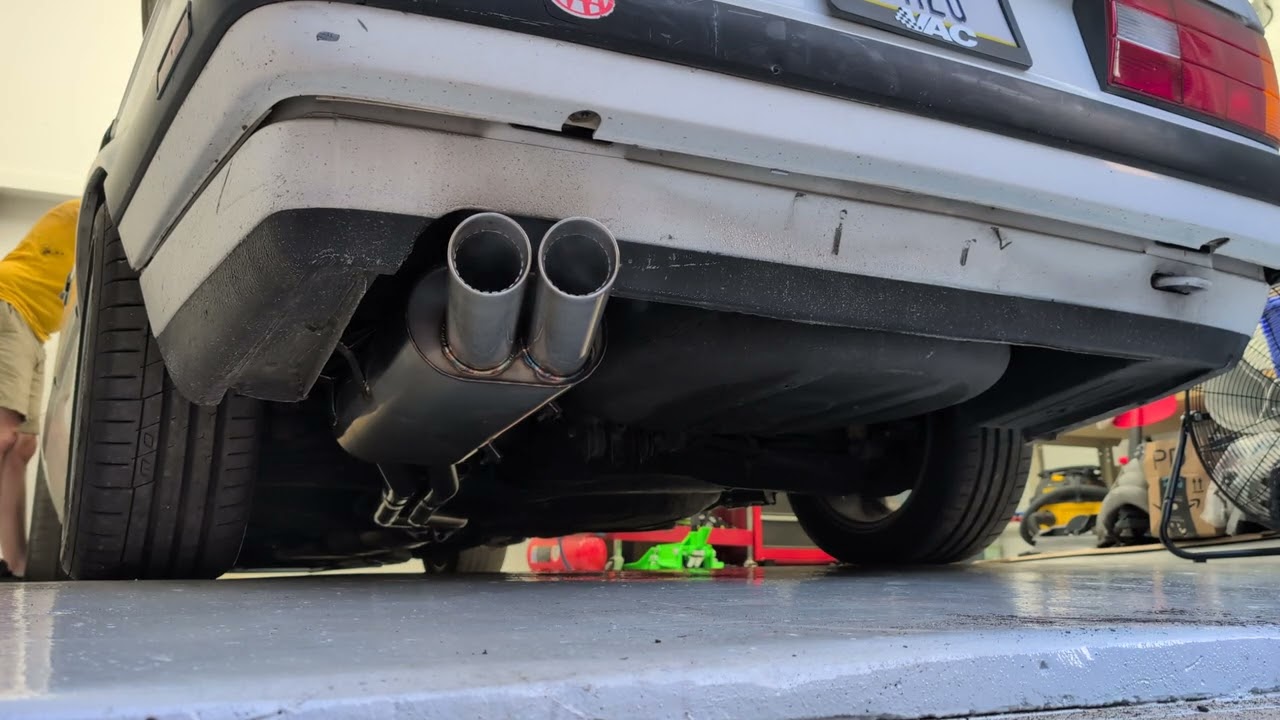

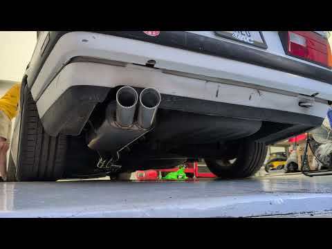

                So I decided to toss the Strömung exhaust on it! It definitely louder and deeper than my stock exhaust. It sounds great at idle, but it also drones a ton around town and on the highway with the constant RPMs of an autotragic. That may be partially due to an exhaust leak from not having the 75mm seal. I just ordered one, so I’ll see if that helps.
                I drove about 12 miles around town and it seemed fine, so I figured it was ready for the 30 mile drive to work (which includes highway). I can't tell if it feels down on power, or I'm just used to the tuned 335i, but it had plenty of power for the next few months. I’ve got too much rear toe-in that needs to be fixed and the tires aren’t balanced, but overall it was fine!
                Now the bad news. The exhaust manifolds look terrible – whatever.
                I also have oil weeping from the passenger side of the back of the head gasket, the two bolts next to cylinder #6. Can I torque those bolts more? How risky is it for them to snap?
                It does NOT like to start when hot. It always started on the second turn of the key, but now it takes 3+. I have a new blue coolant temp sensor that I can toss on. Any other ideas?
