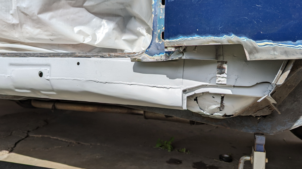

                              #284
                              Couple of pics.. Here I'm probably halfway through the process. The rust is cut out, and I've already welded in one of the new strips of metal that acts as the new base for the new panels to bond to. The primer paint is a special, weld-thru primer, so the metal is protected even as I cover it up and weld on the other side.
                              Click image for larger version  Name:	PXL_20230416_234440775.jpg Views:	0 Size:	224.4 KB ID:	10091504
                              I had to patch up extra parts where the rust really ran up the side.

                                #285
                                Here is the new inner panel welded on.
                                You can't really see the other patches, but they're there to better seal the compartment. From the factory, it was an open chamber, which is probably how water got in and it rusted to much in the first place. ...I didn't seal it totally, but at least there's not a large entry way for road debris to get in.
                                This doesn't need to be pretty, it's going hidden by the outer panel.
