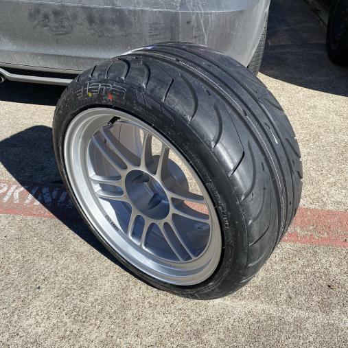

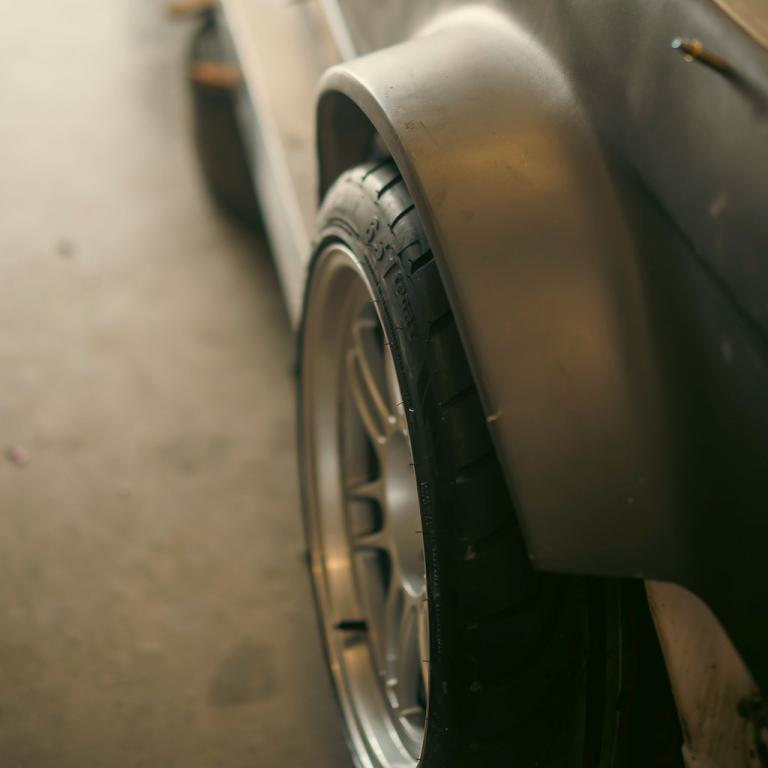

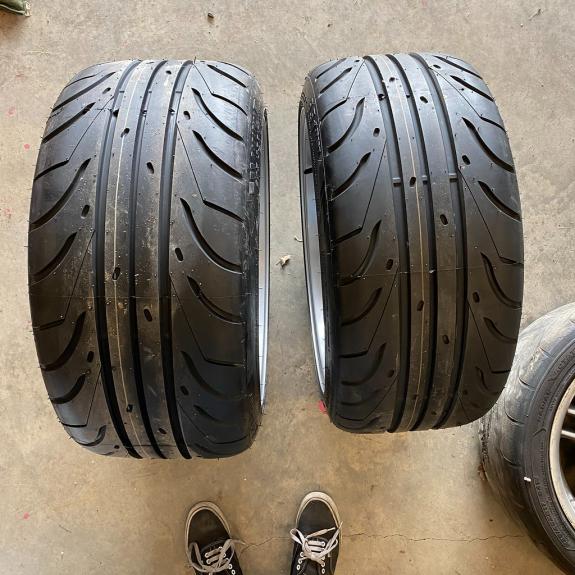

    Once my rear wheel came in I decided Id risk it and go ahead and mount the 285/35 on the 18x10.5 and hope for the best.
    Front and rear comparison... super meaty lol
    But on to the important stuff... how well does it fit? I'll let you be the judge...

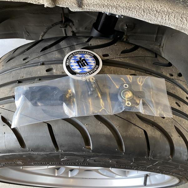

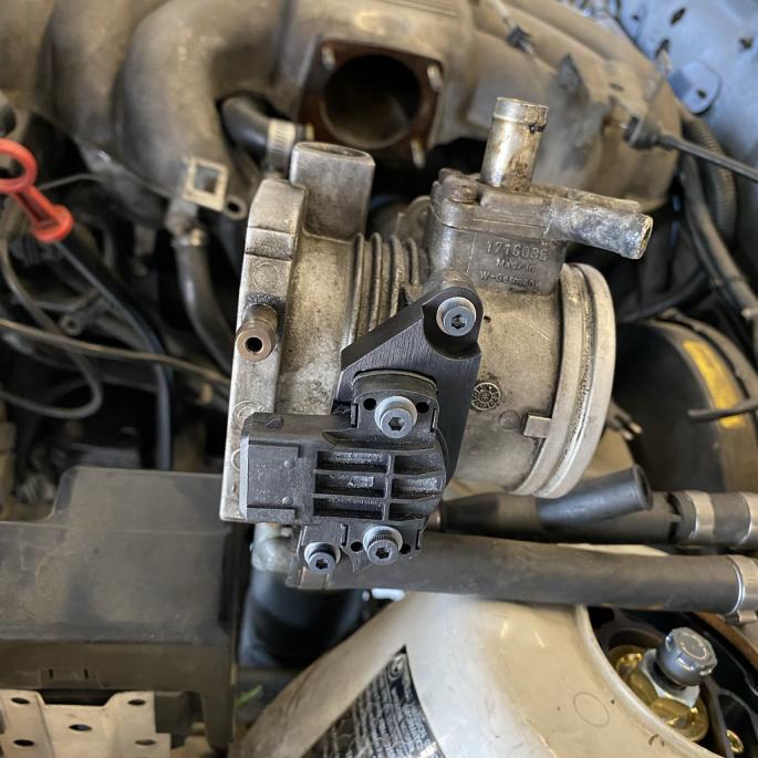

          Since I'm moving soon and the car will be moving up to our warehouse I've been trying to spend some time on my least favorite part. Making it run again...

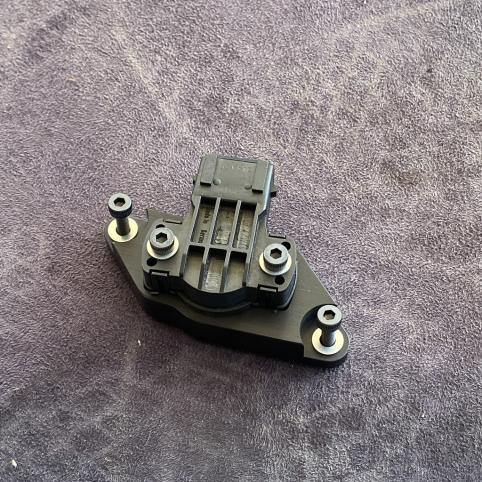

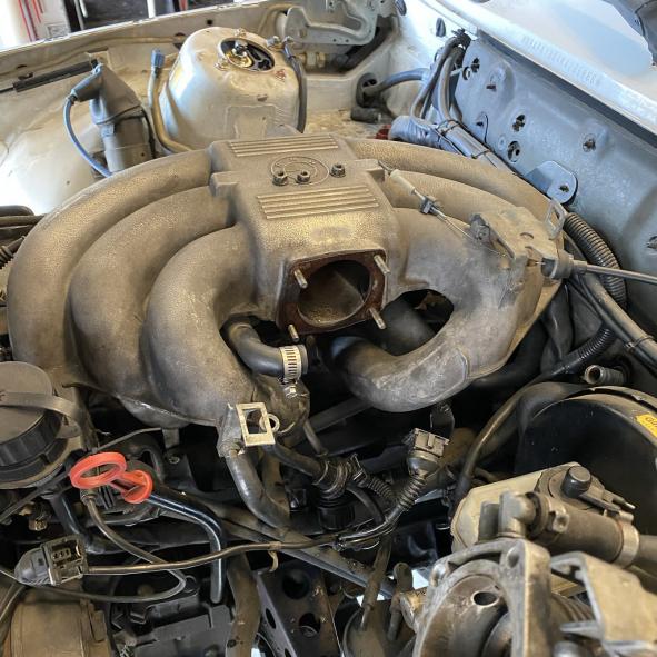

          A month or so ago I pulled out the Split second AFR garbage that was wired in and plugged in the Megasquirt ECU. I haven't had the desire or mental capacity to even mess with it further until this past weekend. The engine bay is a mess still... (which will be addressed when i get it to our shop with a lift and engine hoist and some space) But I pulled the throttle body off and cleaned all the oil I could off of all the surfaces and pulled the old Bosch On/Off style TPS. I bought the E36 TPS adapter plate and TPS from Ireland engineering and it seems to do what its supposed to do just fine other than the fact that the sensor plug now faces the head. But that's just me being picky

          I couldn't find the new seal I had set aside for this, so that will have to be addressed either before it goes back on. Installing the TPS into the adaptor plate was pretty straight forward other than it being pretty snug, so it has to be sucked into the slot by the bolts.

          But as you can see, the sensor faces the Head now... kinda lame but that's how it has to go. I didn't get any photos of be struggling with trying to repin the tps wires so that it reads correctly, but to sum that up very quickly... Im just going to make an adapter out of some new bosch plugs and call it a day, Just in case i ever want to change stuff around or sell this harness and motor setup.
          So when all of that arives ill be able to setup the ECU in tunerstudio and at least be able to move the car around on its own. That is after i get brake lines, and put the driveshaft back in lol.
          Soon there ill have actual substance to this build thread since ill be able to work on it with my coworkers every day, so I'm definitely looking forward to that!

            Make sure that adapter doesn't make your TPS slam into the throttle shaft. The Last 2 I did does that.
            @Zakspeed_US

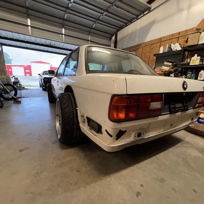

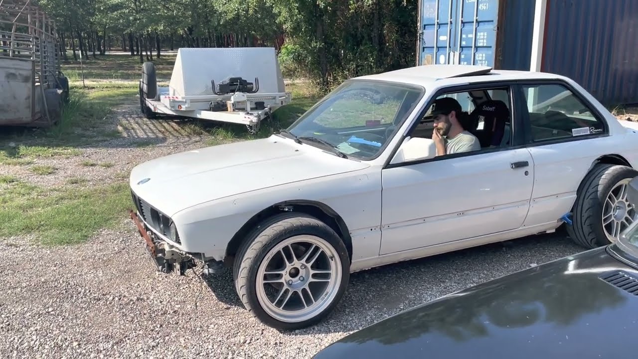

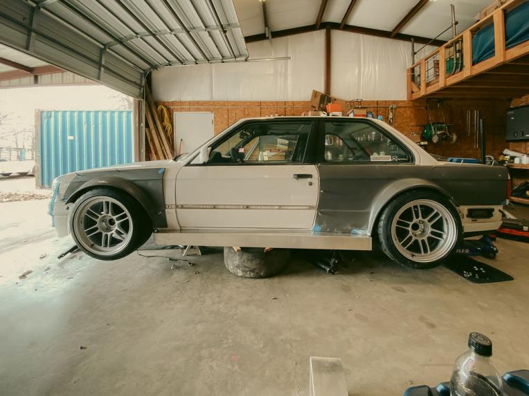

                    Trying to reach a point where actual progress can be made, but life and more minor issues keep getting in the way!
                    A couple of months ago I plugged the Megasquirt ECU in and got the car to fire up and run just fine and it was great. Now it seems either the Crank sensor is shot, or the ECU lost its base file. It seems like its more of a crank sensor issue since it lines up with issues I had when daily driving the car. So one should be here soon so It'll be able to pull on and off a trailer on its own and in and out of the shop at work.
                    Currently, the car has all 4 RPF1 mounted, it rolls around and is basically still a big paperweight... But it looks "cool" lol. I bought myself a Sabelt GT3 for my birthday so I'm not having to sit on a 5gallon bucket to imagine it driving down the road. SLR LCAB with the lock nuts removed got the castor angle where it needs to be, But I'm stuck with maybe even a positive 1* of camber. Disgusting...
                    Since im getting rid of some things and adding others, I picked up a 8 switch, solid state relay panel to run lights, fuel pump, fan, starter, and other things to so the interior is as minimalistic and as clean as possible. Ill have to make a video on how im going to do all this, pretty simple setup but someone might want the info.
                    There is a ton to do still and a ton of stuff I have to redo and spend more time on to do the proper way, But I need it to be 2 hours closer to me so I can work on it more frequently and get those things done and then ill be back to adding some good stuff to this thread. My Girlfriend gave in to my peer pressure and picked up a 1980 320i with all the euro exterior goodies, needs a good amount of love but it's a pretty decent car and ill add a little bit of that project here and there as well!

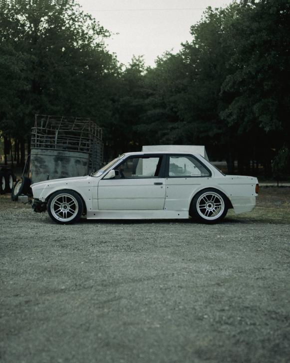

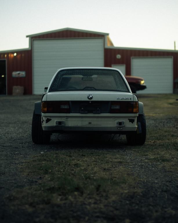

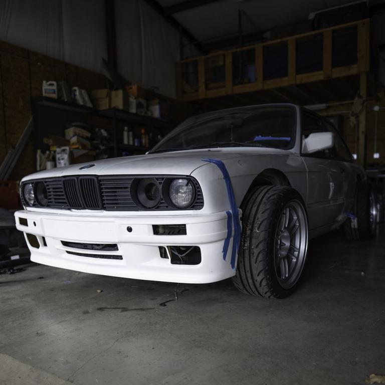

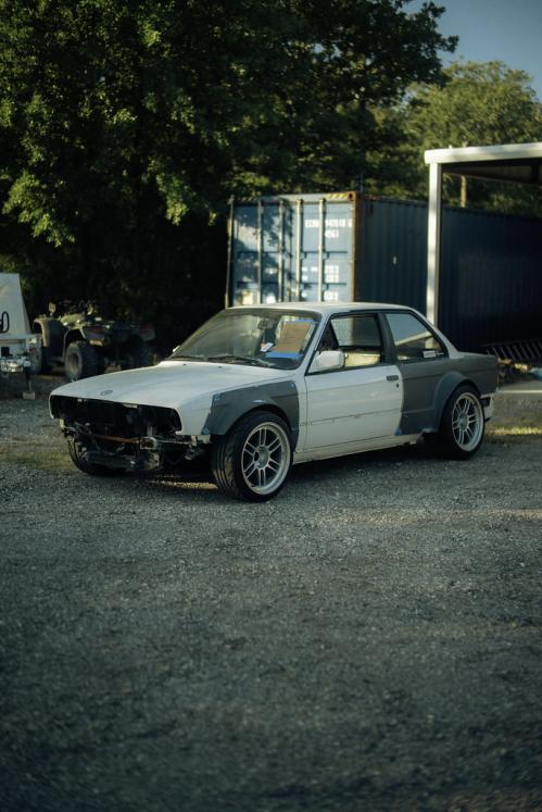

                    Heres some pics of it seeing the light of day with all the fenders on and the full set of wheels, as well as some photoshop love of it all one color with the sideskirts!

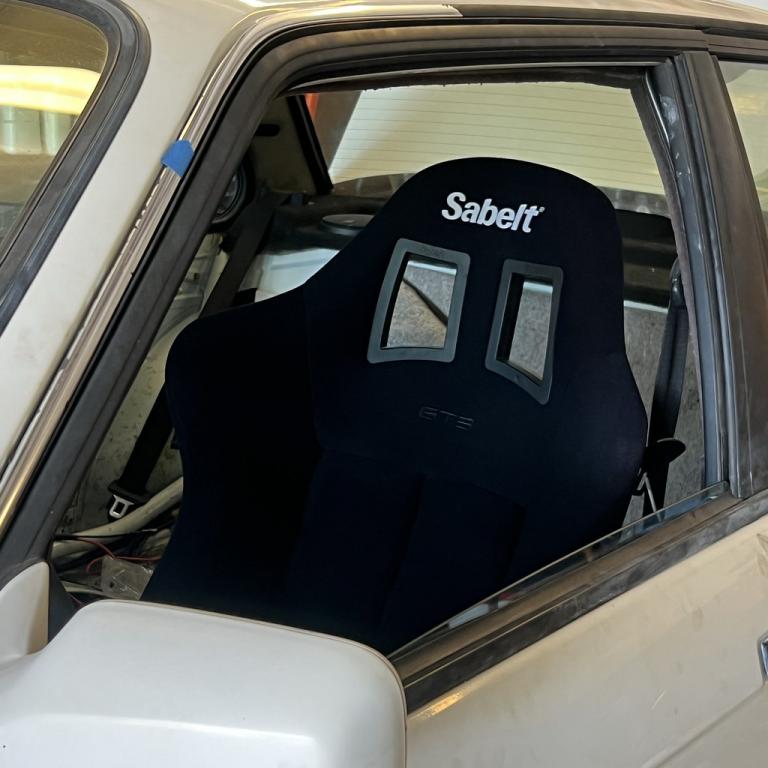

                              But on a slightly more positive note, I did put it all the way on the ground again, with the seat in the car so I can at least pretend it moves...
