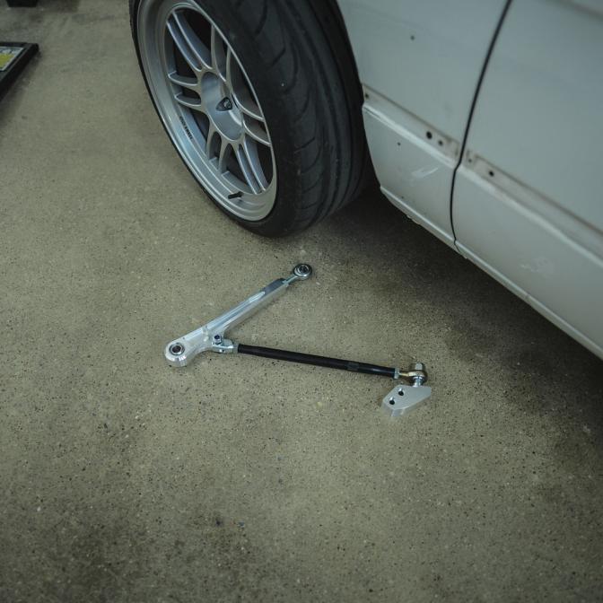

                              Back to work
                              Right before the control arms were ordered and delivered, my boss got his Harlekin Polo from Belgium picked up from the port in Galveston and the E30 got kicked off the lift and on to quick jacks in the corner so the Polo could have a quick little week and a half makeover before Eurodistrict. (Ill throw up a photo of it at the end)
                              Not that I was in a huge hurry to get them, the AKG DTM style control arms showed up super quick. Quality seems to be top notch and the install was as simple as it gets. Getting it properly aligned will need a bit more work since I've got about a 1/4 toe in on each side just eyeballing with a tape measure. While they work like they should, and made the car to where I can turn lock to lock now... I don't love the angles I've got going on. Castor is probably in the mid to high teens ( I can adjust more with the castor plate but it will require notching the strut tower) the tie rods are extended a lot and angled towards the front of the car quite a bit with not a lot of room left to adjust. So regardless, I'm probably still going to have to do some work to get more clearance at the back of the footwell. All good with me since its the safest way to make it work and have the best alignment.
                              But all in all they were a good purchase. I can adjust from every direction now, and I've added an inch of track width up front!
                              Now back to sideskirts and filling holes...
