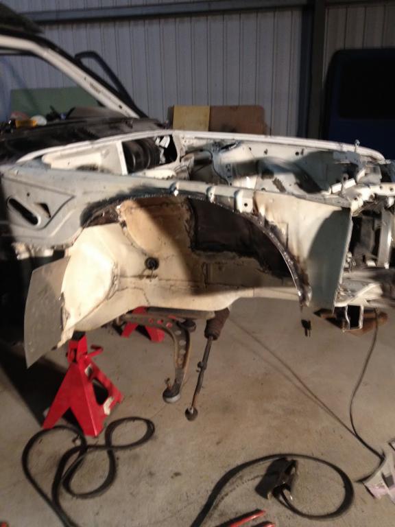

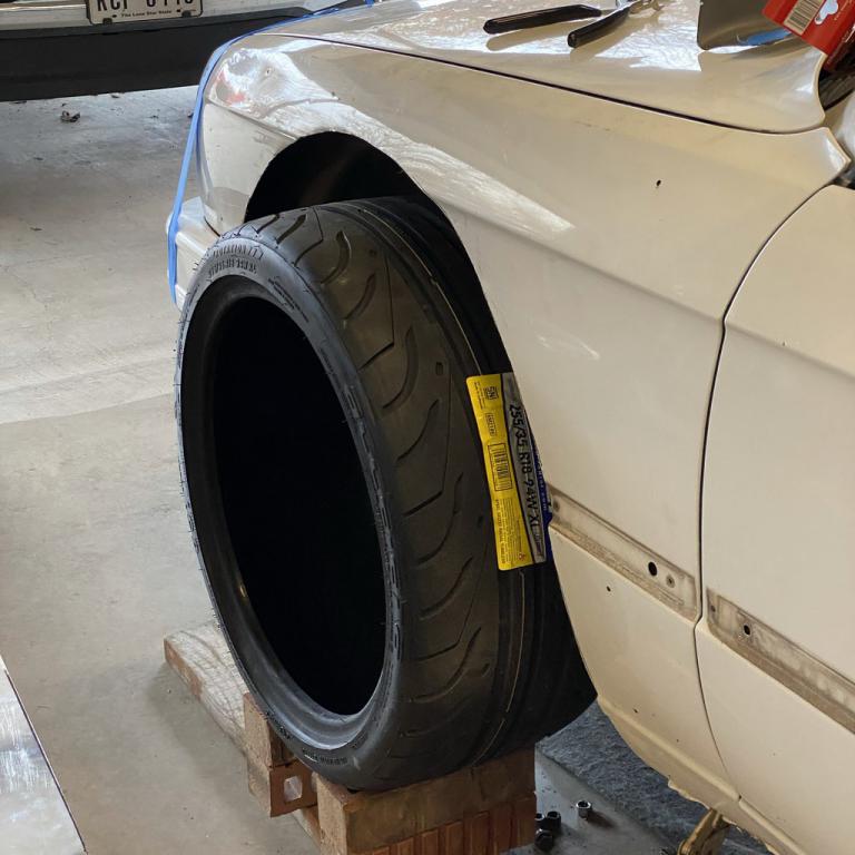

    I spent my Sunday ruining the resale value of my E30. Only cursed at it a couple of times... Lots of cleaning up and welding to do in the rear, and I'm definitely not looking forward to doing it again on the passenger side... But here's how it should sit! This was the most significant part of the build so far and Its nowhere close to being a finished ordeal. I want it to all be as correct as my skills will allow before it leaves this shop.
    Also installed my Spal fan, and figured out how to get the Split second AFR controller piggyback out of my car finally so I can install my Megasquirt and get it going again.

          There is lot of work to do to make big tires turn freely. Front is the problematic side. It is something like 235/40-17 which is max size before it's going to be hell.
          If you want to go bigger, it just requires cutting off the wheel wells and make bigger ones. Plus you need then tubular control arms or similar to relocate tires forward.

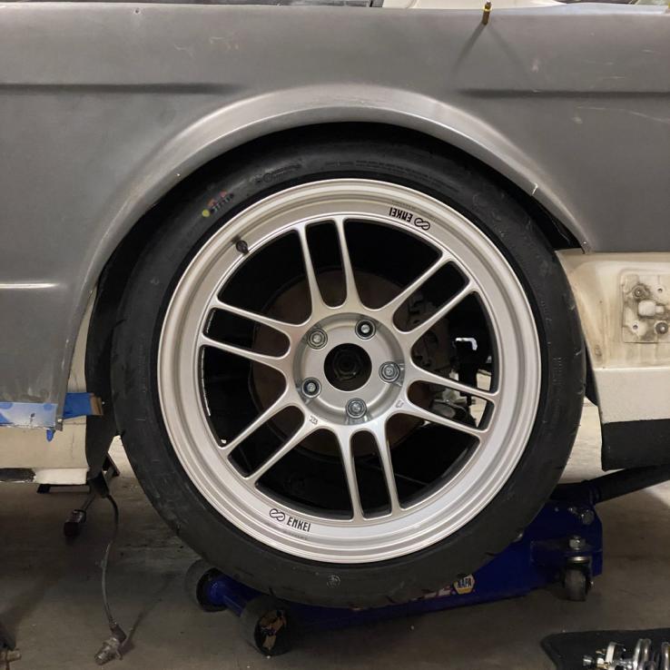

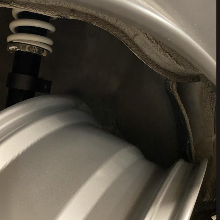

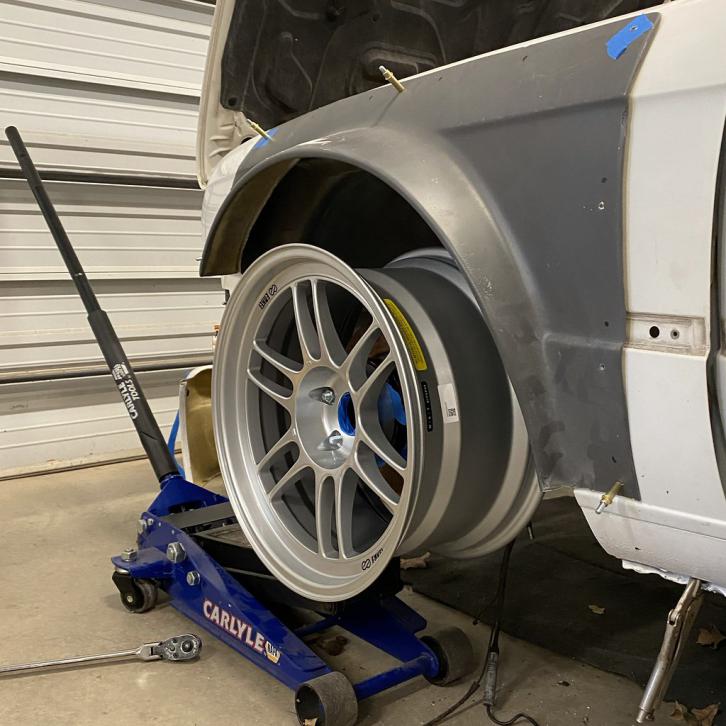

              Finally going to test fit a wheel up front today to see what my clearances look like without the tire mounted. Enkei RPF1 18x9.5 et 15. it will have a 1" adapter spacer to go from 5x120 to 5x114.3. Still may not be aggressive enough of an offset though. Might have to step down to ET 0

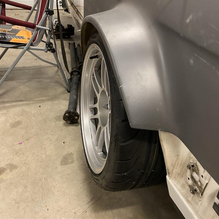

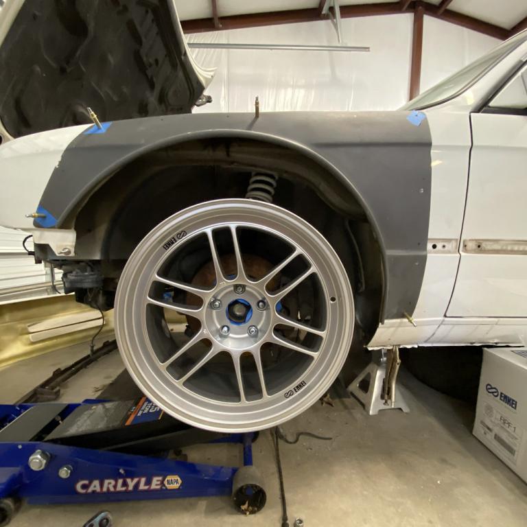

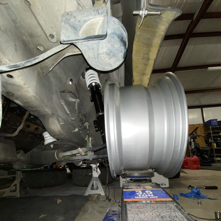

                Went ahead and test-fitted the single wheel I got for the front of the car this weekend! offset and width are perfect, all I need now is a lot of castor adjustment to move the wheel forward to not hit the rear of the wheel well and see what needs trimming in the front. I feel good about the front end now, so I'm going to get the rear end all ready for 5 lug and then see how this wheel fits to make sure all my math for the larger wheel's clearances are good!

                  I did similar to my E30 a couple weeks ago, used E38 wheels/tires for fitment since they're so large. I'm doing a Rocket Bunny kit on my build.
                  Was able to get these massive chonkers swinging with only minor interference on the drivers side at full left lock. Probably can tweak that some with caster adjustment.

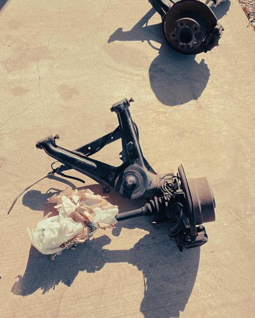

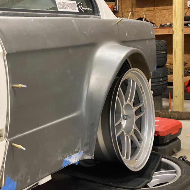

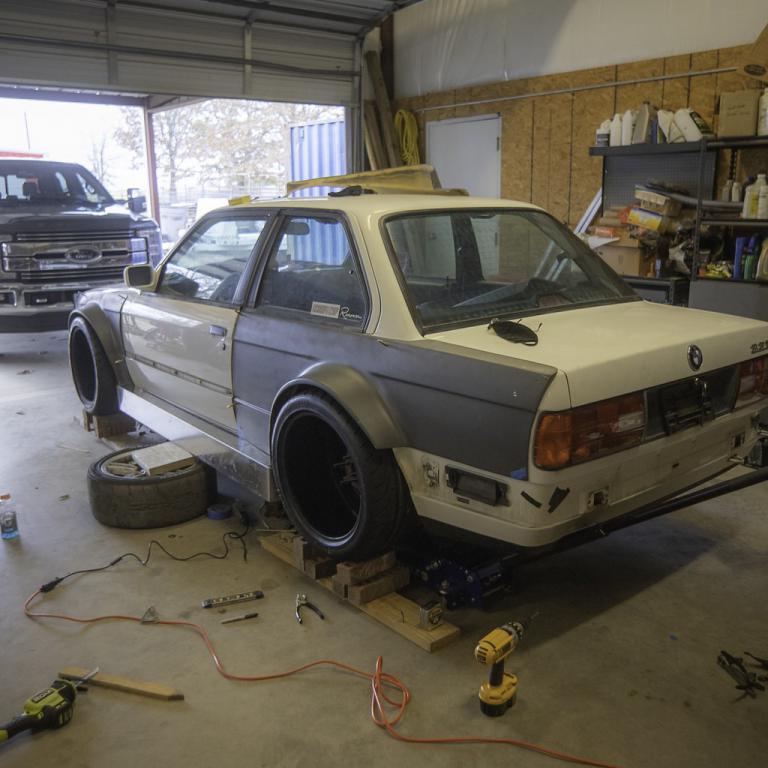

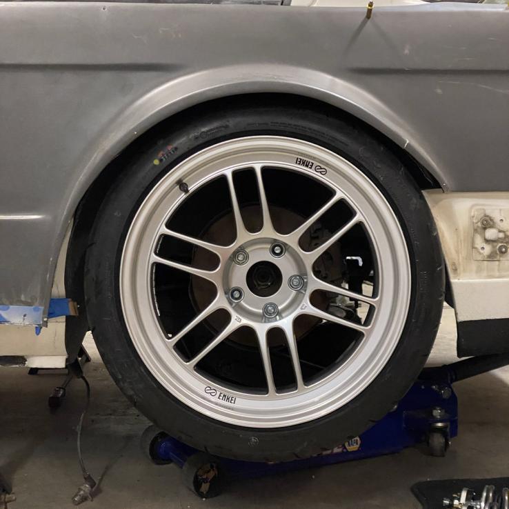

                                It's been way too long since I've posted here, and there is a lot to update!
                                Since my last post, I've gone ahead and swapped my 2.8l Z3 rear trailing arms, axles, and brakes onto my e30 to make up for some offset so I don't have to use stupid spec spacers. This was one of my biggest hold-ups for a while. Not the most cost-effective way to do a 5 lug swap but the best way to do it to fill out the widebody.
                                Now on to my favorite part, suspension and wheels and all that good stuff that can make or break a car.
                                Since I had squared away the wheel I needed for the front, I decided to throw it on the back of the car since the 5 lug stuff was on just to see if any of my math was correct and if the Z3 assemblies would get me in the ballpark for what I was looking for. The front setup I decided on was a 18x9.5 et15 RPF1 with a 1" adapter spacer to convert to 5x114.3. In the rear, my goal was to go up to a 18x10.5 et15 with the same spacer setup but i wasn't sure how that was going to turn out.
                                So here was the front wheel test fitted for the rear to give me some measurements and the confidence to buy the wider wheel.

                                I ended up having about an inch of clearance where my "ballpark" ride height would hopefully be.

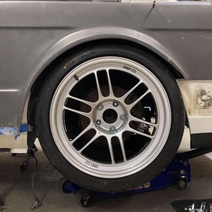

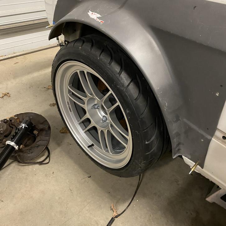

                                So I went ahead and ordered my wider rear wheel, and while I waited I got a tire mounted for the front to see how that worked with rubber!

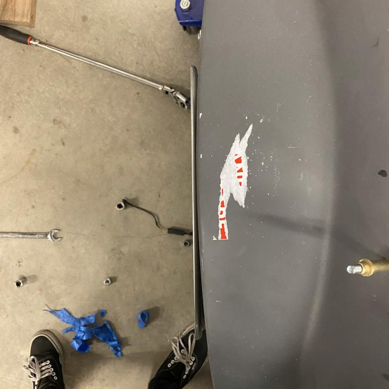

                                With camber, castor correction, and a ride height adjustment the front is going to be perfect. I threw this wheel on the back just to measure one more time before the rear wheel came in and it made me a little nervous about going up a whole inch in width and from a 255 to a 285. Click image for larger version
