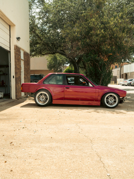

            #80
            finished wrapping the car, aside from the front bumper and mirrors! Ill make a more detailed post about why, but I had to push it out of the shop just to get some pics of it in the sun today, this color looks so good!

            • Northern
              I like cupcakes & sh!tboxes
              • 5284
              #81
              Ah you weren't lying about updates. Wrap/colour choice look great! What brand did you use?

                #82
                haha there has definitely been a lot of progress, but I've been bad about updating stuff recently. But thank you! I wanted it to be white for a cleaner look but this will definitely get some attention. This is what i get for letting my coworkers vote lol.
                Im actually not sure, Inozatek was what i was going to use, but the shop it was ordered through suggested their new brand that is "better", I call BS though lol. It does look great though, just hard to use, just like Inozatek haha.
                10/10 will not be wrapping this car ever again lol
