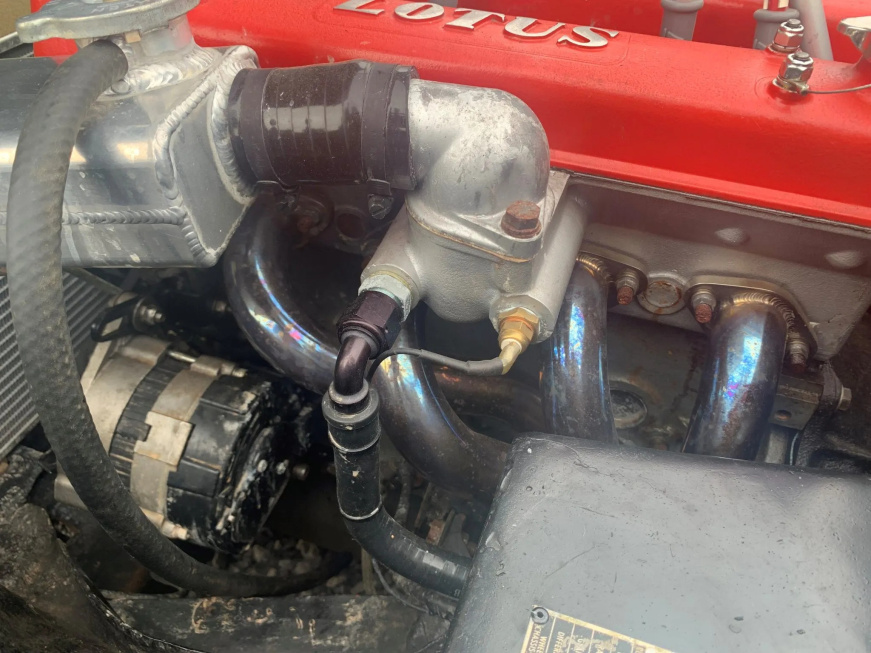

              Alright folks, the plan is starting to come together. This is the ultimate side-quest derailment project that I wasnt planning on doing yet, but here we are...
              I know I need to figure out where to adapt some sensors. QED is supplying the toothed crank pulley along with the Ford crank position sensor and a few other bits. My current headscratcher is the coolant temp sensor. Initially my idea was to tap into the thermostat housing, but it seems like I might be asking too much from this. My plan was to use the sensor location and instead of a single wire, to replace it with a 3-wire sensor so two can be used for the incoming ECU and the third for the gauge. Still exploring this, but it also seems like the thread would need to be re-tapped and that makes it sort or irreversible...​
Name:	Thermostat Housing.jpg

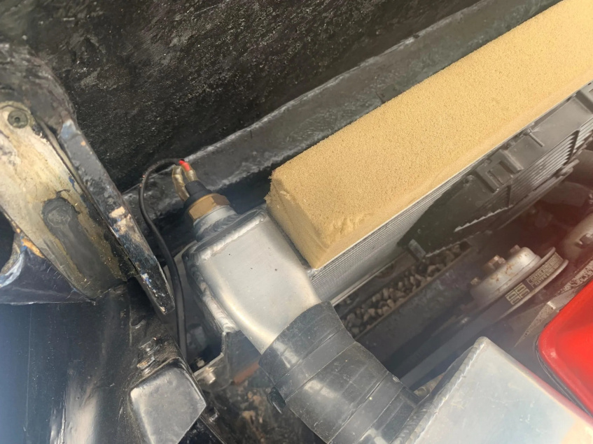

              Then I recently had a moment where I saw that the radiator also has a sensor on it and now I'm wondering 2 things... (1) Where is the gauge getting is info from and, (2) Is this a better place to accomplish my goal?

              Any ideas/ suggestions are appreciated. The UK (re)builder did a great job of keeping the engine bay clean and tidy so I want to keep this going

                The cylinder head will give you a more accurate engine temp reading, the radiator will be cooler. I think the EFI sensor should go into the head, and the gauge sensor will be okay from the radiator. Yes the gauge will likely real a little cooler than the actual temp, but if you reverse things, I could see the EFI running a little on the rich side because its reading that the engine is cooler.

                  Agree that the head is best. Either find a sensor that fits (maybe a 2-wire to the ECU and have the ECU spit out the gauge signal, depending on ECU)
                  Or make a spacer for the Tstat housing to move it up, with a bung below. Might even be able to find a cheap OTS one that fits.
                  Bleeding issues TBD...
                  Is there an aux fan? Looks like the one on the rad is a fan switch
