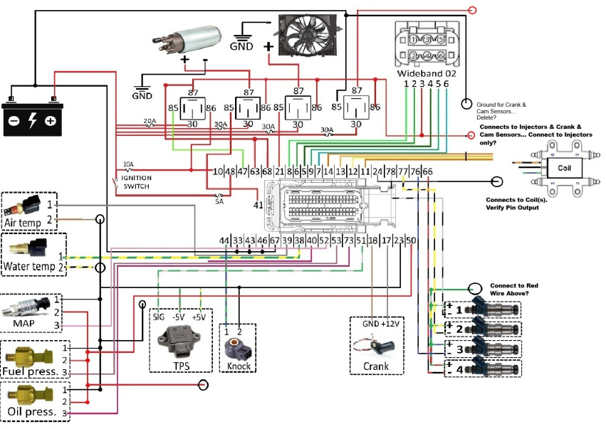

          I NEED HELP! When it comes to wiring from scratch I'm a bit clueless. I've tried to do a good job of identifying what goes where and setting up the harness. Im not crimping anything until I have it finalized. My plan has been to use a Ford Focus engine wiring harness to try and 'simplify' things and have existing connectors that would allow easily replaceable sensors. Some of this is not proving to be reality. The coilpack is a plug & play, but the injectors had different plugs and so far most of the sensors have also.
          So I have 2 requests for the few of you you still here that have done Standalone conversions, or even those who can sleuth better than I can:
          (1) Trying to get my hands on the OEM Wiring Diagram to cross reference the way Ford had it routed. This is the only label I have to identify the harness
          (2) One headscratcher has been the way they have routed the injectors. 2 wires to each plug, a ground then a green/color wire that then gets routed & bridged to a single green which is part of a 4 wire plug.

            Are they just ground switched? What Focus is it out of

              Going off that part number on the harness... I'm getting 2000-2002 Ford Focus LX... SOHC CVH engine... not the DOHC Zetec

                This is the AEM Wiring Diagram that I've gotten. Obviously it has a few extras but going based off of this it appears I can use that bridged wire but mine wont have a Cam Sensor, and my Crank sensor only has 2 wires...
                I'm a bit frustrated with myself for NOT just buying the QED Injection system because I was determined to buy the Jenvey Heritage ITBs.
                https://qedmotorsport.co.uk/product/fuel-injection/
                I've sent repeated messages to QED to see if I can just buy their wiring harness and the ECU as I already have purchased all the other accessories I need.

                  If searching isn't getting you the wiring diagrams you need, break out the multimeter and make your own. It really doesn't take that long with the harness out of the car. The injector wiring looks pretty ordinary to me, common +12V and ECU switching ground. The position sensors in that generic AEM diagram are hall effect and a two wire crank position sensor would be of the reluctance type. Feel free to reach out to me directly with wiring/standalone/tuning questions.

                    Im dangerous when it comes to electrical work!... Many have failed to try and teach me diagnosing basic electrical gremlins, however I agree that with the harness out of the car there is a limited amount of damage that I can cause. Shoot me your # via PM and I will begin the harassment lol

                      I have made some very minor progress. I am still actively trying to make a wiring diagram, but slowly trudging along...
                      This is the fuel injector harness:
                      Before:
                      After:
                      I will also be routing the Throttle Position Sensor, Intake Air Temp Sensor, the Crank Position Sensor, Ignition Coil Pack wiring all through this as well.

                                Surely you didn't give up on that DIY harness?
