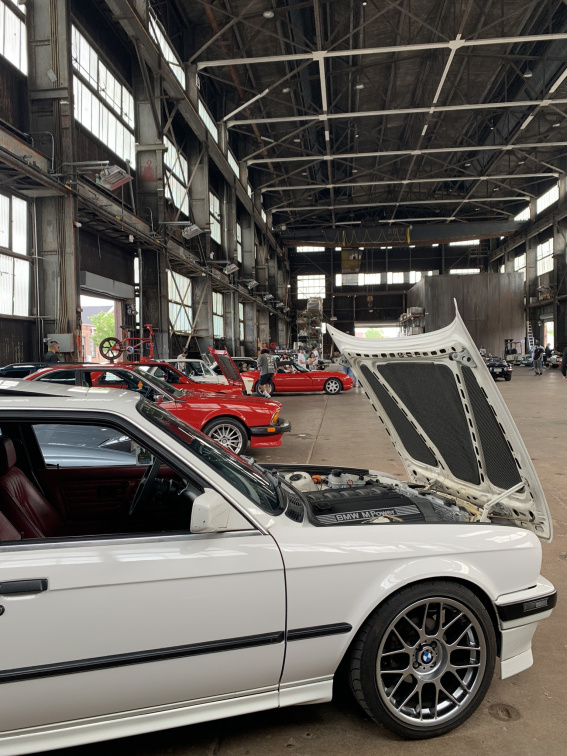

    Drove around as is for a bit. Wasn't into the wheels at all. So I got some arc 8s. Lot of people don't like 17s on e30s which I tend to agree with, but I think they work better on a 4dr. Also after installing skirts and paint matching the front lip I think it filled out well.
    Click image for larger version  Name:	IMG_4483.jpg Views:	0 Size:	197.9 KB ID:	10149995
    Click image for larger version  Name:	IMG_6148.jpg Views:	0 Size:	207.2 KB ID:	10149996
    I also picked up this rep m3 style spoiler which I thought would kind of even out the whole look between the skirts and big wheels.
    Click image for larger version  Name:	IMG_8868.jpg Views:	0 Size:	216.5 KB ID:	10149997
    Got some semi-janky exhaust work done. Does the job but I want it to be much cleaner. It sounds great though. Some mystery headers up front, vibrant ultra quiet resonator and muffler at the back. 2.5" piping and the tips I think are 3".
    Click image for larger version  Name:	IMG_4325.jpg Views:	0 Size:	217.0 KB ID:	10149998

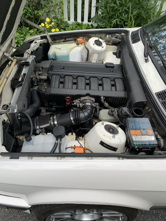

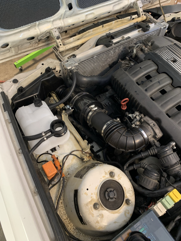

    I wanted to clean up the bay. The PO had a mishimoto expansion tank that was just held in with zip ties, so I opted to go with the oem late model expansion tank. There was also a crummy autozone intake setup, which I swapped with a KAmotors kit. Lastly I added m3 firewall covers and removed a bunch of extra, unneeded wiring. This harness was from an automatic e36 so there was a whole section for the trans computer. I remember being super intimidated to do this.. it was my first "big project" on the car, lol. I've come a long way.
    Click image for larger version  Name:	IMG_4611.jpg Views:	0 Size:	215.6 KB ID:	10149999

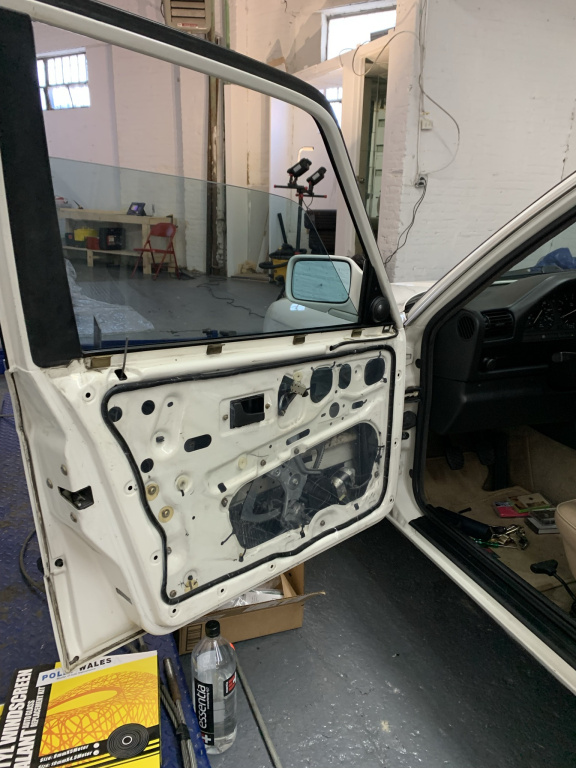

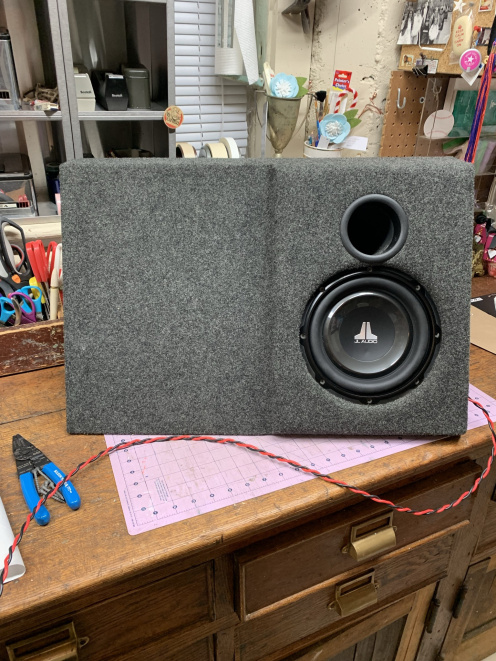

      Picked up this 8" lukebox from a forum member for free. Great grab. Sorted out the rest of the audio setup.. bmw-radios reverse RDS, some JL tweeters and infinity REF-5032 speakers which fit into all the original stuff.

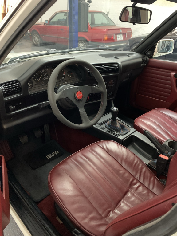

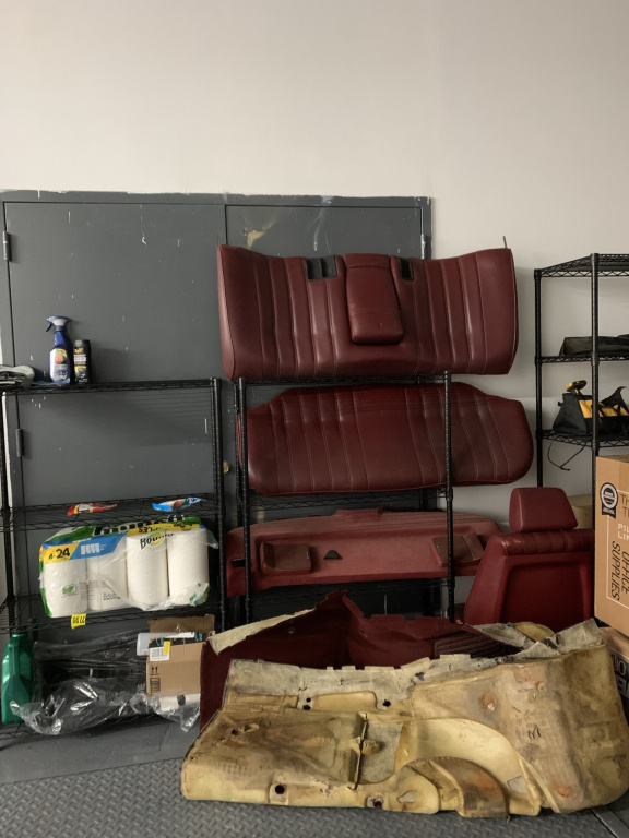

      Then I picked up this crimson red (1991) interior, which I thought was pretty cool and would make the car unique, plus it matched the year and everything. Replaced crusty vapor barriers and put kilmat everywhere.

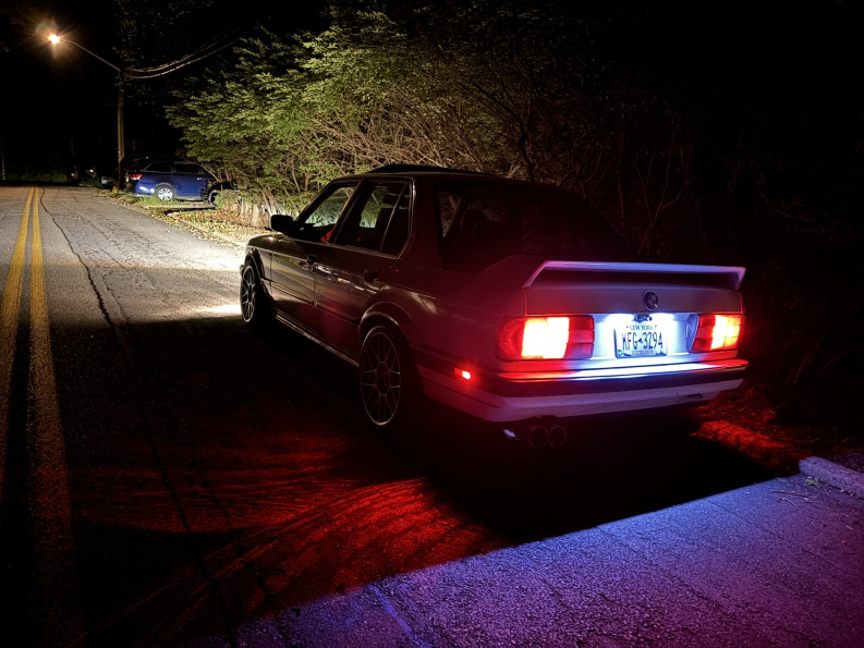

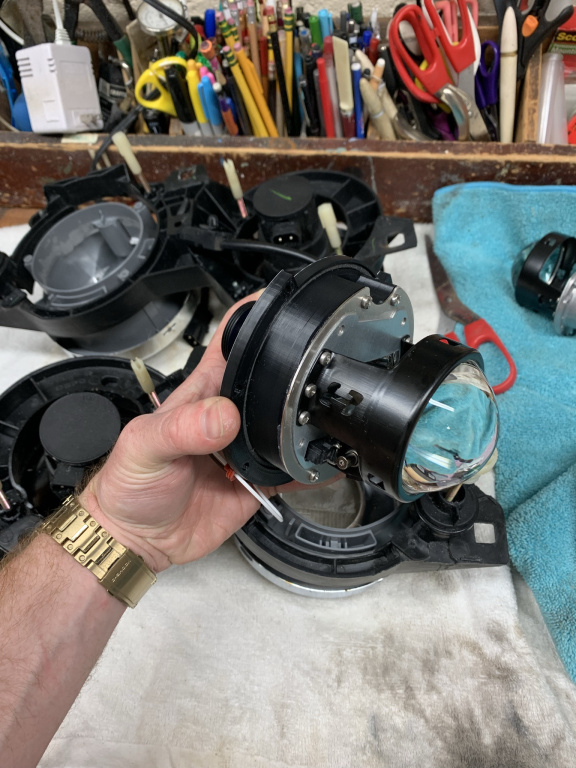

        Dailying an E30 means you get caught out in the dark, in the rain. Old lighting just wasn't cutting it, so I installed the esgprints HID adapter kit. Huge difference.

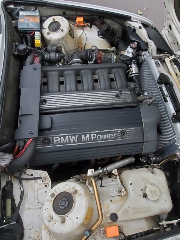

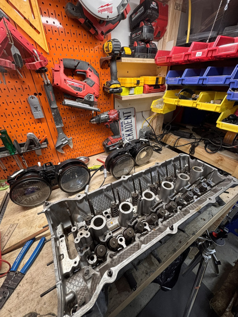

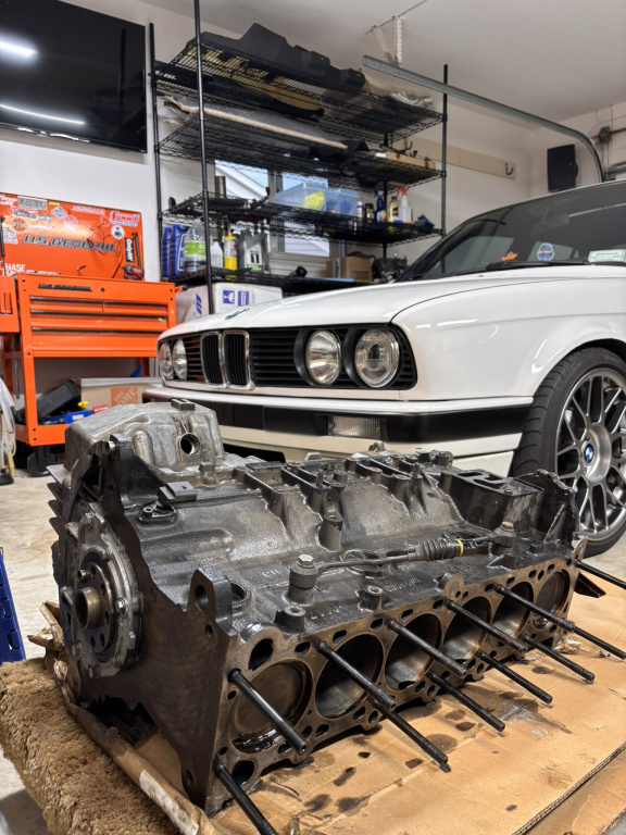

            All right! With that out of the way, we are caught up to present day. Yesterday I picked up this S52.
            Plan is as follows..
            - Bore to 87mm (or less depending on what the machine shop says)
            - CP pistons 11:1
            - Rod bearings
            - Main bearings
            - Timing chains, rails, tensioners
            - All new gaskets
            - Oil pump nut
            - Vanos rebuild
            - Shrick 264/256 cams
            - Supertech valves + springs
            Keep in mind I have never built a motor before. Open to any and all advice. Probably gonna need some special tools.
            Oh and I'm likely going to go standalone, most likely Link.

                  Car looks great as it is, really. If the paint isn't destroyed and just dented, I think some PDR would fix it.
                  I think it's worth looking into the Schrick 276/264 or whatever the next step hotter is from the 264/256. Off the top of my head, I don't think it harms drivability but not sure what other supporting mods they need vs the 264/256

                    • 4636
                    Cool thread and lots of progress!
                    What are your power estimates for the rebuilt engine?
                    • DEV0 E30

                      • grandeswag
                        • Oct 2020
                        • 151
                        There's definitely been some shoddy bodywork by the driver side rear fender. I'm fairly sure it was repainted there. But yeah, agreed a bit of PDR would go a long way on the car. It's a driver at the end of the day. Doesn't need to be perfect.
                        Ah interesting. At first glance it seems like more of a race application, I'll definitely do some research.
                        I'd guess around 250 at the wheels. Will get it at the machine shop soon, so I'll have a better idea of how much boring will be required.
                        Originally posted by DEV0 E30
                        Great work.
                        Thanks! I know the engine progress will be a bit slow. I'll start with a VANOS rebuild to stay busy for a day lol.
                        https://www.youtube.com/@DekadentGarage
                        • McGyver
                          • 4636
                          Originally posted by grandeswag
                          I'd guess around 250 at the wheels. Will it at the machine shop soon, so I'll have a better idea of how much boring will be required.
                          Wow, I would have expected more. But I guess the stock bore is 86.7mm so 87mm is essentially a stock diameter, and the stock CR is 10.5:1 so going to 11:1 doesn't gain a ton. Going from 240 crank to 250 wheel is a decent jump though.
                          If you're going to machine it, are there options for getting more bore or stroke? Or was the s52 taking the m52 to the machinable limit?
                          • grandeswag
                            • Oct 2020
                            • 151
                            Just being conservative. I know there was an s52 at Kassel recently that dyno'd at 260 with just the cams and supporting mods. So maybe 265!
                            I think it's possible to go up to 87.5. But 87 is the "max safe bore". S52 is just a bored m52 with a bigger stroke. Also, I've never built a motor before so you're not exactly asking a knowledgeable person lol.
                            • McGyver
                              • 4636
                              Makes sense that BMW pushed the m52 to the reliability limit when developing the s52. Still, 250-265hp at the wheels will be a riot!
