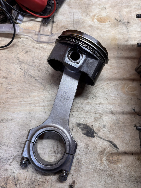

      Found a little bonus today when removing a piston to inspect.
      Eagle rods! Wasn't planning on upgrading from stock rods so this is certainly great news.
      Also got a good look at the piston - MAHLE 930024709, which are 86.6mm. The guy that sold it to me works at a shop, said that someone brought in an e36 that was recently rebuilt by a different shop. He said "the bore was rough, so it was smoking" so the customer wanted it rebuilt again, but by his shop instead. He ended up just installing a used good motor for the guy because of a time crunch.
      I guess this confirms it was bored to 86.6, but maybe they did a bad job? We'll see what my machine shop says and hopefully they'll be able to do 87 without issue.

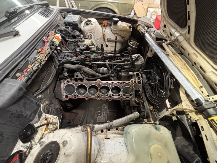

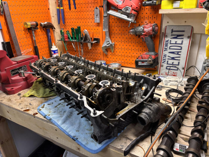

                Slight curveball update.. turns out the head is cracked. Need to pull the existing head now, which I have no reason to believe is bad. But we'll see lol. Pistons have arrived at the shop for sizing!
                https://www.youtube.com/@DekadentGarage
                • grandeswag
                  • Oct 2020
                  • 151

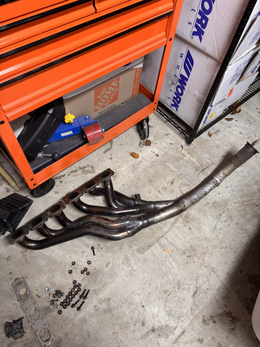

                  S50 head is out! Went pretty smooth aside from the headers, what an absolute pain. Had to lift the motor via support bar, drop the subframe and lift the chassis for maximum clearance.

                  Gotta haul it over to the shop now.

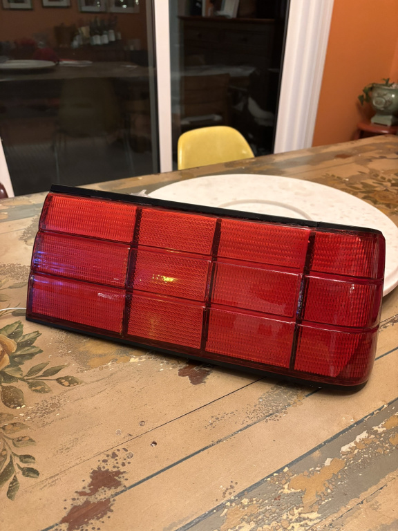

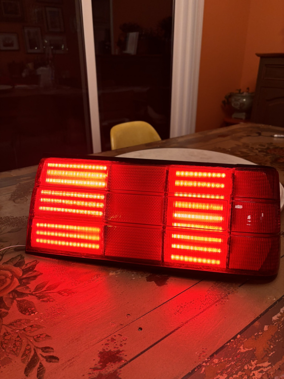

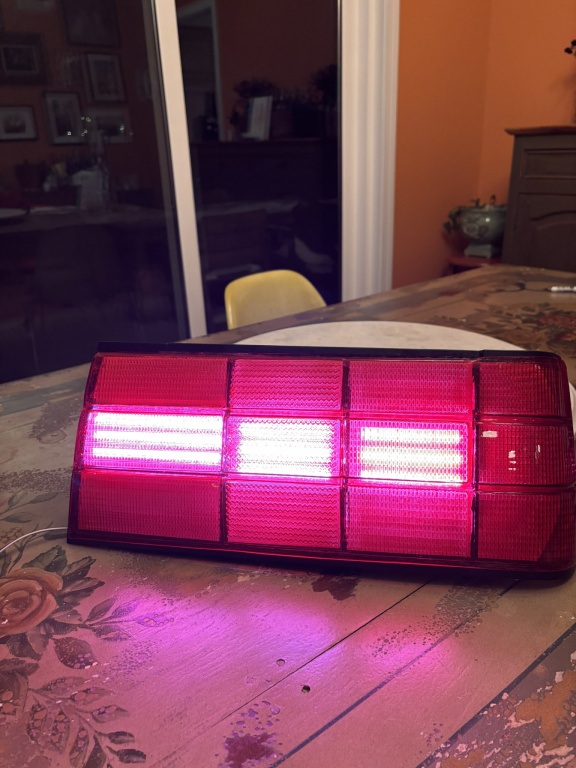

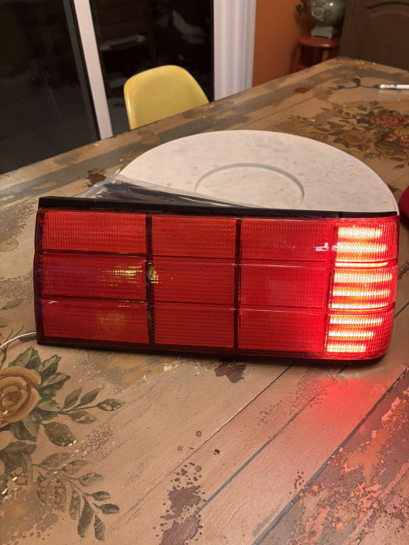

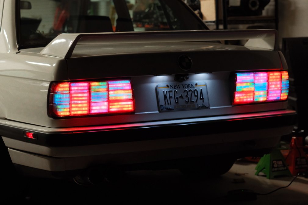

                        In the meantime I've been working on a kind of silly, but fun taillight project. I designed and 3d printed some brackets that hold led strips for a total of 417 WS2812B LEDs per side. It's possible to fit more, but the controller I'm using is limited to 425 per channel. I opted to use an off the shelf controller from ghoztlighting, but it could be done with an arduino or whatever..figured I would just save the trouble on the programming side of things. The controller has inputs for parking, brake, reverse and turns signals. It also has a bunch of animations baked in that can be programmed on the fly via their app.

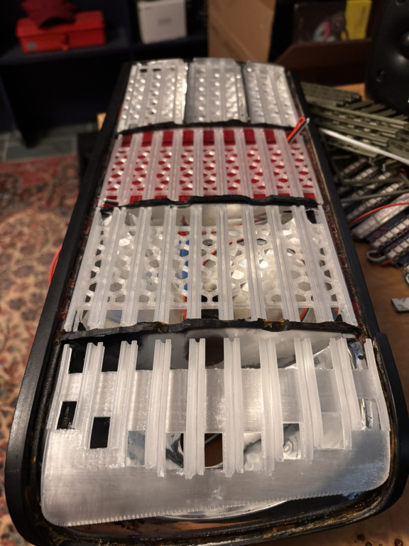

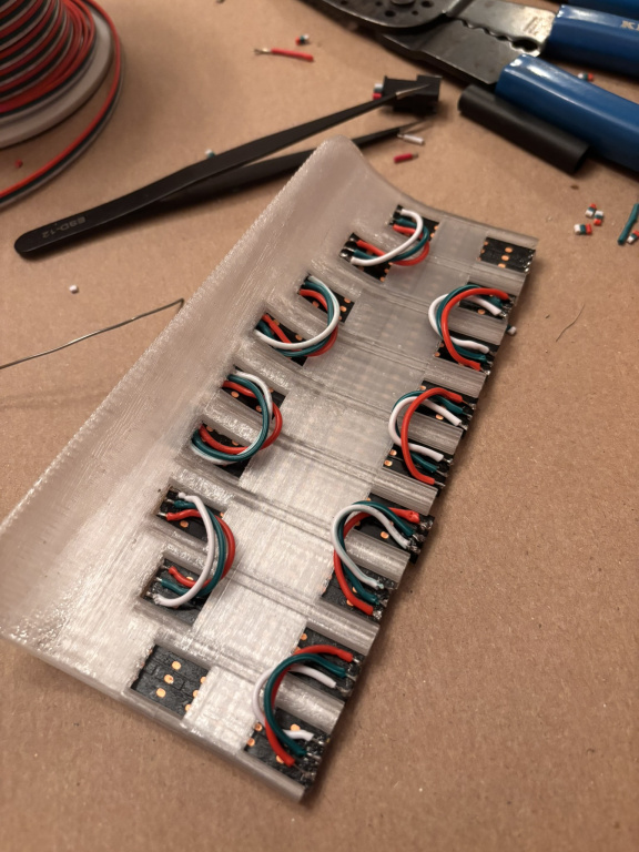

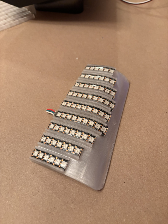

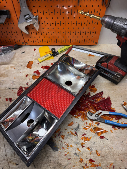

                          A peek under the lens.. Lot of soldering required!

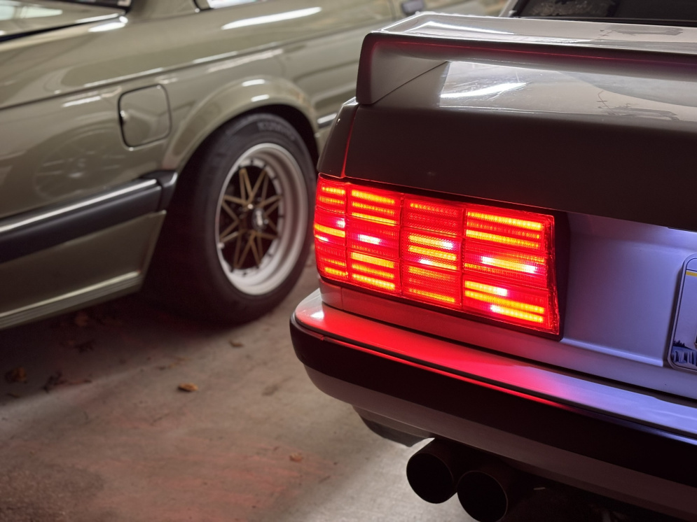

                            Man this was an unbelievable amount of work...
