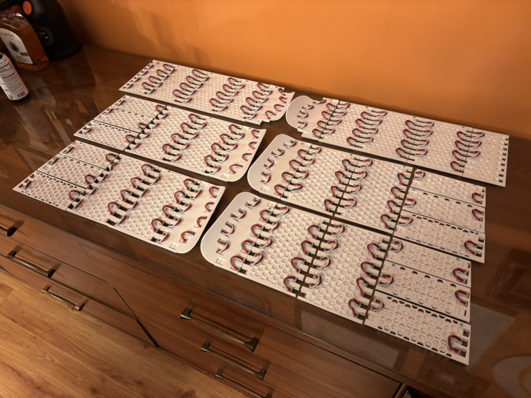

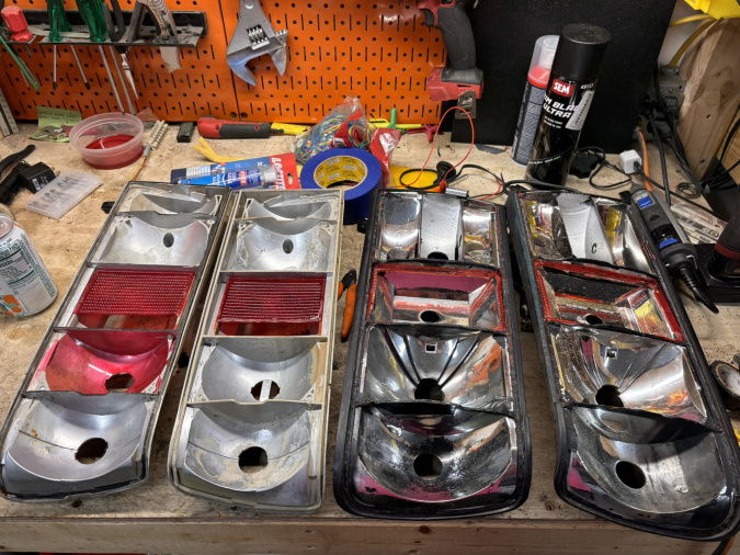

        Been busy building matrix tails for a couple customers.. got early models in the mix now too. Warm weather finally approaching and I will get back on the motor build!

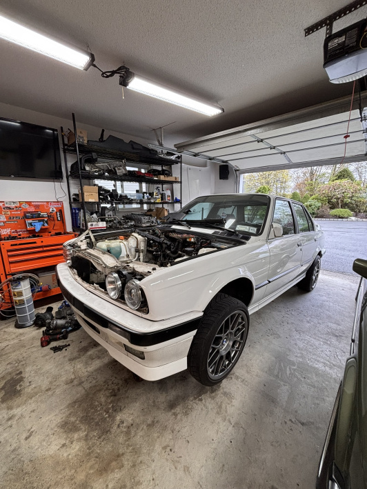

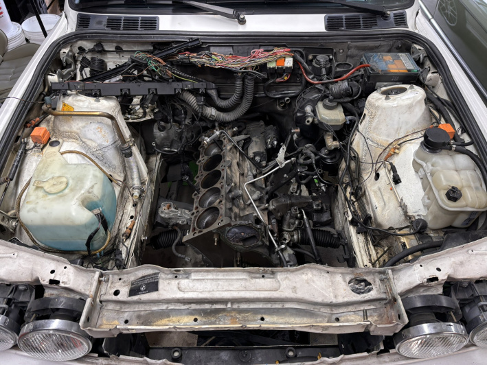

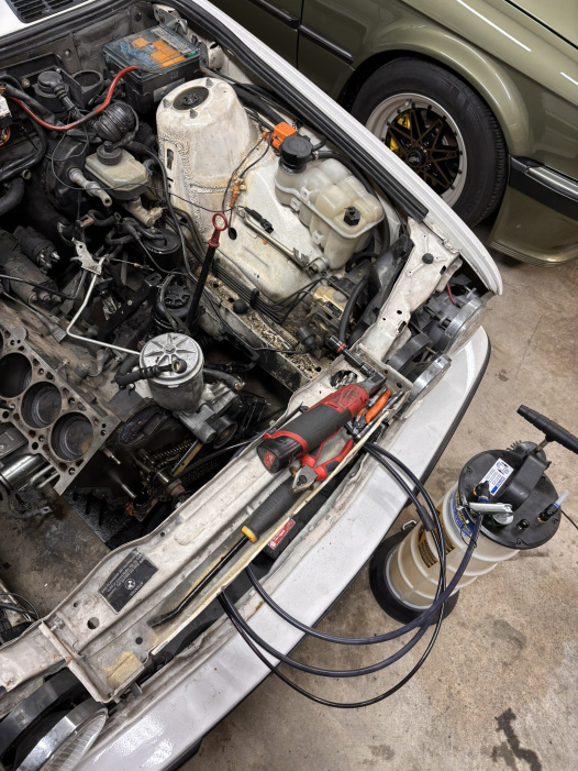

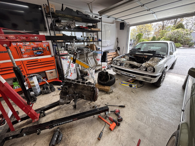

              Cleaned up the garage this weekend then made a big mess. Hung the hood on the wall and got to work.
              Removed:
              - AC components
              - PS components
              - Exhaust
              - Driveshaft
              - Shift linkage
              Disconnected all wiring and plumbing.
              All prepped to pull the old s50, then I can replace the trans detents, harvest the oil pump and whatever else is needed to get the s52 going. Currently waiting on my Harper oil pan too.

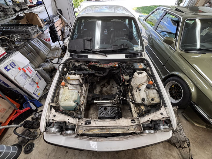

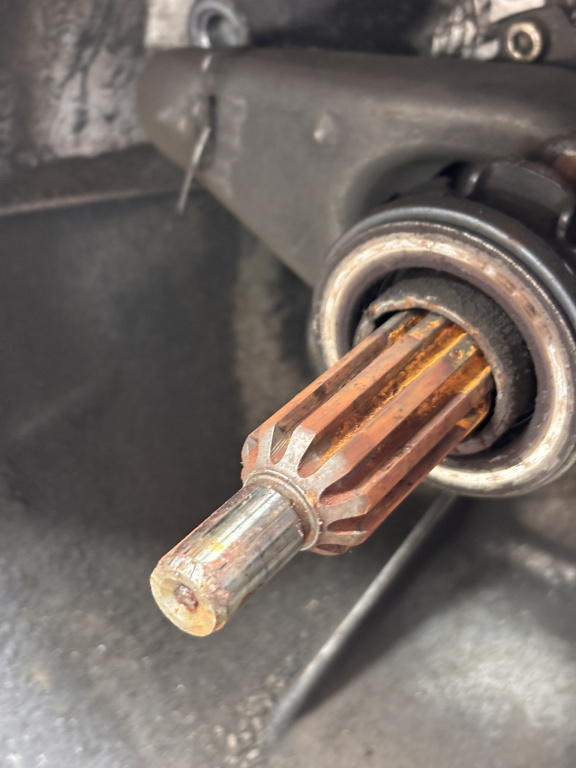

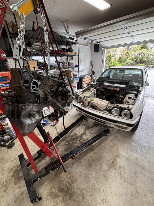

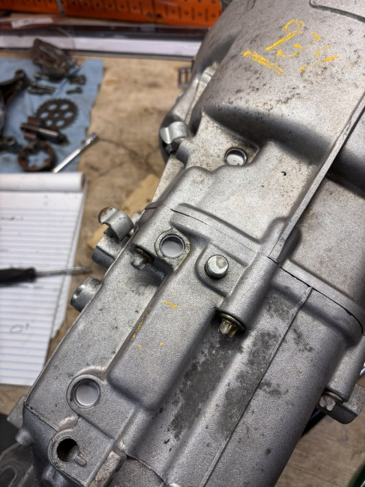

                S50 is out! Separated the ZF as well.. put up quite the fight. Ordered the detent parts as well, aside from the reverse pin. Guess that thing is NLA and next to impossible to find now. Can't believe the 5th gear pin is $120!! I only had an issue with 5th gear lean, so I think I can live without changing out reverse anyway.

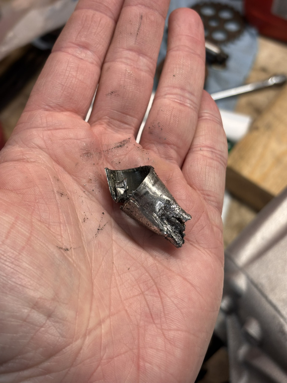

                        Detents for 1-3 and 5 have been replaced. Man what a pain to remove that bushing!

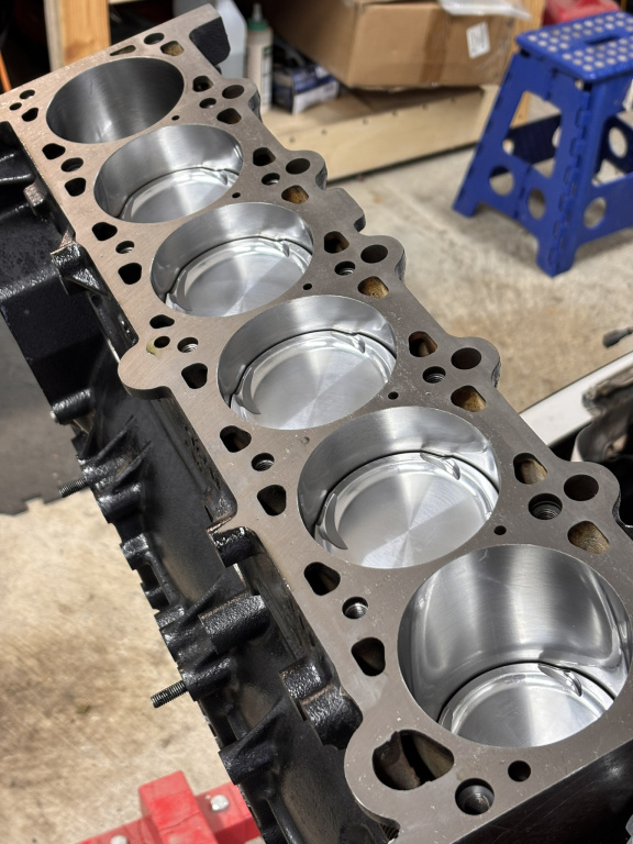

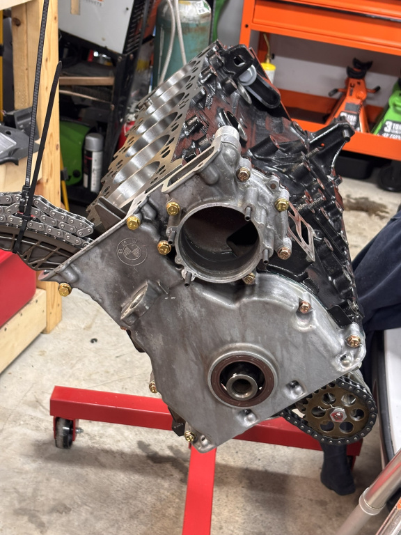

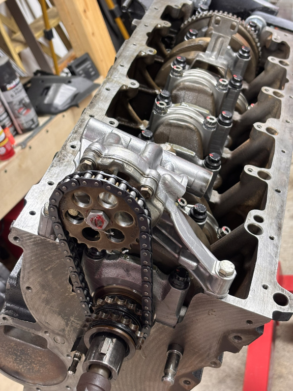

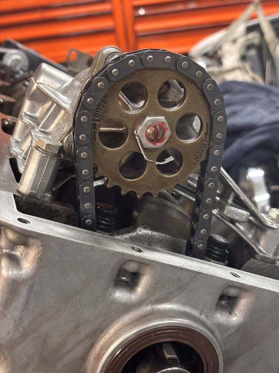

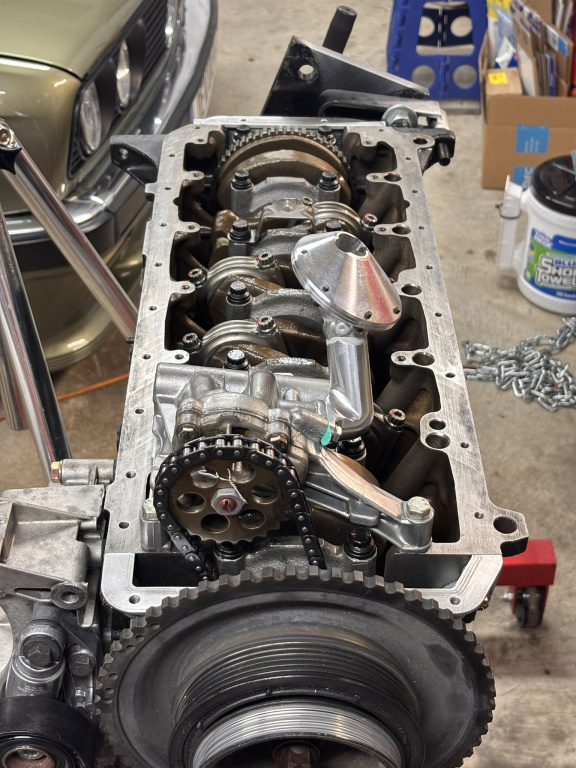

                          Oil pump refreshed - cleaned, replaced plunger spring, retaining cap, o ring and c clip. Red loctite, torqued to spec and safety wired! New chain as well.
                          Click image for larger version  Name:	IMG_3713.jpg Views:	0 Size:	222.4 KB ID:	10162712
                          New chain guides, chain, crank seal. 3D printed a nice little jig that replicates the BMW press tool. Got another printed for the rear main as well for later.
                          ARP hardware installed and torqued. Bit tricky to do this with my left hand lol

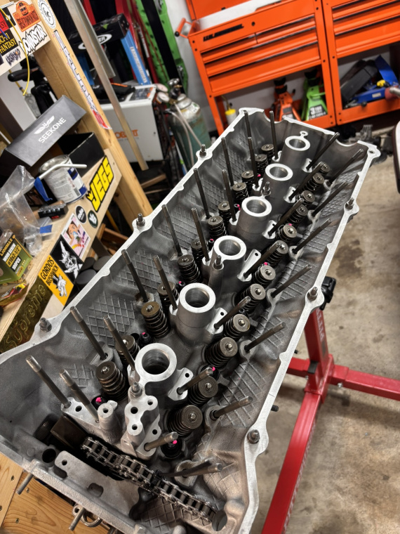

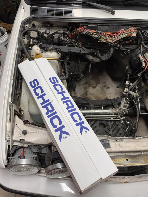

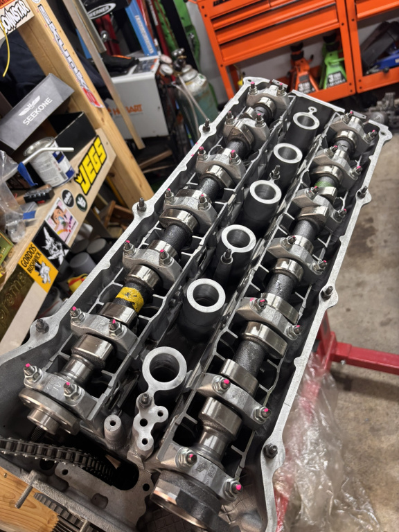

                          Schrick cams in, everything set to TDC. Getting ready to install the timing components and VANOS, that will be next.

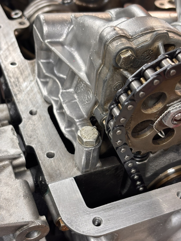

                            Alrighty got the pickup tube installed, only to learn that the pump needed to be clearanced to fit the harper pan.. so I removed the pump, grinded it down and then reinstalled everything.
                            Click image for larger version  Name:	IMG_4004.jpg Views:	0 Size:	232.8 KB ID:	10163105 Click image for larger version  Name:	IMG_4013.jpg Views:	0 Size:	204.9 KB ID:	10163106

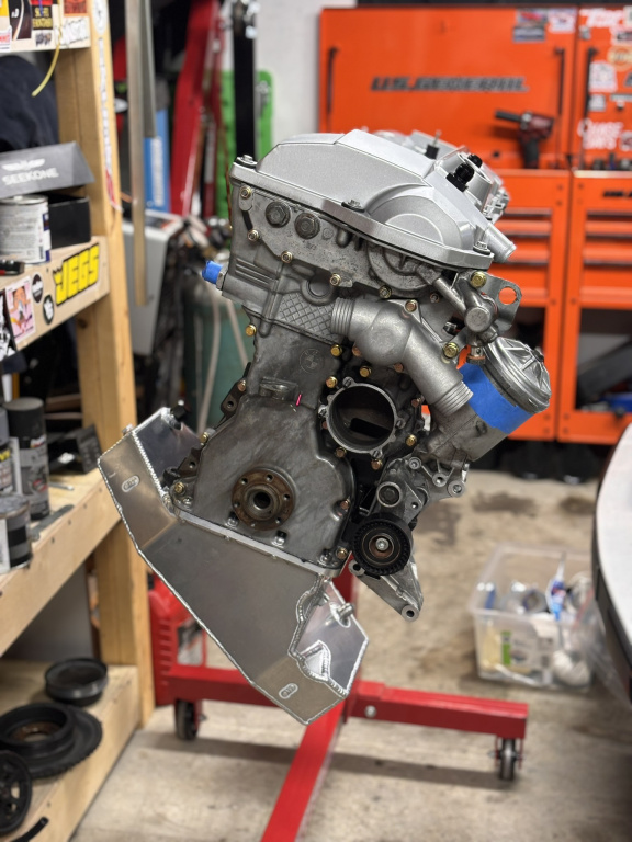

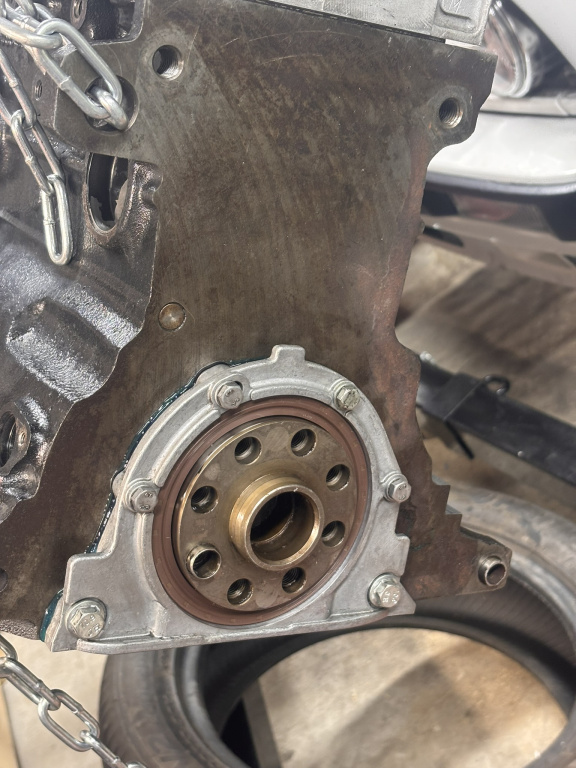

                            Rear main installed, metal gasket supplemented with Curil-T. Also removed the old pilot bearing using shop towels and hammer. Used black 90 minute RTV on the block (no gasket) and fitted up the pan. In the home stretch here, but need to purchase various accessories still. Water pump should be arriving today, but I want a new alternator, starter, belts, etc. Also still need to get flywheel and clutch.

                            Oh and obviously I finished up the top end. Vanos installed, checked timing and all that jazz.

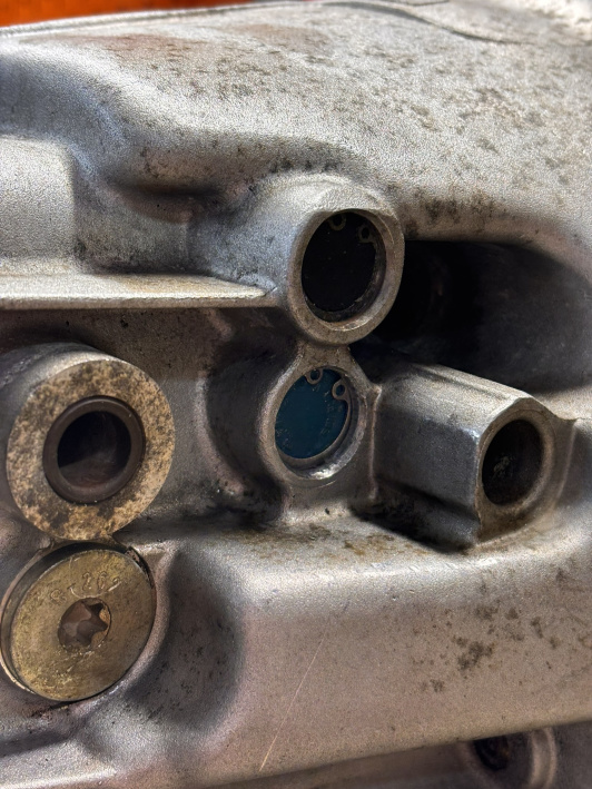

                              Kind of curious, I resealed the timing cover on my S50 and pulled the chain tensioner for the Vanos and pulled the gear. After the reseal I kind of just put everything back together without checking to see if I needed to clock the Vanos system at all. Did you have to do anything of the sort? I'm still in the middle of my swap so I have not ran the engine at all.

                                What Schricks are those?
