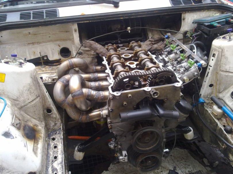

Better pics and such when I have time, busy preparing it for the Mattara Hillclimb this October long weekend. I am running in the club day event on the Monday because all my mates are but anyway.
So Basic Specs:
BMW M42 (1.8L 4 Cylinder)
CP Pistons
ARP Rod Bolts, Main Studs, Oversize Headstuds
O-ringed Head and Block, Copper Headgasket
Cat Cams, VAC Motorsport Springs and Retainers
Custom Rear Sump
Garret GT3076R, 0.63 Rear Housing, Tial MVR 44 on custom Manifold
DTA S60 still running the show
Fuel Cell, 2 x 044's, 1600 Bosch Injectors and a bunch of other supporting mods.
I have changed to a Getrag G260 (325i trans) overdrive transmission and a 3.46 rear end, this is good for a touch over 200 in 4th and should mean I don't have to change to 5th at Wakefield.
There has been a whole pile of background developments but they are for later. Right now I am going to drive the wheels off this thing and put the development program on hold, I am well sick of wrenching.Comment
