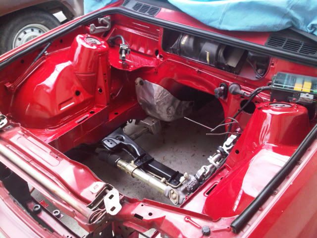

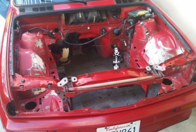

                  #278
                  Originally posted by Simon S
                  this thread is turning into the most-informative, in-depth discussion on proper bay shaving - ever - just at a time when I wanted to learn more about it..
                  Thanks Josh.
                  I <3 r3vlimited
                  Glad to hear it, that's why I do such in-depth build threads when I do stuff like this.
                  So here's the pics after the first Bondo application. I laid down the first coat good and thick like White said, and sanded it down with 100 grit to where you see it now, and everything is almost completely flat and level. I'll do a little bit more sanding tomorrow, then do the next skim coat to fill in any remaining low spots or little holes.
                  Still a few little low spots here and there on this side, mainly where the ridges from spreading were, should be able to fill them in pretty easily.

                        #281
                        Went out and did some more sanding and got it down a bit lower, there's still some little low spots from where applications of filler might have created ridges over other spreadings, so I just put down one more thin skim coat over the 3 areas. Gonna go sand it all back down in about half an hour, spray a guide coat, then sand through that and hopefully put the primer down.
                        Question before I do spray the primer, what's the best way to clean the surfaces before spraying? I've just been wiping everything down very thoroughly with a lightly damp microfiber after sandings.
