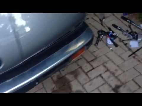

          Here's a video of the idle with the straight pipes.

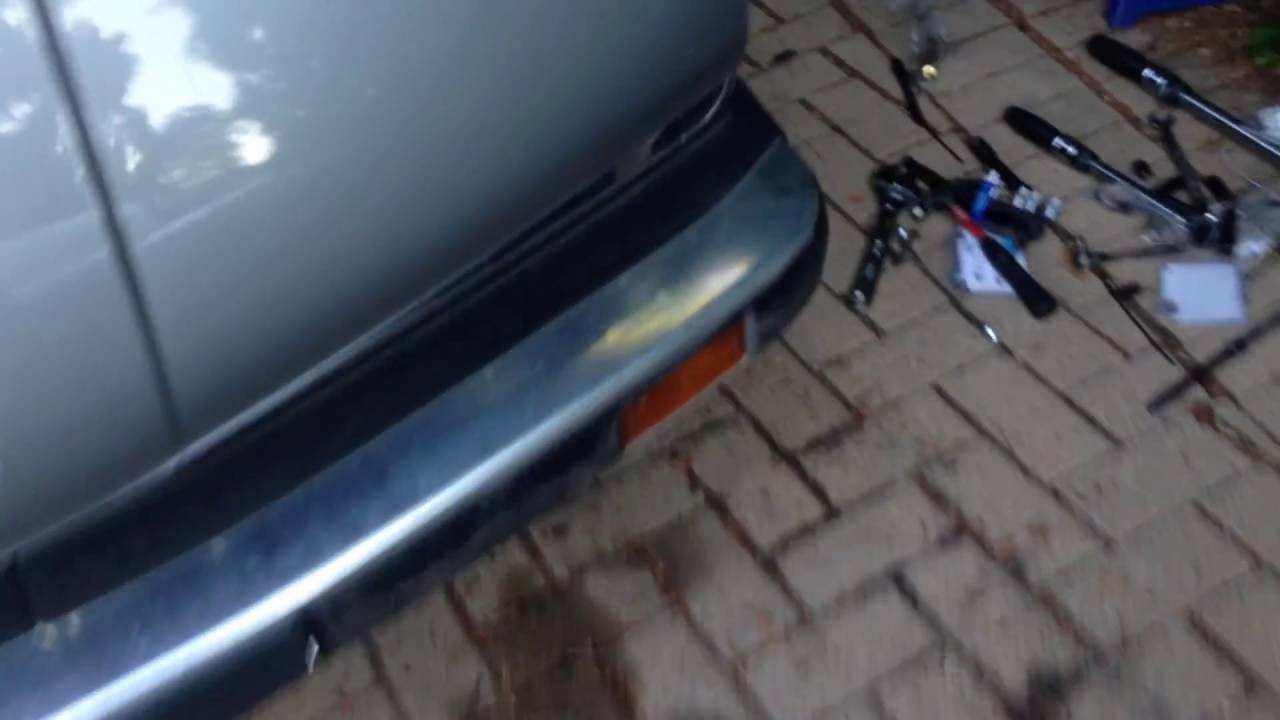

              I got the exhaust welded up today.
              I think I have a leak at the connection though. I didn't use any liquid sealant on the new gaskets, so maybe that will help.
              Here's a video of the drive to the exhaust shop, still running straight exhaust at this point. Video doesn't do the loudness justice. I was taking it easy, breaking in the new clutch!
              Also today, I made the first decent length highway drive since the E30 has been on the road this summer. I definitely need an alignment. I never did get one when the H&R sports went on, and now I've got the E30M3 offset CABs as well. It feels like there is a dead area in the center of the steering right now.
              I fully enjoyed the drive, the car is SO much better with a manual box!
