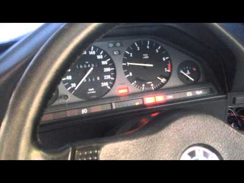

        I really like that volt meter. How did you do it?
        My Garage
        2001 Z3 2.5i Steel Gray/Black (Lexi)
        1988 325ix Diamond Schwartz/Black (Izzy)
        1989 325i Cirrus Blue/Houndstooth (Stitch)
        Feedback
        Instagram: Stone.Hopkins
        • Panici
          • Dec 2009
          • 2532
          #64
          Thanks! Voltmeter is a self-contained 7-segment display I got from dealextreme.com. I then took the defogger switch from my parts car and put the two together. It's not perfect (I cracked the cover) but it's better then nothing!
