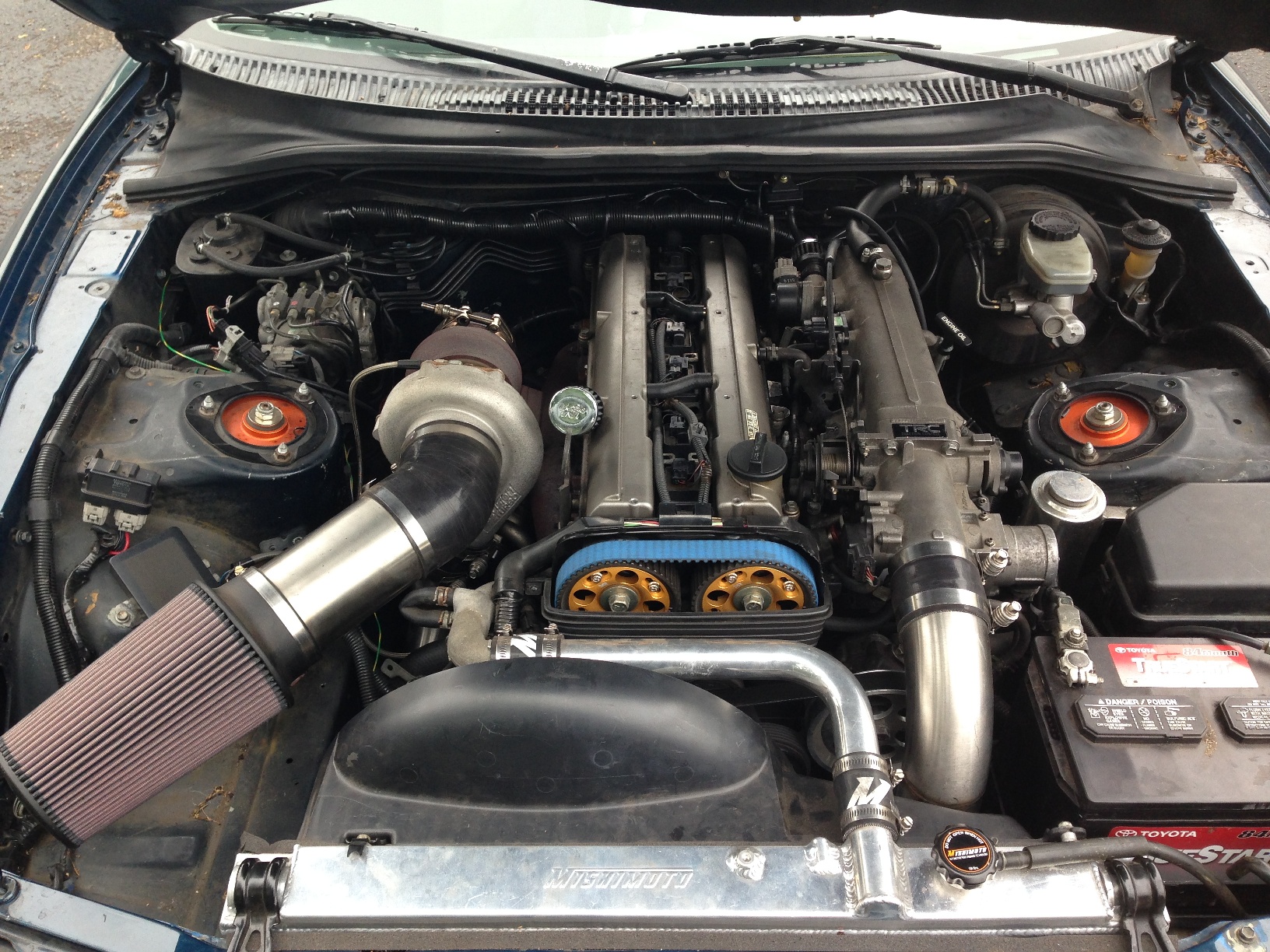

                                As it turns out I couldn't find other m20's with the Precision 5862. But I was able to find this dyno from a supra with a side by side comparison to the Precision 6262. As it turns out the supra engine should compare to what I have in the m20 aside from the 24v aspect of the supra engine.
                                The 3.0 L (2997 cc) 2JZ has been produced since 1991 (first released in the 1991 Toyota Aristo). Cylinder bore was 86 mm (3.39 in) and stroke was 86 mm (3.39 in).
                                KO Basic Single T4 kit for 2jzgte (cast manifold, short 3" downpipe with re-routed wastegate dump and a 46mm v-band wastegate. Dyno comparison of Precision 5862 turbo versus 6266 turbo.
                                Blue line is 5862 and red line is 6266. Boost was controlled only by wastegate spring (18psi spring), but boost level logged for the 5862 was 17.5psi at peak power, and 18.5psi on the 6266. Average boost for the runs was 1-1.5psi higher with the 6266, which would account for most of the difference in power.
                                My engine has an 86 mm bore and stroke of 89.6 mm. For 3122 cc's total. The extra displacement should pick up some of the slack of the 12v 885 head as compared to the 2jzgte. It is interesting to see the 5862 fully spooled by 3500 rpm and continue climbing past 6000 rpm on this supra. The 17 psi probably plays a big part of the power number. Excited to see how this goes once the 5862 arrives! :devil: It's somewhere is Missouri on a truck right about now according to the tracking number
