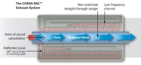

                            Here's what the inside of one of the big cans looks like:
                            And a diagram:
                            I think the whole thing is pretty damn cool and it definitely works

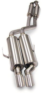

                            Here's what the whole piece looks like:
                            I already butchered it years ago when I welded v bands onto it and then smacked it on a bad bump in the road driving around in my e36 too low for socal roads... so I have no qualms about further cutting it up. I intend to remove the spare tire well, cut reliefs on both sides of the subframe for clearance for the exhaust to split one tube on each side running through/under it, and snake the catback so it kinda makes a mirrored question mark shape "?" a la porsche 911 where both big cans point towards each other right at the bumper and then the exhaust tips do a 90* to exit out the center
