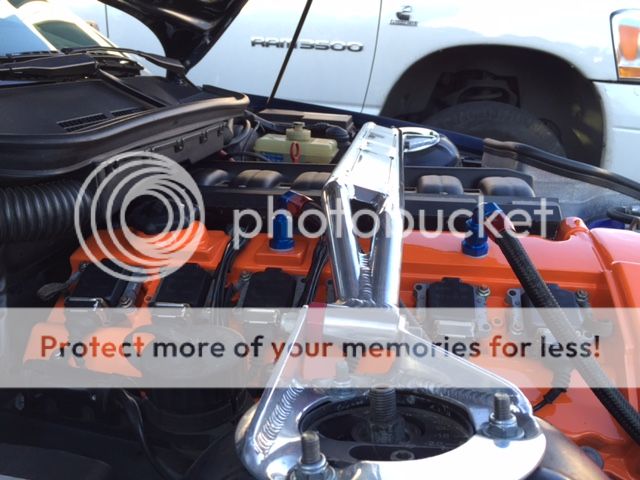

              Venting your crankcase at the oil pan versus the Vanos plug will make "not one single bit of difference". It's one system/atmosphere. Any pressure that forms in the oil pan will be the exact same as that at the Vanos plug. You should make a baffle to go near the Vanos plug inside the Vanos unit though. Otherwise you'll get a lot of oil from when you brake hard and the oil in the head comes charging forward into the timing cover area.
                  Thought so. I pulled the vanos off last night and took a look. Seems possible to do a little baffle.

                  Looking at the vanos area, I think I can make some sort of baffle to cover the opening to the vanos vent pretty easily. There's just enough space to put two studs/bolts through the cover sandwiched on the other side with some nuts/washers and sealant (thinking hondabond or curil-T). They should protrude enough to provide a short stud, but not too much that they interfere with removing the vanos unit. I can make a small aluminum plate that will mount over the studs with a short spacer and secured by a nut (locking nut? or loctite?). Simple and effective :)
                  I marked the potential spots on the inside of the vanos unit with an x
                  Left it like this for the night (put the cover on after). Tonight I should be able to spray the hood and pull cams, lifters, install the ARP studs and do the first torque sequence and start cleaning the lifters.

                    I'm super excited to see/hear how your lifter cleaning goes. I started doing some spares I have. I've done 4 so far. Not particularly difficult, but long and tedious. I'm most interested in what you do to prime them and the outcome on 1st start.
                    Don't worry too much about the baffle interfering with the front of the Vanos (can't let it touch, that's all). You'll need to take the baffle off to be able to access the screws on the exhaust chain sprocket anyways to set everything anytime you take the Vanos off and the baffle being in place will block that access.
                      The stock vent is part of the same system, so with that logic the additional vent on the plug would not make a difference either. The point of venting the oil pan is to remove the oil vapors from the source and reduce windage on the crank shaft. Hence why oems sometimes vent from the oil pan.
                      • Jaker
                        • Oct 2013
                        • 234
                        #896
                        We'll have to agree to disagree. The reason for the extra port (in both Sh3rpak!ng's case and mine) is to provide additional venting for a motor that is being asked to produce a significant amount more power that the OEMs intended the stock crankcase ventilation system to handle. It's working a treat on my motor, and I'm sure it'll work great for Sh3rpak!ng.
                            Yes. I don't know what the inside of the obd1 valve cover looks like leading into the original ccv port, but on the obd2 valve cover, there is a large baffling structure. I don't know how effective or restrictive it is, or how much it might be clogged after ~20 years of use but I don't want to take a chance especially considering I am currently not pulling vacuum on the crankcase.
                            Basically the extra vent certainly can't hurt and will set me up going forward with extra capacity to habdle more power aka more blowby. If anything I probably could've increased the size of the exit tube from the catch can.
                                For my purposes, the plastic cam cover was all the baffling I needed. Spinning the motor to 7,800 in 2nd gear, running extra pump pressure (shimmed oil pump pressure relief) and hard acceleration/braking for autocross meant that my OEM PCV system was pumping a significant amount of oil into the intake tube/boot/TB/IM/engine.
                                I completely blocked off the OEM port on the valve cover. With the install of the 2 -8an lines (I think, cant remember for sure anymore) in their "high" placement, the OEM intake cam plastic cover and the hand made oil separator tank, my intake system is now "bone dry". At 1st I ran it with a simple filter on the top of the can. I was getting blow-by smells in the cabin during day to day driving. Once I put the -12an line from the top of the can to the bottom of the intake tube the smells were gone and their is NO oil being sucked back into the intake.
