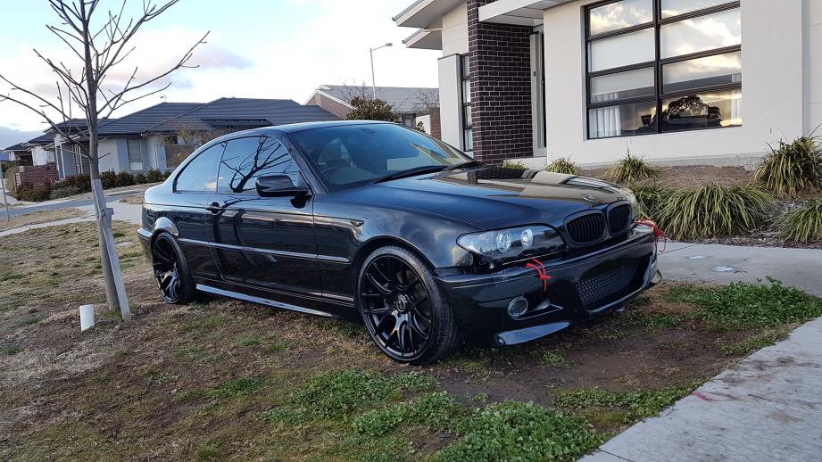

            I then took that profit and made another purchase. Another e46 330i, but this time a coupe....with an added bonus being a turbo kit fitted.
            The PO had a shop fit up a haltech ecu, which following some dyno time (270kw) then fried. After having the car shipped down to me and examining the DME box, im not surprised; they hacked it to pieces and had exposed wires all over the place.
            I've so far wired in a new body side x60004 connector which they had cut off, and received the replacement engine, coil and o2 harnesses in the mail which will now allow me to restore it back to stock DME, and commence tuning that.
            I've already developed a base tune for MS43 with the 60lb injectors and the same slot style MAF i used on the e30 so i should be setup to get it going over the weekend once i replace the harnesses.
            And here it stands in all its "bumper held on with rope" glory!
