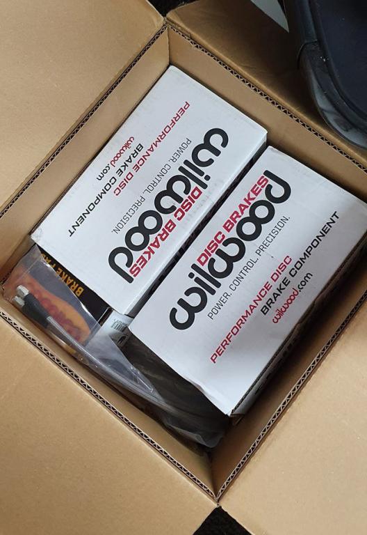

      Box of goodies arrived today:
      Click image for larger version  Name:	237856885_10157837069392391_5939295213729978919_n.jpg Views:	0 Size:	63.3 KB ID:	10028867 Click image for larger version  Name:	235891910_10157837069607391_4262264780156554830_n.jpg Views:	0 Size:	57.2 KB ID:	10028866

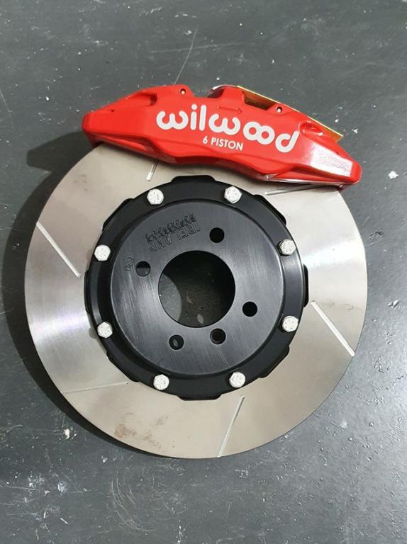

      Bought the IE 310mm front bbk but swapped out the supplied calipers (1.62,1.12,1.12) with 1.38, 1.0, 1.0 piston calipers instead.
      This paired with the z3 36mm piston calipers and e36 325i 280mm rotors in the rear results in a 68% forward bias when used with the e9x 25/22 master cylinder. Its a bit more forward than i would have liked however overall not too bad. I could always remove the bias valve later and see how that feels.

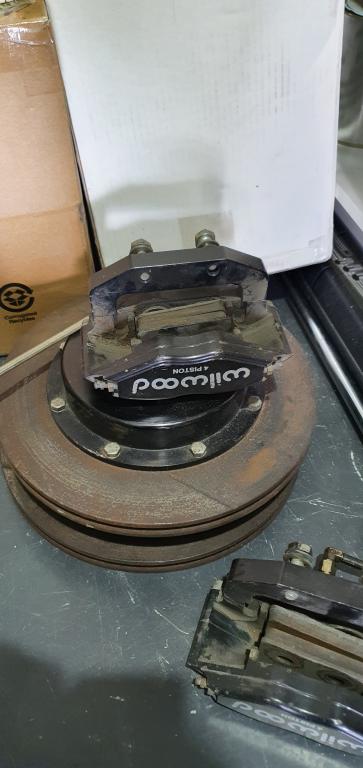

              Rear brakes arrived...in need of a clean.

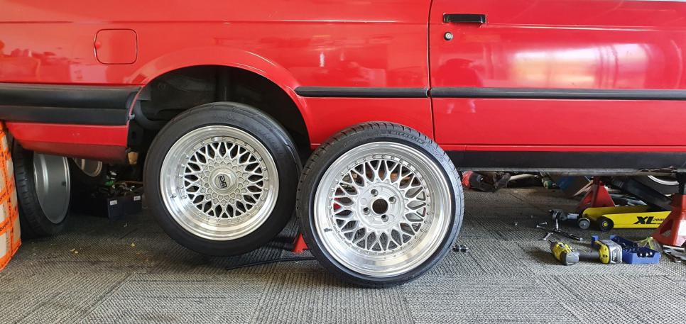

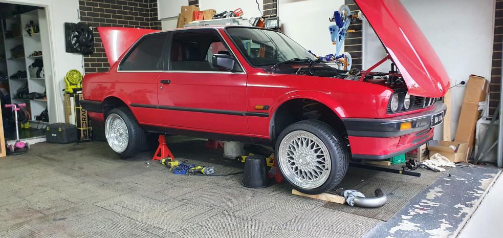

              New vs Old wheels:
ID:	10036398 Click image for larger version

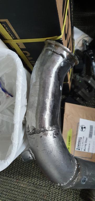

              Bird poo welds getting cleaned up on modified downpipe:

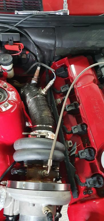

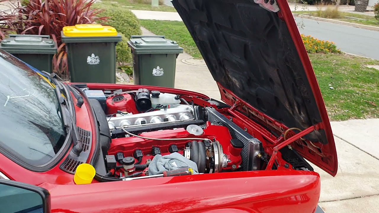

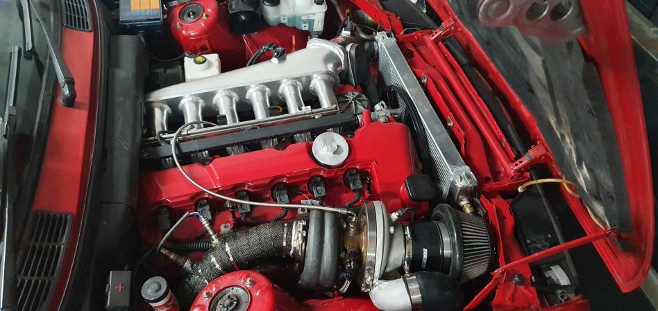

                  Was in a rush to get this thing ready for the BMW Nationals 2022 which was being hosted in my home state so got busy finishing some things off.
                  Finished the downpipe and titanium wrapped it. Then tried welding aluminium for the first time, on the compressor housing. Had to weld a tight 90 degree but seems to have turned out "OK". Thank goodness for angle grinders and flapper discs.

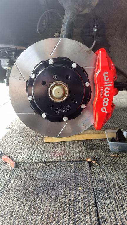

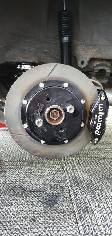

                  After that, it was time to finally fit the new brakes. The rears went on no problems. The front however, im a bit less than impressed with. The install kit is going to make it a more difficult process to change pads in future than it should be. Additionally, the caliper to hub bolt setup comes with 2 washers. Counter intuitively, you have to somehow put one washer between the hub and the caliper adapter otherwise you'll end up with binding. I dont know why IE dont make their adapter with the required spacing already, but its really quite frustrating. Im not the only person that has reported having to shim the setup.
ID:	10049945 Click image for larger version
                  Then finally after getting it all put together on a sunday afternoon, i was finally able to load a base tune on it and take it for a drive - this was short lived as i soon started to experience brake binding. My initial thoughts went to the new/old calipers, however i did also change the booster and master many months ago. So i checked the rod that goes across the firewall on RHD cars. Sure enough, there was a little bit of pre-load on the booster even with the pedal at rest. A quick adjustment to the rod and i was back in business.
                  After about an hour of logging and adjustments to the tune i was at a point where it was "OK" to drive it to the show and shine event at the nationals :)
