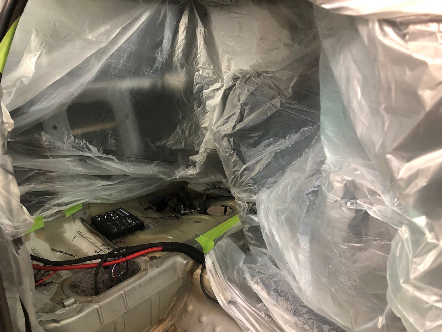

      While the gas tank is out I'm trying to focus on the rear bits that need welding or grinding. Finally making a mount for my audio control device and and yaw sensor.
      I hate mess's

      Since working with 2K primer in a can it has a short shelf life after pop'd So I try and batch everything that needs primed at once. E Brake tubes ready to be welded in!!
      Primed my audio / Yaw mounting
      Weld thru prime where necessary

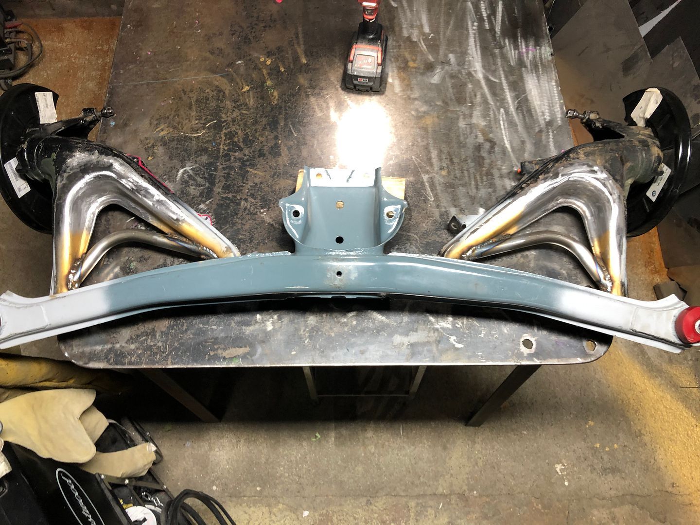

        Trailing arms are 95% Complete. - Waiting on IE rear swaybar. Call #3 today to make sure it shipped!

        Finish dual sheer trailing arm mount
        Powder coat trailing arms
        Assemble rear end - Stim tech RTAB - Bearing, Fag wheel bearing, New Febi Hubs, MSI studs, All new Ebrake bits, Reuse AKG 75D Subframe mounts

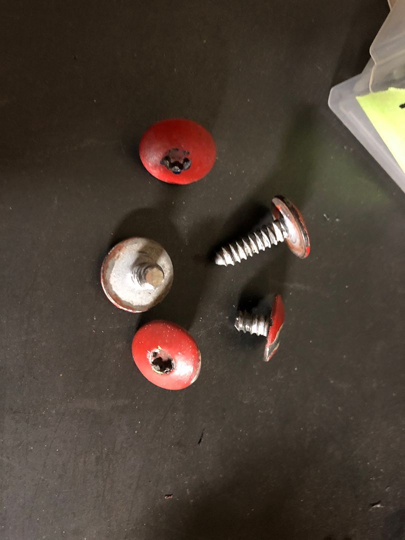

        Here is why I think the stud breaks.
        1987 Original Equipped

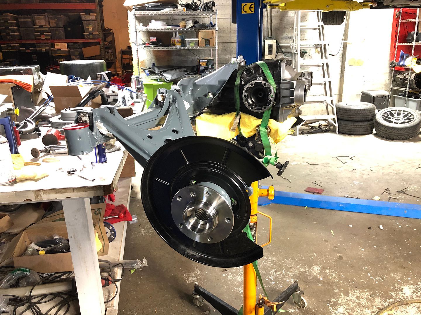

                While things were at the coaters I was able to catch up on the front end. I did go with the Dorman E30M control arms. I fell confident, and they will be replaced with something else I assume before the have enough service to Time Out. They look like quality forged units with the same amount of articulation as the Genuine 96+ units I comaired them too.
                New Bearings, I hate adding weight... I wonder if new Genuine ones look like originals. I do know these need machined down if I ever use PFC rotors..

                    We did begin building some Rtabs.. with bearings.. But time pushed that project aside. Stim tech came out with a setup, always good to support products like this in hopes that they grow... And hopes that they'll work for a while!
                    All the alignment adjuster were marked before disassembly and put back into their locations. These will be harder to adj with the Posi-Lock since they are "Floating" and not held to an "Axis" with an eccentric... But I hope once they are set and with the additional rigidity, not much adjustments should be needed.
                    Coming together. With more precise rigid components it really puts into perspective of the attention of fitment. WOW looking good!
                    Longer grade 9 1/2 bolts trimmed down to get more "shoulder" length. the threads end about 1/8 to the nut, hope to rule out flex or sheer points.
