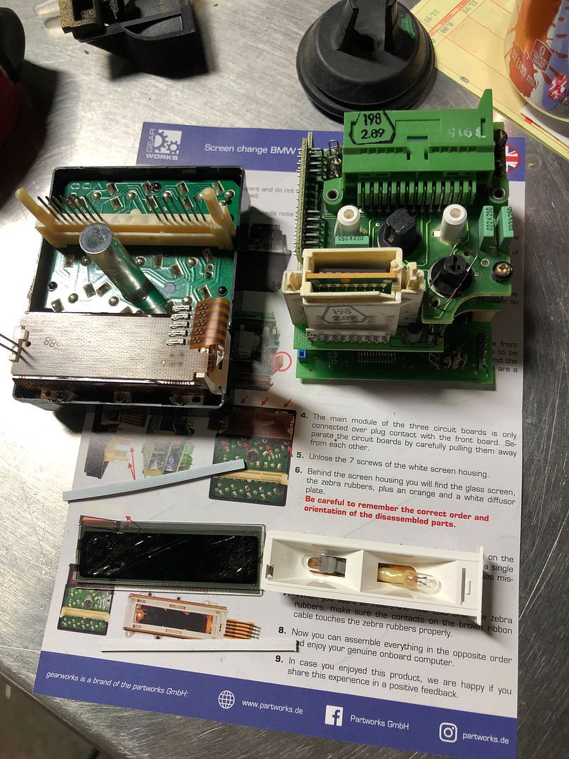

                Took a few tries, but its working! My old OBC screen was shot. The 13 button OBC screen was from gearworks from Germany. I don't have all the OBC functions, but one day insanely would like to.

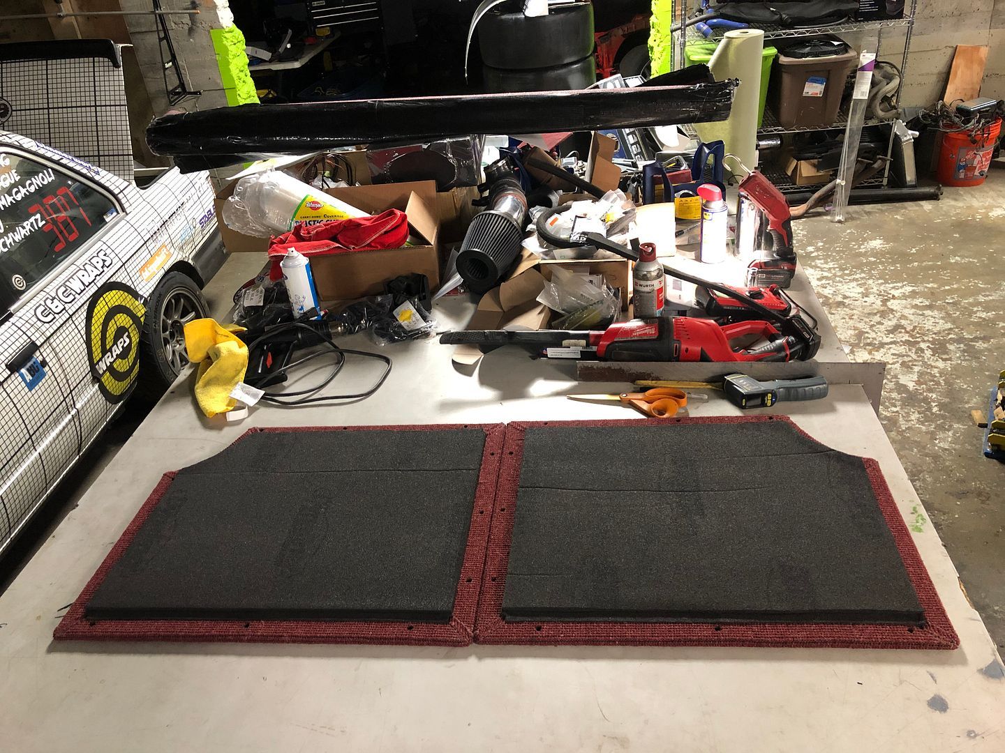

                            Thanks! I could... But it would be like something around 100 labor hours and materials! Its pretty intricate as it has a mounting frame welded into the chassis and gaps are next to none.
                            Originally posted by Sh3rpak!ng
                            Nice work on the whole interior!!! That looks so good. Love it. Your rear seat delete is on another level hahaha I kinda want to redo mine with aluminum or CF or ABS...
                            Thanks! I used 6mm alumilite, Pretty much thin aluminum sheet sandwiching corrugated plastic. I chose this route for its Strength, Weight, and acoustics properties. If this was a race car id just what Rules aloud for bulkhead material.
                            It worked out quite well with the carpet and the dynaliner. Panels are pretty light and deaden sound quite well. Goal is not to hear and sort of diff whine and keep road noise down from the back, Esp with the 75D AKG bushings. I also have a sub going though the rear panel, Definably don't want to vibrations.
