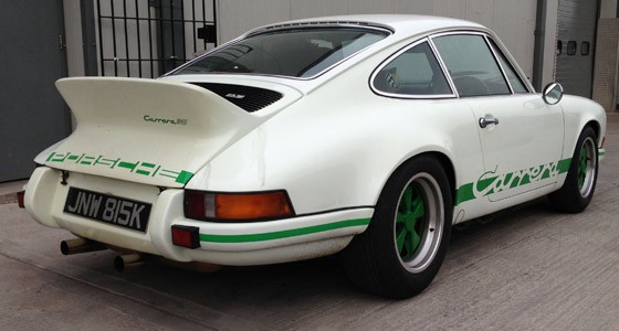

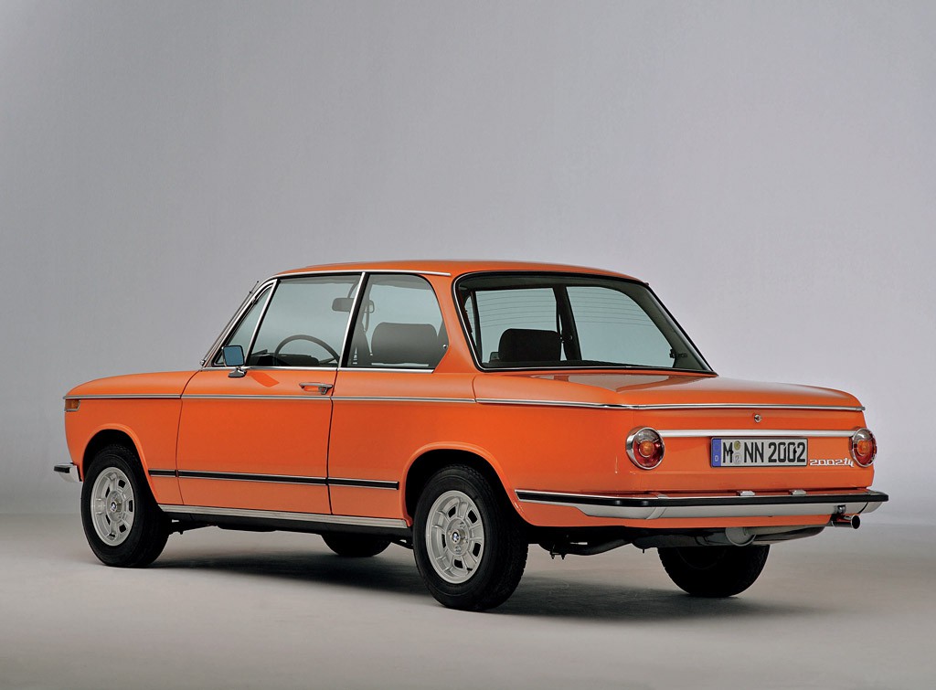

    Originally posted by jeenyus
    wowza, bosozoku style exhaust? welding looks great!
    HAHA, The exhaust Isnt big, The bumper are big.. It is about 8mm past the bumper, I pan to keep the diving boards with no shame. Hopefully it'll help quiet down cabin noise and not burn up the bumper...
    Inspiration
    Click image for larger version  Name:	Screen-Shot-2019-06-04-at-8.54.03-AM.png Views:	0 Size:	126.0 KB ID:	9895217
    Click image for larger version  Name:	1973_BMW_2002tii3.jpg Views:	0 Size:	105.0 KB ID:	9895218
    Click image for larger version  Name:	porsche-home.jpg Views:	0 Size:	42.5 KB ID:	9895219
    NOT
    https://www.google.com/search?q=bozu...w=1745&bih=807
